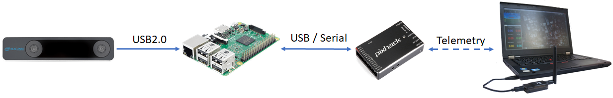

  • Physical connection:
  • Data flow: The green boxes are ROS nodes.

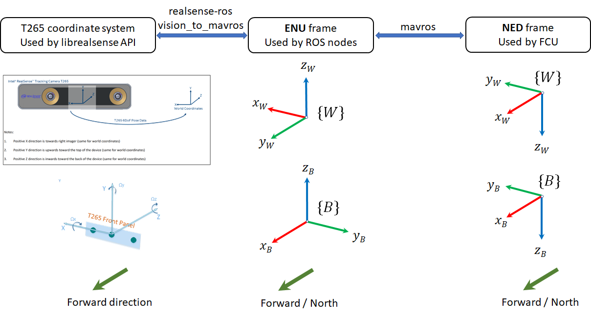

  • Reference frames: The body {B} and world {W} frames used by librealsense, ROS and ArduPilot are all different. realsense-ros provides position feedback in ENU frame, however different camera orientations and frame alignments need to be taken into account before sending pose data to mavros, which are done by vision_to_mavros. More on this in the next part.
From left to right: T265 frame, ENU frame (ROS side), NED frame (FCU side). Whatever orientation of the T265 is, we need the feedback to be in ENU before sending to mavros.
  • vision_to_mavros package: this package has 3 main functions:
    • Convert ROS topics between realsense-ros and mavros: /tf is the the transformation data which lets the user keep track of multiple coordinate frames over time. Many localization packages provide this type of data out-of-the-box. /tf will be converted to /mavros/vision_position/pose, which is now supported by ArduPilot.
    • Limit rate of pose data: 200Hz data stream seems to fast for the FCU to handle. We also don’t need the full stack of 200Hz of data. 10-15Hz localization data is the bare minimum threshold that is required for testing, and 30Hz should be more than enough for most cases (relative to how fast the vehicle is moving). You can change the rate data with output_rate param.
    • Frames alignment: The position feedback from realsense-ros is already in ROS convention (ENU). However, by default the T265 body’s X-axis will be aligned with world’s X-axis initially, which means the FCU will interpret heading as facing “East”, or yaw will be off by 90 degrees (left image, below). This package will rotate the body frame by 90 degree around world’s Z-axis, which would conform to ROS’ ENU convention (right image, below).

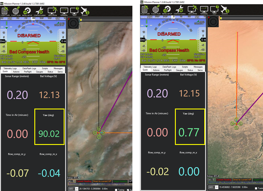

Important note for down-facing configurations: there is an ongoing issue about inconsistent yaw angle when T265 is facing down and some workarounds have been discussed. As of this writing, here is what seems to work: the camera needs to be slightly tilted (i.e. not completely flat out) when it starts streaming poses (launching realsense-ros or calling librealsense’ API to invoke pose data), otherwise the yaw angle of the world coordinates might be randomly initialized, as shown below:
Left: T265 facing down, completely flat at launch - inconsistent yaw angle between runs
Right: T265 facing down, slightly tilted at launch - consistent yaw angle.

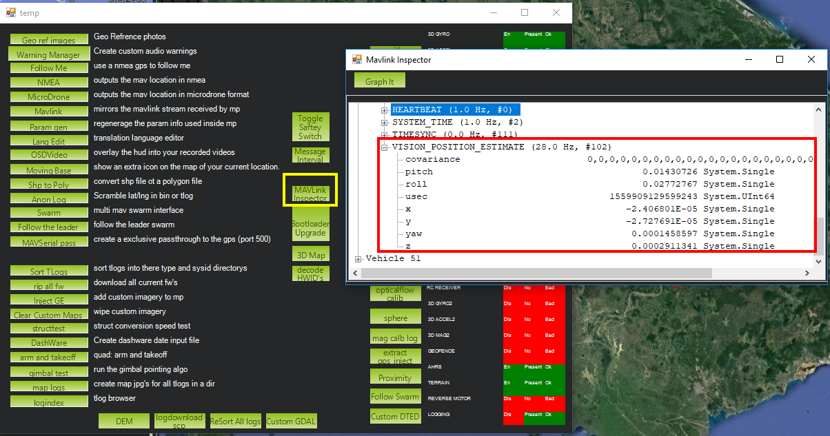

Verify that ArduPilot is receiving data from MAVROS
Check that ArduPilot is receiving position data by viewing the topic VISION_POSITION_ESTIMATE on GCS. For Mission Planner, press Ctrl+F and click on “Mavlink Inspector”, you should be able to see data coming in.
Note on viewing VISION_POSITION_ESTIMATE topic on QGC: check this thread if you have some problems with receiving this topic on QGC.
