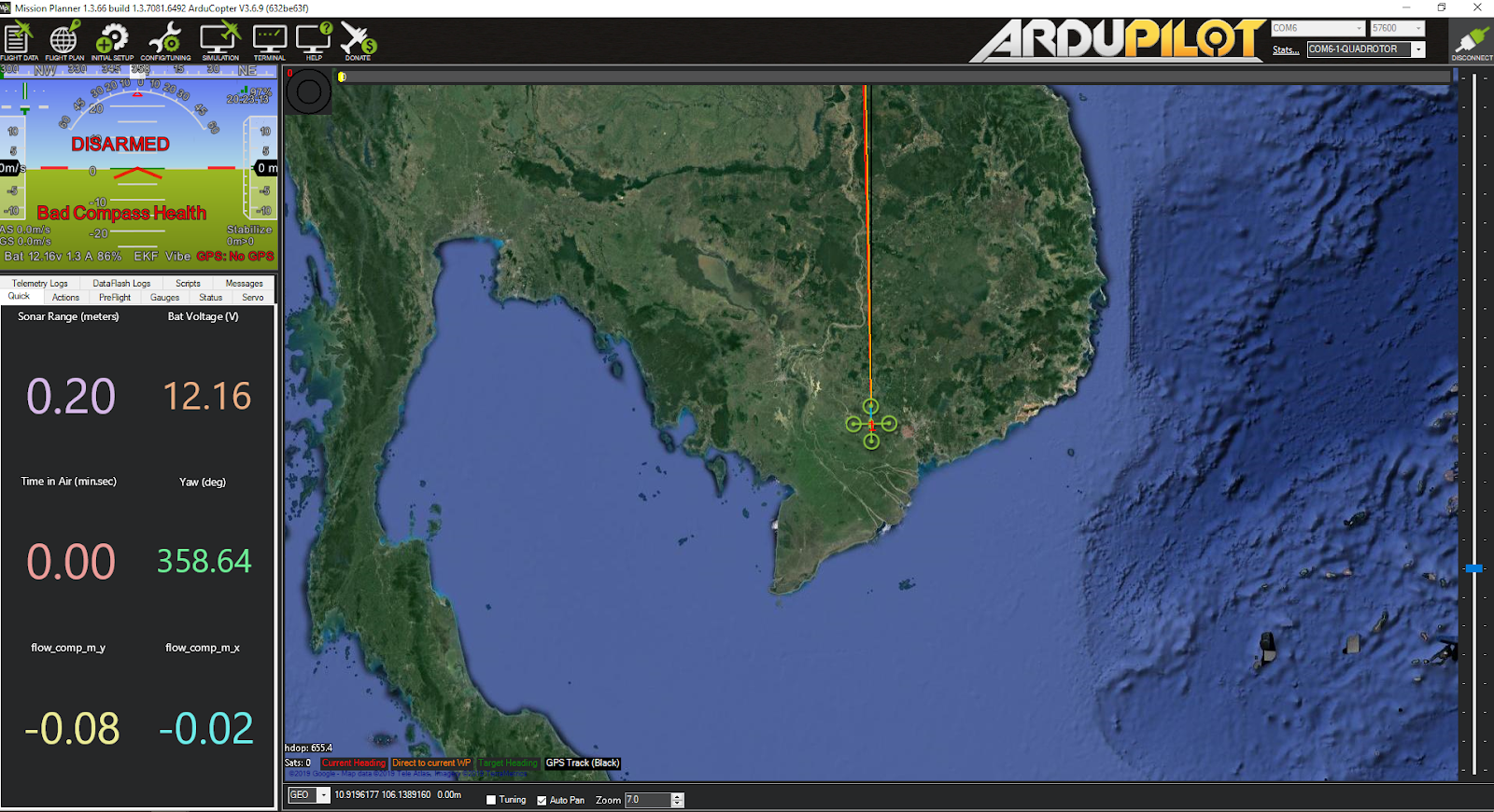

a) Mission Planner - Sending waypoints in Guided mode
  • Make sure position data feedback from T265 is ready, EKF home set, and you have a good sense of the safety boundary.
  • Manual flight test: take off in alt-hold or loiter. Make sure that the vehicle can hover stably.
  • In the Mission Planner map, right-click on a nearby spot and select “Fly to Here”. Select a safe altitude for guided mode so that you do not hit the ceiling.
  • The vehicle should fly to the target location and hover there until further commands or the flight mode changes.
  • Next flights, you can try and issue a take off command from Mission Planner directly.

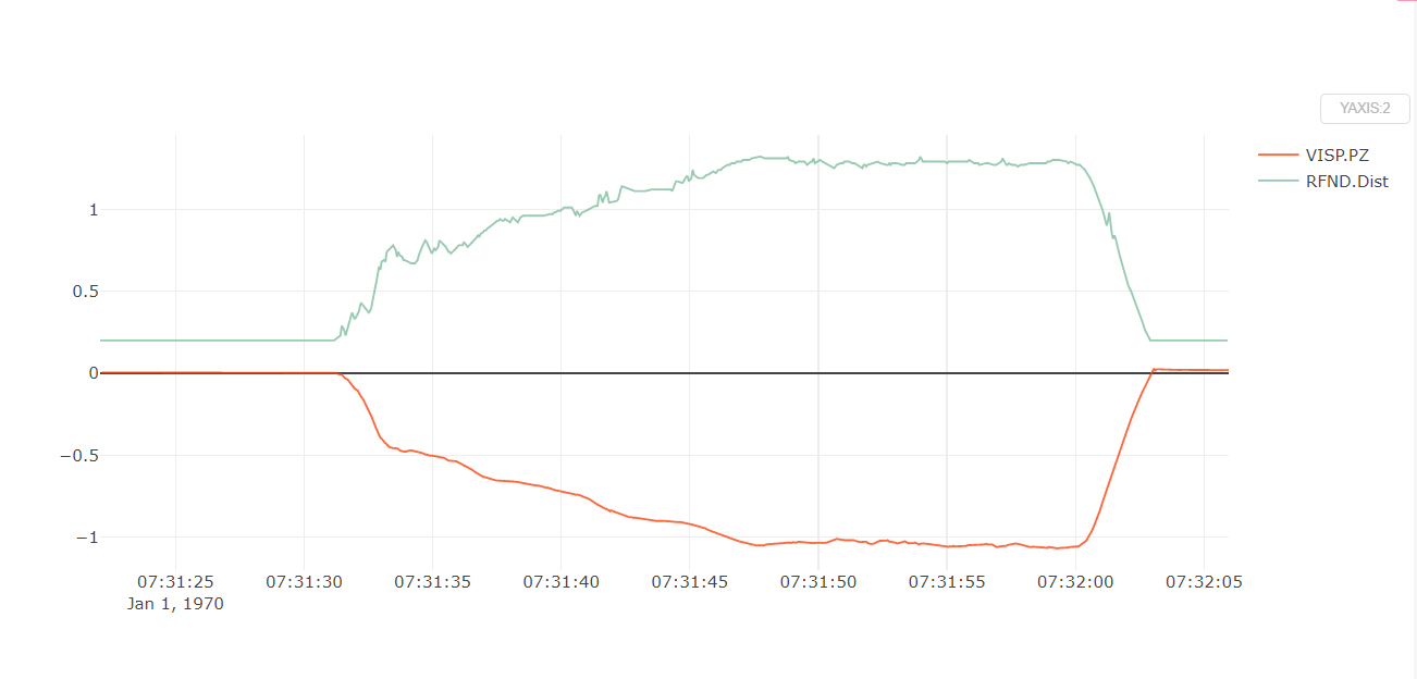

One of the key aspects of my 2019 GSoC project is to analyze the performance of the T265 under various conditions. First, let’s see the results of a good flight:

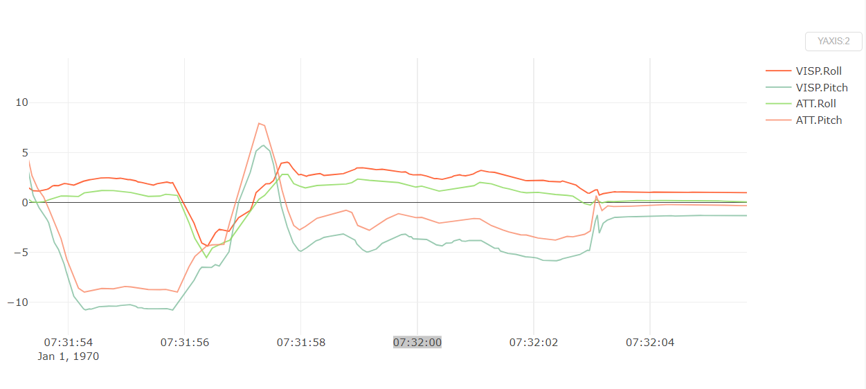

  • Frame induced with heavy vibration:
My quadcopter frame did not have much vibration (luckily). To test this, vibration was intentionally added into the system by changing one motor to a different KV than the others, and wrapping duct tapes to the tips of one propeller. Even then, there were no problems with for most of the tests.
However, as can be seen in the video below, position tracking did diverge in some cases, suggesting that with “appropriate” kind of vibrations, problems can occur. The EKF2 was fusing both vision feedback and optical flow. At the end of the video, when position feedback “jumped” back to the right position, the local position did not jump and remained approximately where it was.

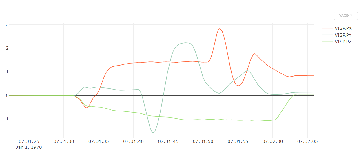

  • Environment with a lack of distinctive features and repetitive patterns:
To simulate this scenario, the T265 is positioned facing downward. In this case, the scale of the T265 is often not as accurate as facing forward (i.e. 1m lateral movement translates to 1.2 or 0.8 difference in position feedback). Even though optical flow was also fused, local position shown on Mission Planner was similar to that of T265 feedback. Occasionally, the position also drifted after some rounds of movement.
It is safe to say that as of this writing, care should be taken when using the T265 in a downfacing configuration, specifically in terms of scale, initial yaw angle, and drift:

About the 20cm delta with Rangefinder, isn’t that the offset of the ground distance offset for the rangefinder ?
Thank you @khancyr for your comment!
Indeed the 20cm is the offset from ground distance for the rangefinder. The Realsense T265, on the other hand, uses the starting point as the origin.
@rmackay9 that was in fact a copy-paste error in my original post. Thanks for the edit!
