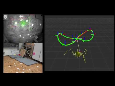

Robust Visual Inertial Odometry (ROVIO) is a state estimator based on an extended Kalman Filter(EKF), which proposed several novelties. In addition to FAST corner features, whose 3D positions are parameterized with robotcentric bearing vectors and distances, multi-level patches are extracted from the image stream around these features. The patch features are tracked, warped based on IMU-predicted motion, and the photometric errors are used in the update step as innovation terms. ROVIO was developed as a monocular VIO pipeline, is available as an open-source software package.

The picture above is pretty self explanatory as we can simulate relative displacement by moving the camera. I am using the QGC widgets - ANALYZE to check the signal quality, gain and stability.
