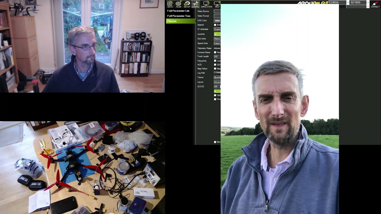

8. VTX and Yaapu configuration
Configuring VTX power and Yaapu telemetry passthrough
Setup VTX to be controlled by flight controller (RX)
VTX_ENABLE=1   # VTX control
RC11_OPTION=94 # VTX power
RC_OPTIONS=288 # Yaapu passthrough

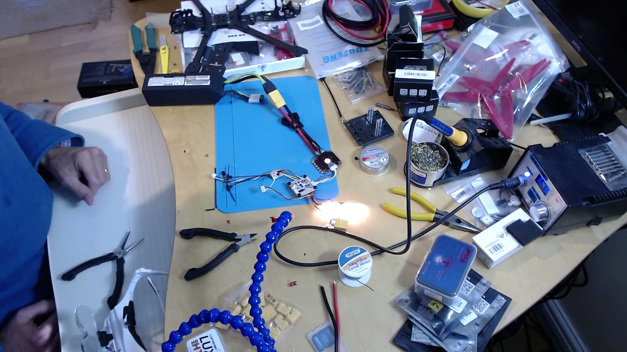

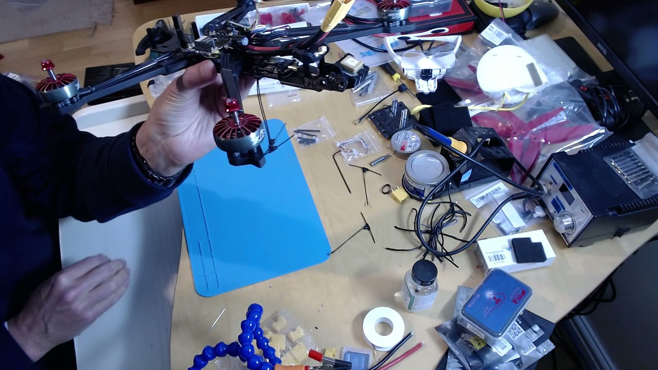

11. Motor dry mount
ESC pigtail soldering. 6S power test. Fixing motors temporarily to enable soldering.
12. Motor soldering and motor test
Soldering the motors to the ESCs and then testing the motors

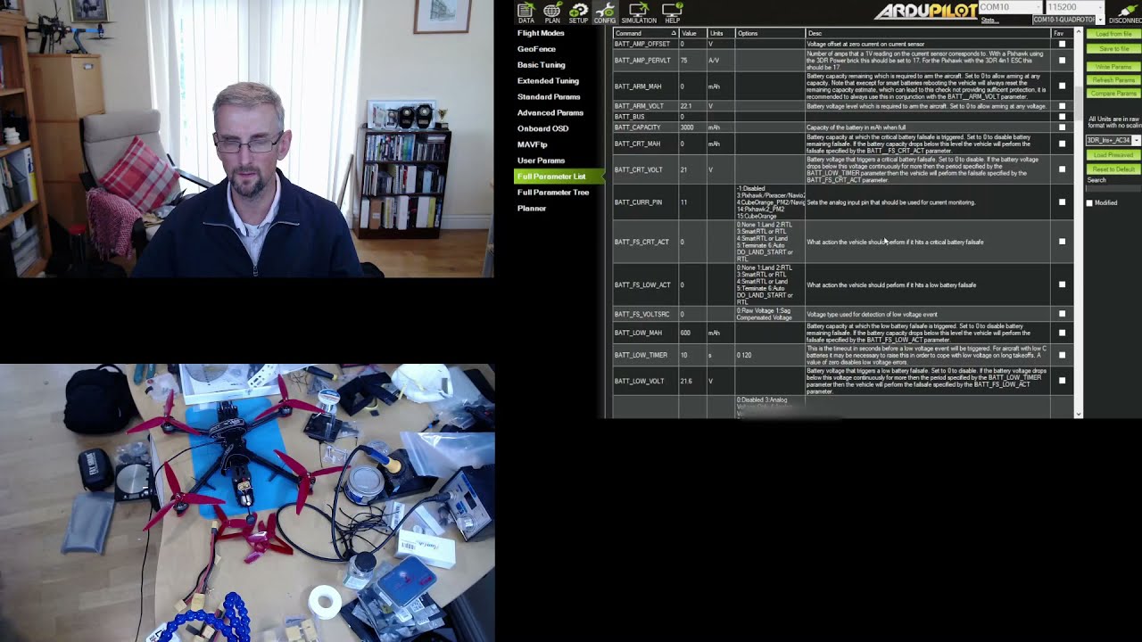

16. Initial tune and notch configuration
Initial tune setup using Mission Planner setup wizard (Alt-A). Checking INS_GYRO_FILTER and ATC_RAT_RLL/PIT_FLTD. Check initial PIDs and enable the harmonic notch filter using ESC telemetry. INS_HNTCH_ENABLE set and INS_HNTCH_MODE to ESC telemetry. Make sure harmonic notch ratio of INS_HNTCH_FREQ amd INS_HNTCH_BW is correct. Set INS_HNTCH_REF. Setup INS_HNTCH_OPTS to track individual motors and loop rate. Increase SCHED_LOOP_RATE. Set SERVO_DSHOT_RATE to multiple of loop rate.
BATT_ARM_VOLT=22.1    # 6S setup
BATT_CRT_VOLT=21      # 6S setup
BATT_LOW_VOLT=21.6    # 6S setup
MOT_BAT_VOLT_MAX=25.2 # 6S setup
MOT_BAT_VOLT_MIN=19.8 # 6S setup
MOT_THST_EXPO=0.6     # expo for 7" props
INST_GYRO_FILTER=70   # gyro filter for 7" copter
ATC_RAT_RLL_FLTD=35   # d-term filter for 7" copter
ATC_RAT_PIT_FLTD=35   # d-term filter for 7" copter
INS_FAST_SAMPLE=3     # fast sampling on both IMUs
INS_HNTCH_ENABLE=1    # harmonic notch on
INS_HNTCH_FREQ=60     # lowest harmonic notch frequency
INS_HNTCH_BW=30       # bandwidth half of notch frequency
INS_HNTCH_MODE=3      # ESC notch updates
INS_HNTCH_REF=1       # required for ESC updates
INS_HNTCH_OPTS=6      # notch updates at loop rate and notch-per-motor
SCHED_LOOP_RATE=800   # gives finer control
SERVO_DSHOT_RATE=2    # dshot output at 1.6Khz

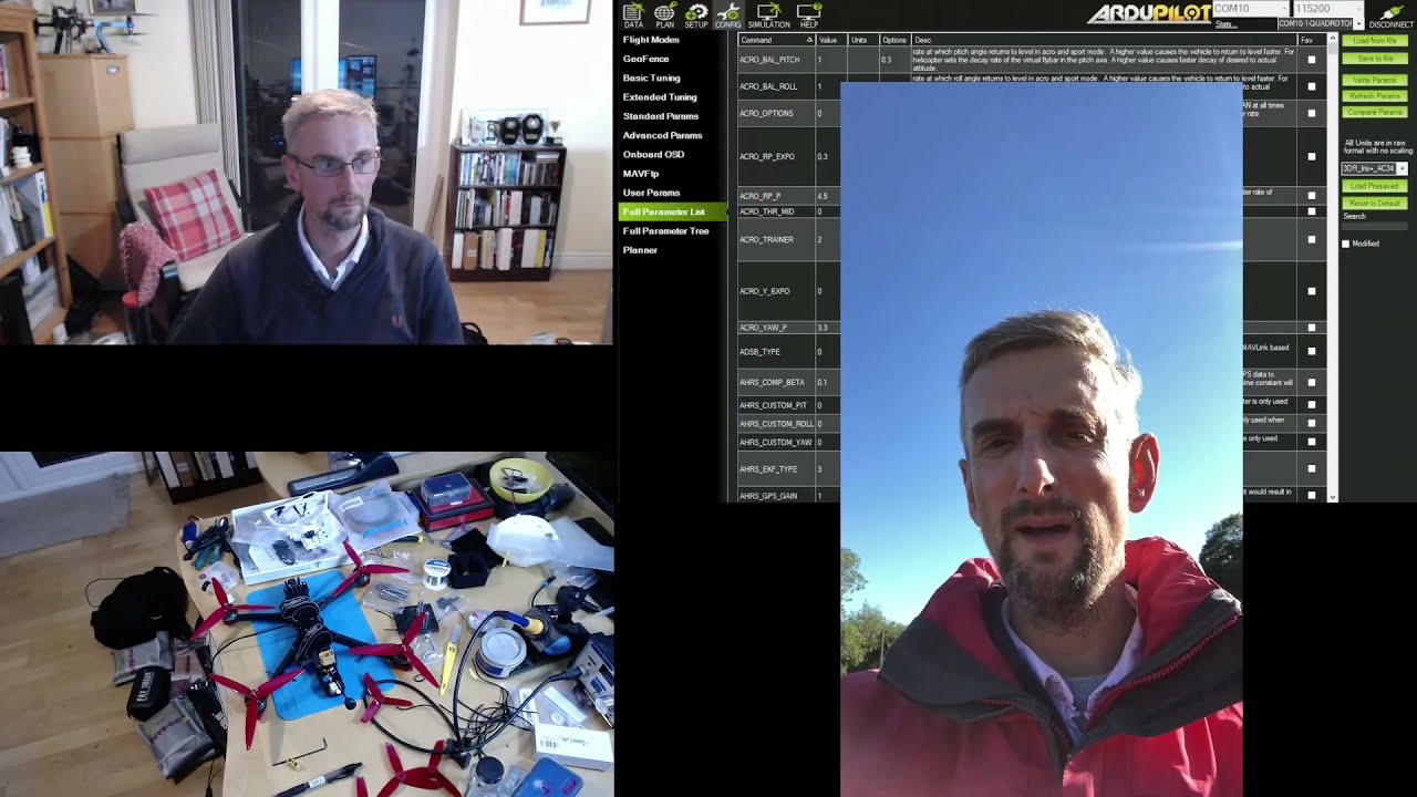

19. First flight - Stabilize, AltHold, PosHold and Autotune
First flight. Determined suitable hover thrust value (MOT_THST_HOVER) from log. Enabled autotune on RC8. Reduced AUTOTUNE_MIN_D. Set battery capacity. Set low battery capacity to 20% of full charge. Turned off battery failsafe. Cycled through stabilize/althold/poshold in flight. Autotuned roll/pitch first followed by yaw using AUTOTUNE_AXES. Post-tune increased filter values and set better althold parameters. Ran autotune again on all axes.
RC8_OPTION=17         # autotune on channel 8
AUTOTUNE_AXES=3       # only tune roll and pitch
AUTOTUNE_MIN_D=0.0003 # lowest d-term
BATT_CAPACITY=3000    # battery capacity
BATT_LOW_MAH=600      # battery failsafe low capacity at 20%
BATT_FS_CRT_ACT=0     # don't do anything on failsafe
BATT_FS_LOW_ACT=0     # don't do anything on failsafe
MOT_THST_HOVER=0.14   # hover thrust
INS_ACCEL_FILTER=10   # IMU accelerometer filter
PSC_ACCZ_P=0.14       # vertical P gain at hover thrust
PSC_ACCZ_I=0.28       # vertical I gain at double hover thrust

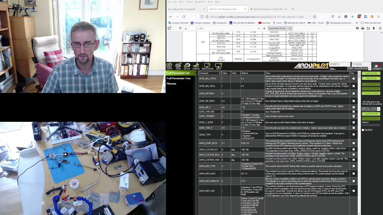

21. FPV and Acro tuning
Setup for Acro:
  • Airmode on via ACRO_OPTIONS = 1
  • Increase roll and yaw rates via ACRO_RP_P = 10 and ACRO_YAW_P = 10
  • Increase rate at stick edges via ACRO_RP_EXPO = 0.4
  • Enable flips and rolls via ACRO_TRAINER = 0
Setup for OSD:
  • Enable parameter configuration screens via OSD5_ENABLE = 1 and OSD6_ENABLE = 1
  • Enable switch between three screens on 3-pos switch by setting OSD_CHAN = channel, OSD_SW_METHOD = 1 (PWM), OSDn_CHAN_MIN and OSDn_CHAN_MAX
  • Enable RSSI display via RSSI_TYPE = 3
Flew in acro and it flew pretty well
Did some log analysis on the quality of the tune by looking at compass interference, RATE outputs and friends. Concluded that I needed another external compass mounted away from the battery pigtails
ACRO_OPTIONS=1     # enable airmode in acro
ACRO_RP_EXPO=0.4   # faster rotation at stick edges
ACRO_RP_P=10       # 450 degrees/s on roll and pitch
ACRO_YAW_P=10      # 450 degrees/s on yaw
ACRO_TRAINER = 0   # allow copter to fully roll past 45 degrees lean
ATC_INPUT_TC=0.08  # super crisp feel on pilot input
OSD5_ENABLE=1      # enable first OSD parameter screen
OSD6_ENABLE=1      # enable second OSD parameter screen
OSD_CHAN=7         # RC7 to switch OSD screens
OSD_SW_METHOD=1    # switch OSD screen on PWM values
OSD1_CHAN_MIN=900  # OSD1 around PWM 1000
OSD1_CHAN_MAX=1100
OSD5_CHAN_MIN=1400 # OSD5 around PWM 1500
OSD5_CHAN_MAX=1600
OSD6_CHAN_MIN=1900 # OSD6 around PWM 2000
OSD6_CHAN_MAX=2100
RSSI_TYPE = 3      # RSSI from radio receiver

24. Getting The Perfect Tune
A long one this, but hopefully worth it!
Getting a perfect tune requires two things:
  • Successive autotunes at different filter settings to determine optimal filter for roll and pitch
  • Manual tune of yaw D
  • Try different values of INS_GYRO_FILT, ATC_RAT_RLL_FLTD and ATC_RAT_PIT_FLTD, e.g. 40/20, 60/30, 80/40, 100/50, 120/60, 150/75
  • Want highest filter setting that does not introduce significant noise and lowest filter setting that does not affect control.
  • Control can be determined by looking at ATC_RAT_RLL_P/ATC_RAT_PIT_P values from autotune - higher is better. Once noise is dominating higher filter settings will not increase _P
  • Noise can be determined by looking at RATE.POut/RATE.ROut in logs, needs to be below 0.1
Final autotune
  • On the Chimera7 150/75 was found to be the best balance of noise and latency/control
  • Final autotune at 0.075 AUTOTUNE_AGGR to produce very stable PIDs with high control
INS_GYRO_FILT=150   # Gyro low pass filter
ATC_RAT_RLL_FLTD=75 # Roll D-term filter
ATC_RAT_PIT_FLTD=75 # Pitch D-term filter
AUTOTUNE_AGGR=0.075 # Auotune aggressiveness
Yaw manual tune
  • autotune does not touch ATC_RAT_YAW_D, it has to be tuned manually
  • Set ATC_RAT_YAW_FLTD to optimal value from final autotune for roll/pitch
  • Try values for ATC_RAT_YAW_D from 0.0001 in steps of 1000% until oscillation observed - so 0.0001, 0.001, 0.01, 0.1
  • At oscillation reduce in steps of 10% until no oscillation - 0.1, 0.09, 0.08, 0.07, 0.06, 0.05, 0.04, 0.03 and then reduce another 25% - 0.02
  • Tune ATC_RAT_YAW_FLTD by changing and repeating manual process
  • On the Chimera7 ATC_RAT_YAW_FLTD = 60 / ATC_RAT_YAW_D = 0.02 was found to give best balance
ATC_RAT_YAW_FLTD=60 # Yaw D-term filter
ATC_RAT_YAW_D=0.02  # Yaw D
Yaw maximum acceleration
  • Remove acceleration constraints - ACRO_YAW_P = 15 or ACRO_YAW_RATE = 600 and ATC_ACCEL_Y_MAX = 0
  • Do a fast yaw maneuver
  • In the log measure the observed RATE.Y acceleration. Calculate acceleration from MAX(RATE.Y) - MIN(RATE.Y) / T. Multiply by 100 to get centidegrees/s/s and set ATC_ACCEL_Y_MAX to this value
  • For the Chimera7 this resulted in ATC_ACCEL_Y_MAX = 72000
 ATC_ACCEL_Y_MAX=72000 # Maximum Yaw acceleration
The final tune parameters are attached at the top of this post. A couple of extra goodies:
ATC_RAT_YAW_FF=0.0043 # Feed forward for yaw. Don't ask me how to calculate this
ACRO_Y_EXPO=0.6       # higher yaw expo
ACRO_RP_EXPO=0.6      # higher roll/pitch expo
