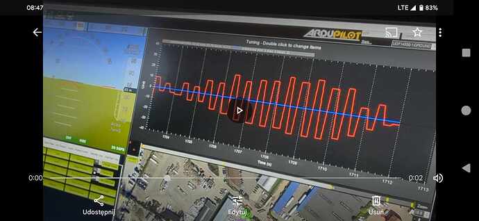

More:
on pid chart where piddesired plot is constant the pidachived is wobbling alot ( but why?- this is the question)
I guess it could be problem witch EKF3 or some kind of filter or noise settings ?

PID achieved in this context is the measured speed or turnrate for rover. It’s not a calculated value.
In your logs, the speed PID’s show the measured speed fluctuating ±0.03m/s (so ± 3cm/sec). This is simply the noise or uncertainty in the speed measurement, based on your sensor hardware and settings.
Likewise for steering, the PID’s show the measured turnrate fluctuating ±0.1deg/s. Again, this is just the noise or uncertainty in the turnrate measurement, based on your sensor hardware and settings.
