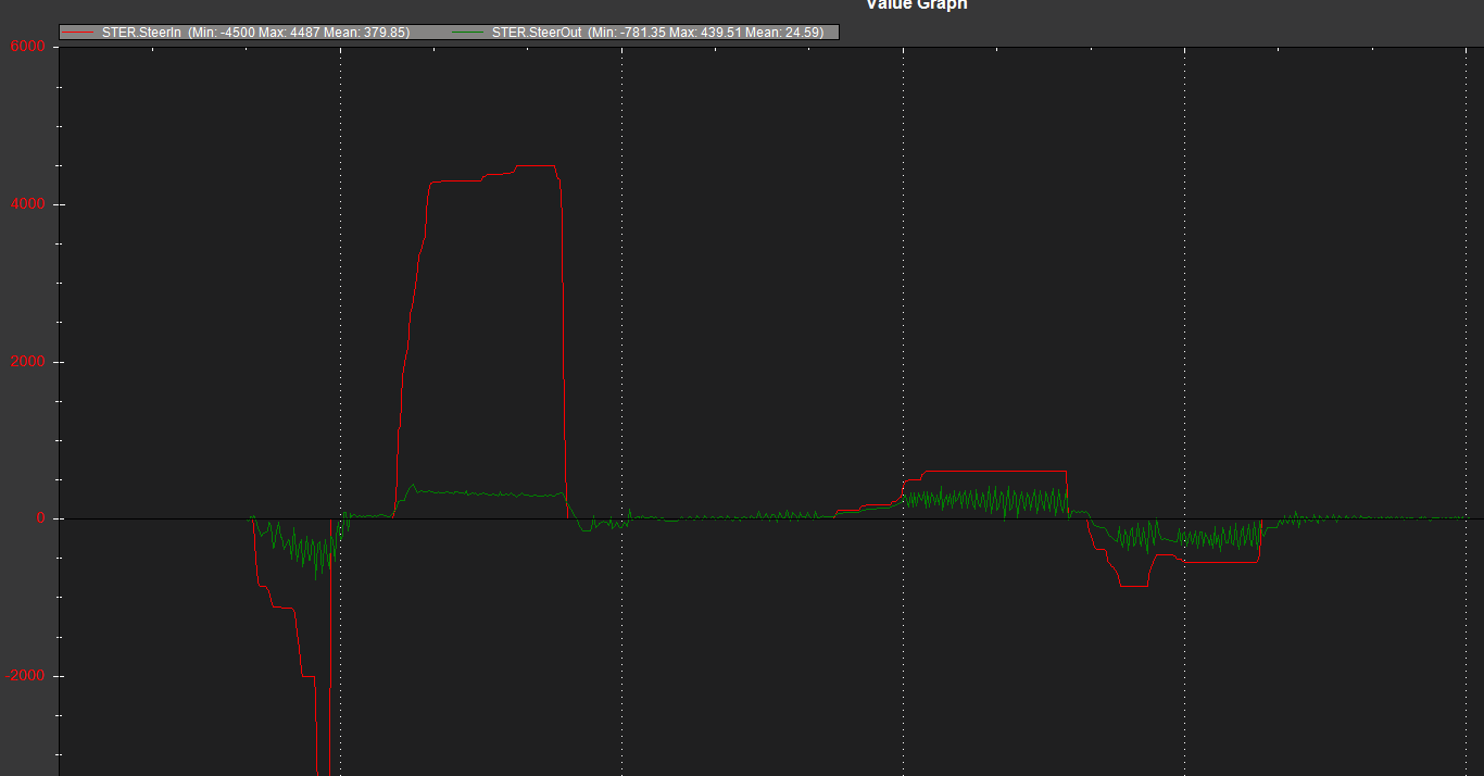

After a few attempts at the PID tuning process and searching through many topics on the ArduForum, I am still struggling with my rover.
As you can see, the rover runs straight and stays on course during the mission. However, I am having issues with slow and precise movements. My PID control graph fluctuates a lot when I try to move forward or turn at very slow speeds, which is necessary to reach points estimated via RTK GPS FIX.

That is the steering tab. Maybe we have poor steering tuning, and that is why we are struggling with slow movement and shaking?

So the Quiktune is showing the error message “RTUN: Increase steering”. So you need to configure the vehicle to move (turn) faster in the circle. This can be done via increasing the circle speed or decreasing the circle radius.
What you actually want to graph is STER.TurnRate and STER.DesTurnRate. Unfortunately, the items you graphed have different units (Onboard Message Log Messages — Rover documentation) and won’t show correctly.
I would suggest trying:
  • Reducing ATC_STR_RAT_D = 0
  • Reducing ATC_STR_RAT_P = 0.1 (or maybe 0.05 if there’s still shaking)
  • Increasing ATC_STR_RAT_FF = 0.6
