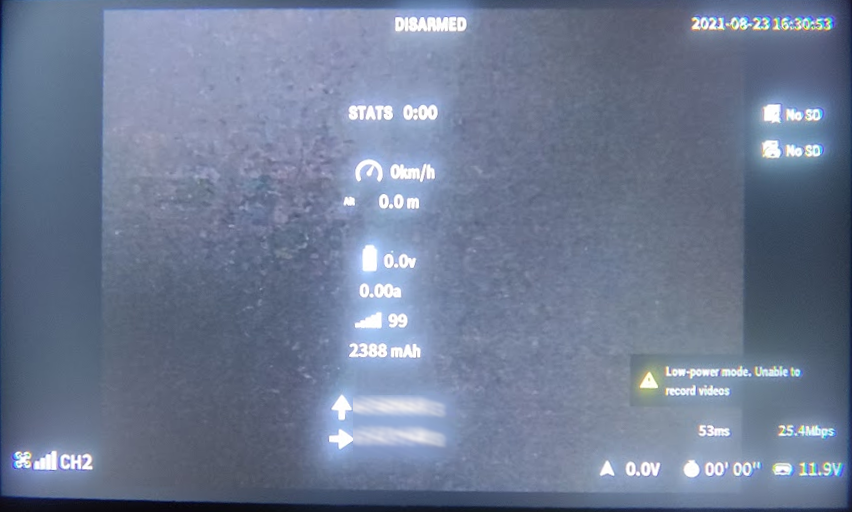

ArduPilot:master
← yaapu:pr/msp_osd_multiscreen
opened 11:06PM - 19 Aug 21 UTC
This adds multiple screens and stats to the DJI MSP Backend.
Support for multip… le screens is similar to regular OSD, one has to enable the additional screens with OSDn_ENABLE and switch between them with one of the supported methods defined by OSD_SW_METHOD.
Stats needed a "hack", when a user switches to a screen that has stats enabled with OSDn_STATS_EN = 1, the telemetry for speed, altitude, voltage, current and distance will report min/max values rather than instant values.
The home distance OSD item will alternate every 2 seconds between max home distance and total traveled distance
The message text OSD item will report "STATS hh:mm" where hh:mm is the flight time and just like usual incoming status text messages will be shown with rolling text.
![image](https://user-images.githubusercontent.com/30294218/130155340-99871704-cfcc-4d67-9b8f-d5479d644f43.png)
stats panels have to be individually enabled
- OSDn_STATS_EN 1.000000, required to enable the new stats feature
- OSDn_MESSAGE_EN 1.000000, required to display flight time in stats display mode
- OSDn_ALTITUDE_EN 1.000000, shows max altitude
- OSDn_BAT_VOLT_EN 1.000000, shows min voltage
- OSDn_CURRENT_EN 1.000000, shows max current
- OSDn_GSPEED_EN 1.000000, shows max ground speed
- OSDn_HOMEDIST_EN 1.000000, alternates max distance from home and total traveled distance every 2 seconds
- OSDn_RSSI_EN 1.000000, shows min rssi
_Note: to get airspeed max rather than gspeed max just like usual one have to set OSDn_ASPEED_EN =1_
A possible layout:

yielding
![image](https://user-images.githubusercontent.com/30294218/130485675-b53c5d65-1888-458f-95cc-0ac06e4c2715.png)
