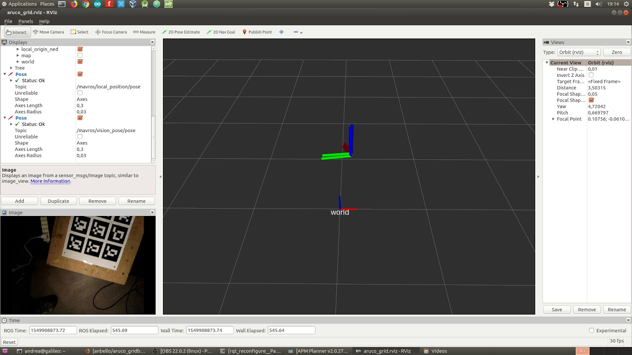

Hey I am starting to figure out the coordinate systems on the drone. Currently local_position/pose does not line up with vision_pose/pose as shown in the image. Vision_pose’s origin is about the rviz origin but’s its coordinate frame is not aligned with camera frame.
This image was taken after I edited around with your vision_to_mavros.cpp. In the picture the land_pad is the apriltag, camera is the onboard camera facing down towards the tag. Both the land_pad’s and the camera’s x-axis is pointed to the right of the drone.
Currently vision_pose looks like the x-axis is pointed up, y-axis(green) is pointed towards the front of the drone, the z-axis is left.
What should be the proper direction for the EKF to read vision_pose properly?
Hi @jacksparkman, for the vision position data to be fused correctly, it should follow ENU coordinates as received by mavros. You can have an overview of all the frames with this picture. In your case the T265 node is equivalent to Apriltag ros node.
Thus, you need to modify the code so that vision pose’ x axis to the front, y to the right and z upwards.
Should I be editing just the roll_cam, pitch_cam, and yaw_cam parameters to get the vision pose in the correct frame? I was not sure what gamma_world does.
Editing roll_cam, pitch_cam, and yaw_cam, with gamma_world set to 0, should be enough. The gamma_world param is used to adjust the initial body frame’s heading in the world frame for other types of vision system, so it is not essential for what we are doing.
