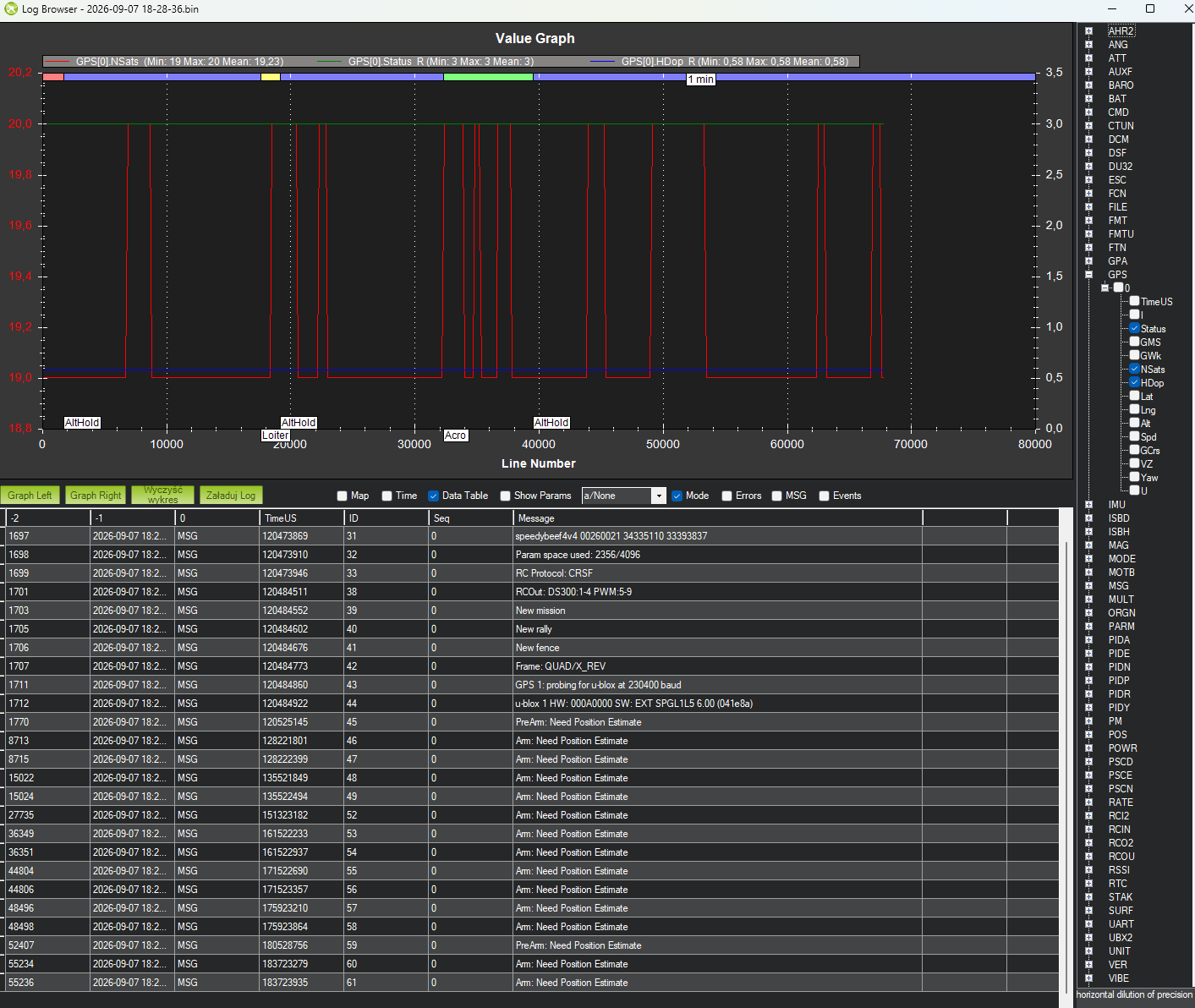

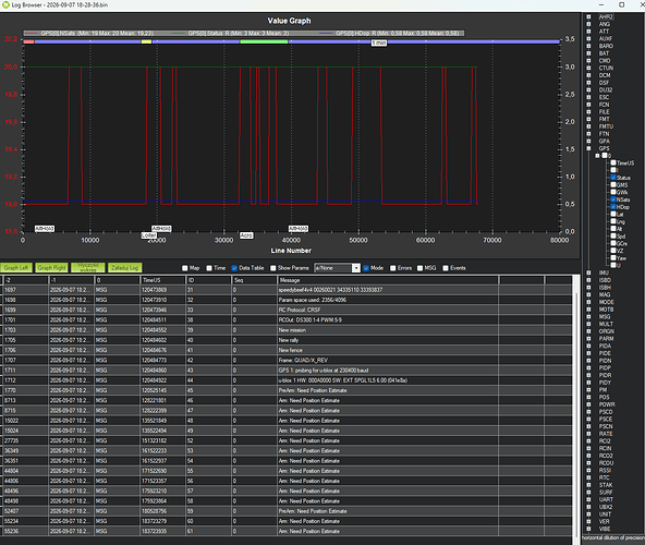

Today I tried to do a magfit flight same way I usually do - COMPASS_USE to 0, and YAW source set to GSF, takeoff in althold and fly a bit until heading is figured out, then switching to loiter and do some circles and 8 figures.
However… this seems to be not possible anymore with 4.7.1 (did not test with 4.7.0) and in MP pos_horiz_abs was constantly red and everytime I tried to arm in althold I got message “PreArm: Need Position Estimate” despite good gps fix (ublox DAN-F10N based GPS, 18+ sats, HDOP ~0.7m with SBAS), and “HOME” on OSD not blinking.
Is that a feature or a bug?
Once I allowed to use compass and set yaw source to compass, everything was fine again.

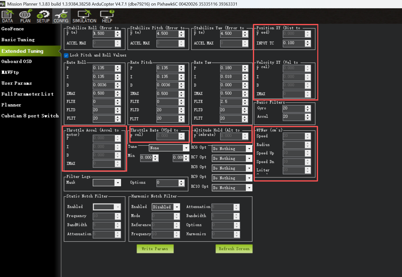

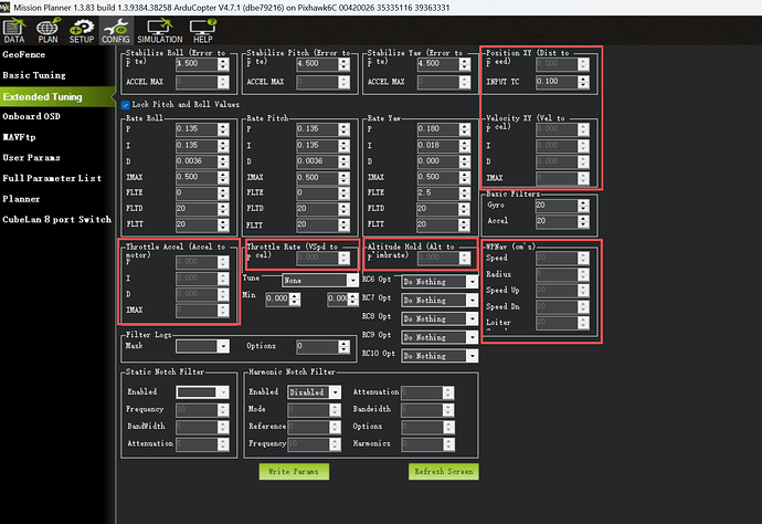

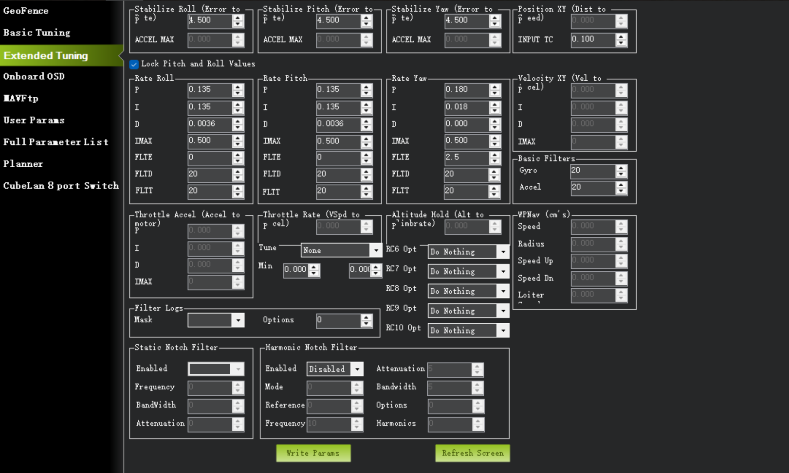

@**rmackay9**Hello, after flashing Copter 4.7.1, I found that I can no longer adjust certain parameters on the extended parameters page—such as throttle acceleration, throttle rate, and altitude hold. What is the reason for this?

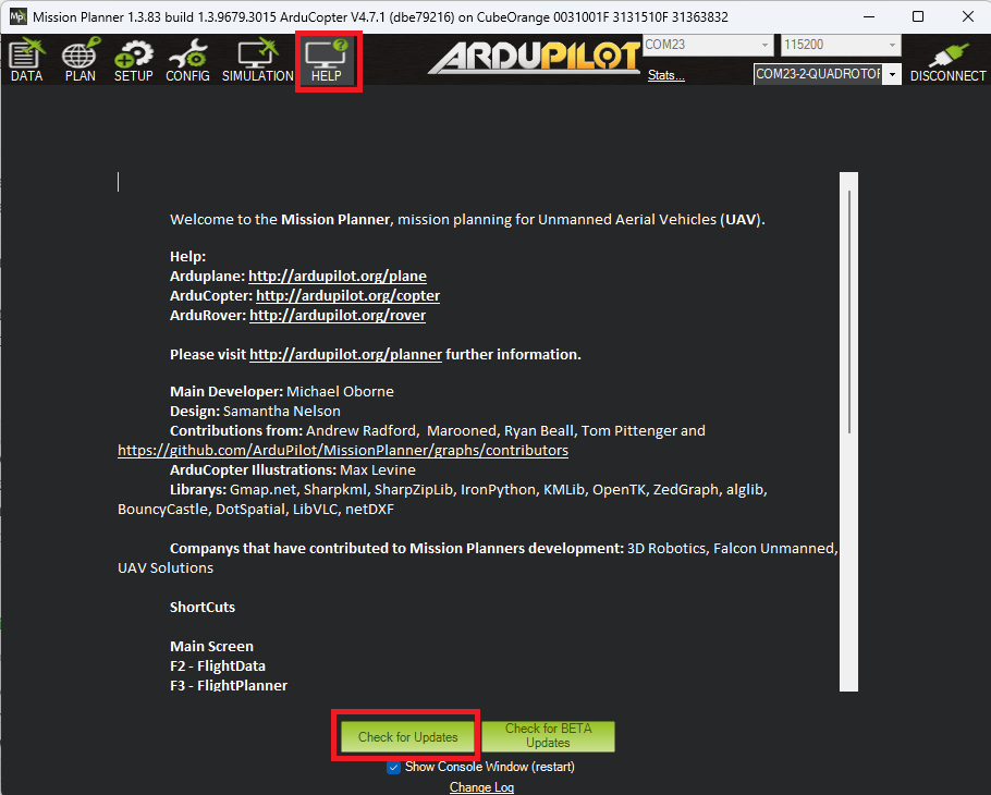

Hi @Rik_Sam,

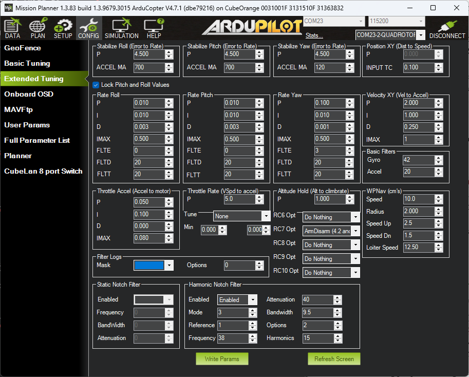

The issue is likely because we’ve updated many parameter’s names and scaling so Mission Planner also needs to be updated.
I’ve got a slightly newer version of MP installed and nearly all the fields are filled in.
Could you try selecting “Help” “Check for Updates” to see if that resolves the issue?

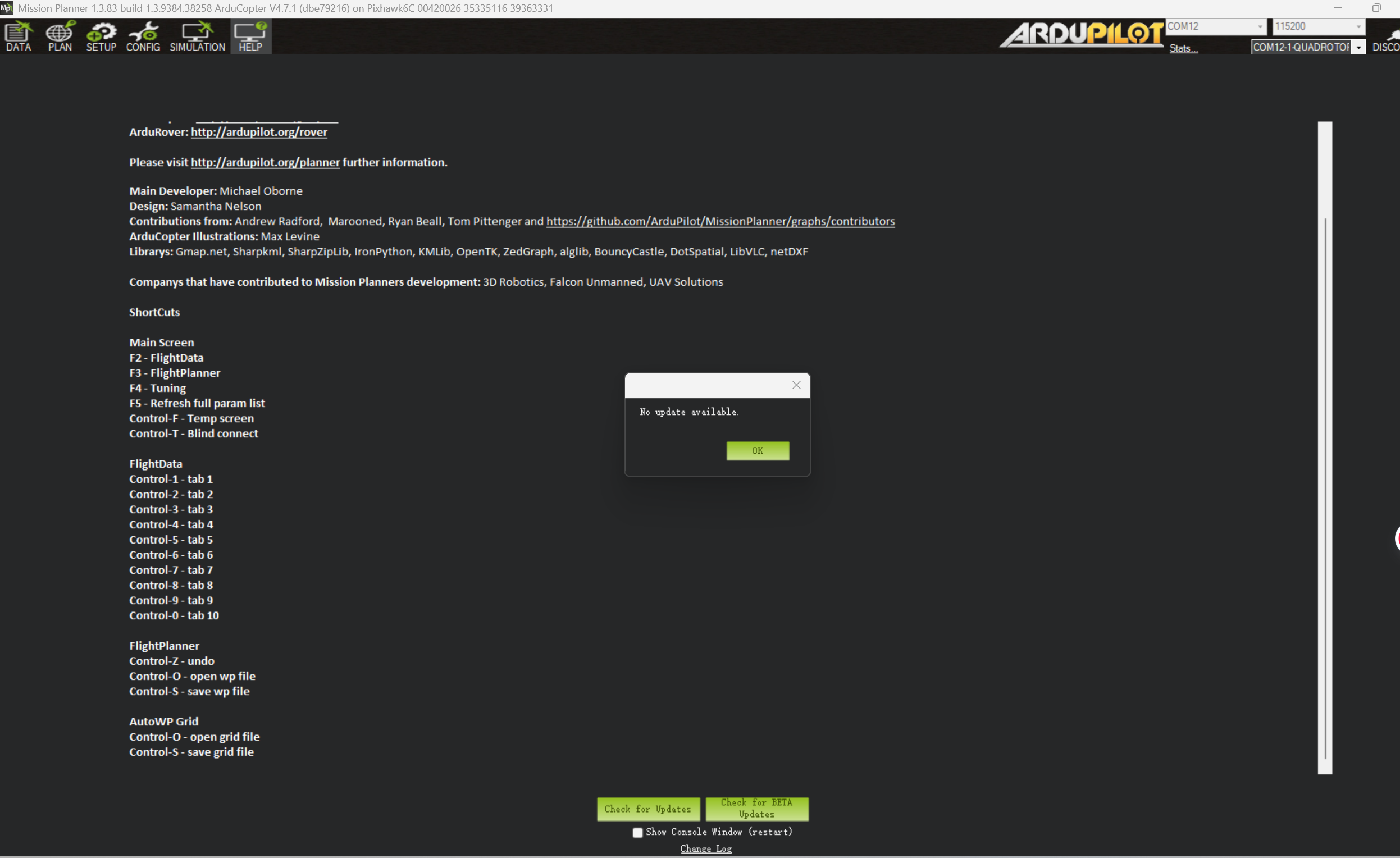

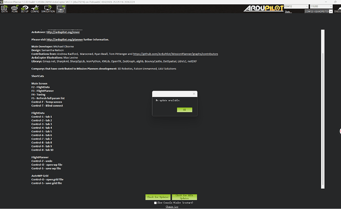

Thank you very much for your reply. I tried selecting “Help” > “Check for Updates,” but MP did not indicate that an update was available. My MP version is 1.3.83, which should be the latest version.
micoair recommends SERIALn_OPTIONS 1024 for their MTF-02P Optical Flow&Range Sensor, after migration, it was SERIALn_OPTIONS, 0. I am using serial 4 in MicoAir743v2-AIO-45A. How should I migrate to MAVn_OPTIONS? I set it to MAV4_OPTIONS Bit 1; am I correct?
Hello@rmackay9,

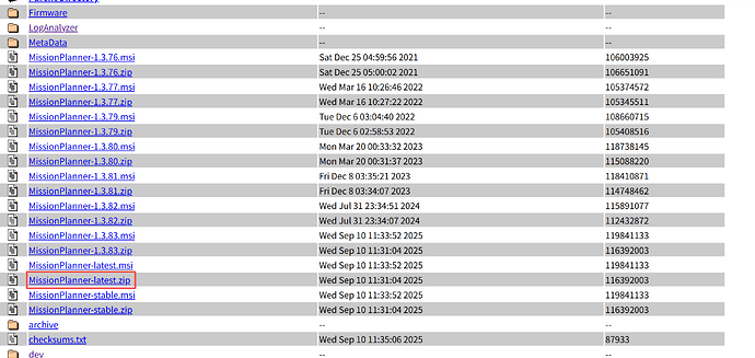

is there a version newer than 1.3.83?

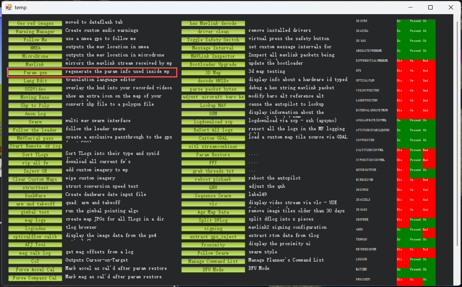

No, but do the beta update for the latest minor version.

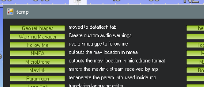

Then connect your 4.7.1 flight controller and press Control F and select “Param gen” from the extensive list.

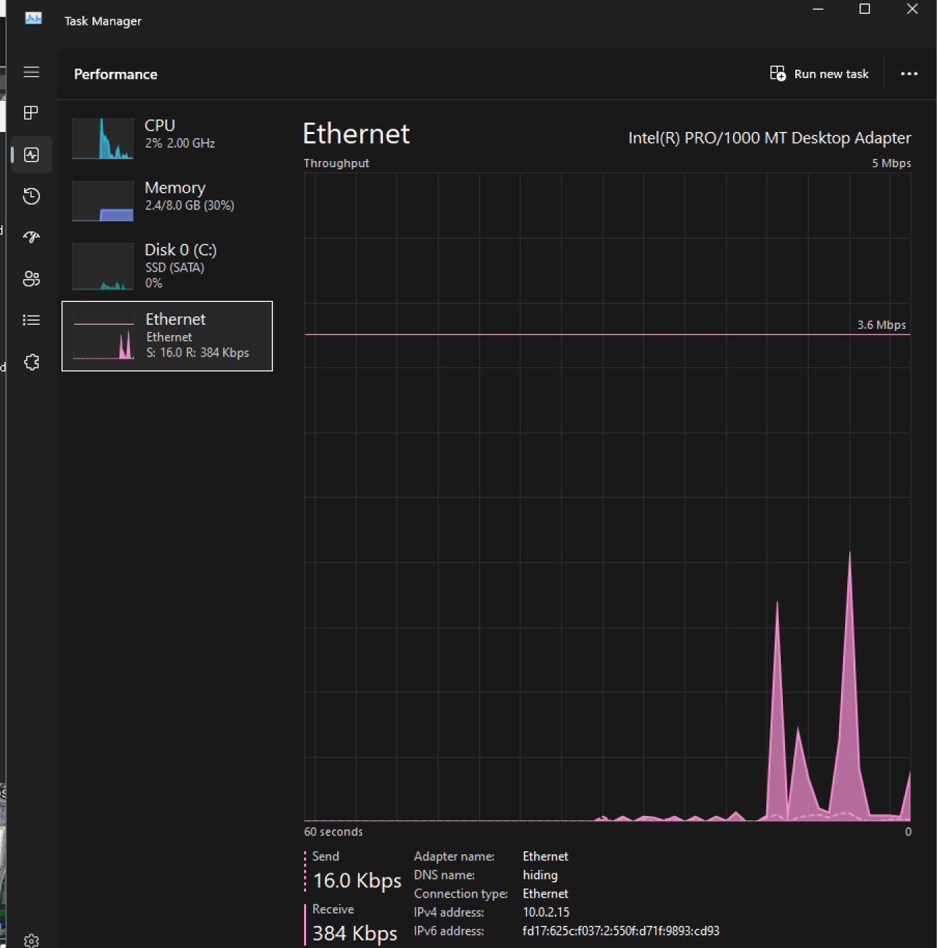

You can open Task Manager and look at your network to tell when the param download is finished, it can take a few minutes.
Hi @Rik_Sam,
I’ve ping’d MichaelO to ask him if he can release a new stable version. Sorry about that and thanks for the report!
Thanks @xfacta too!

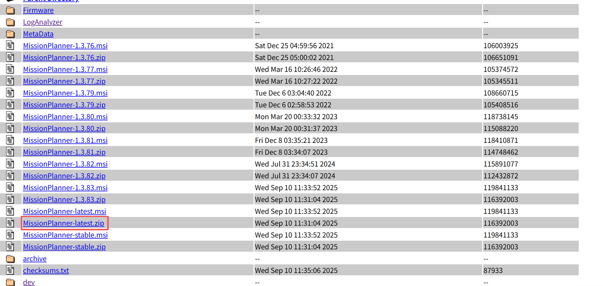

@**xfacta**Thank you very much for your reply. Today, I followed the steps you mentioned to upgrade to Mission Planner-latest.
Then, I connected the flight controller running version 4.7.1, pressed Ctrl+F, and selected “Parameter Gen” from the list.
I am still unable to configure the settings.

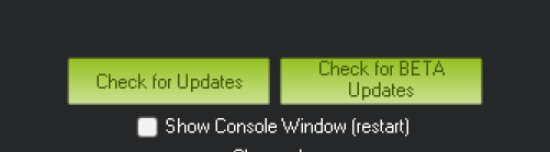

In the MissionPlanner Help screen select the “Check for BETA Updates”
You dont need to download anything manually.

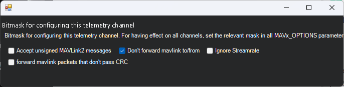

I think similar to the rangefinder using serial interface. So, I just set MAV1_OPTIONS Bit 1 will do, is it?
Hi @Jai.GAY,
Yes, I think you’ll need to set MAVx_OPTIONS = 2 (“Don’t forwared mavlink to/from”). This will stop the mavlink messages from the sensor from being sent to the GCS which would just consume bandwidth and the GCS doesn’t use the data.

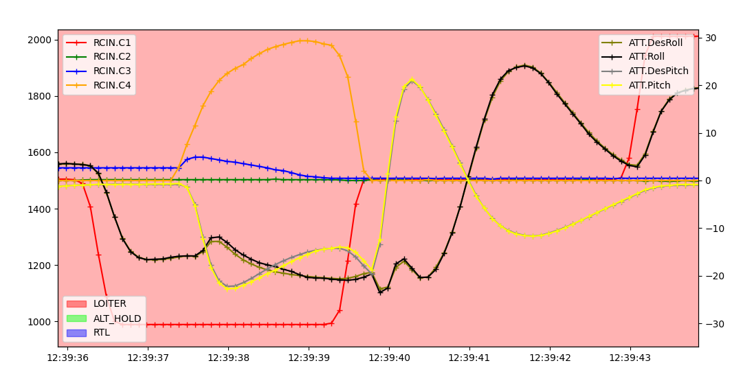

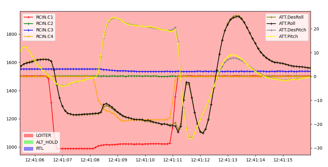

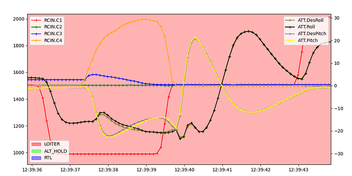

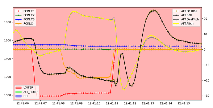

I’m seeing some strange behaviour with the coordinated turns in loiter mode. If I go from directly from a turn (yaw and pitch inputs only) to neutral sticks the quad seems to hold in an excessive counter roll angle for some time.
Two examples from the same flight:
It was repeatable, go directly from a yaw turn to a stop and the roll would hold for several seconds. It’s as if the braking action was holding on for too long. Long enough to cover some ground after centering the sticks.
If I released the yaw and continued with a pitch input then everything acted as expected, no issues.
Log: Proton Drive
