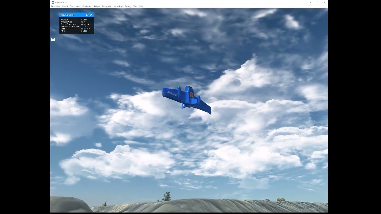

Here is a tailsitter in Alt-hold. Very precise. no issues at all.
Same everything but with the new QLOITER Yaw is ok but the bird keeps flying.

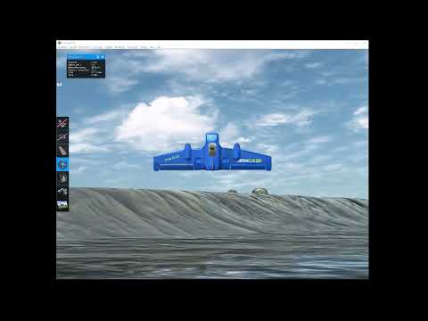

As a new test i loaded a tailsitter, I don’t think the option is available in tailsitters Q mode..
Ahh I basing this on Realfight. Yes I know i don’t need to upgrade. The changes to loiter have a big impact in the software for tailsitters. In my case i not able to make the set to zero option.
I only have my work in realflight showing the issues. Nothing has changed but the flight mode. I not trying to make blame that would not make sense. Please look at the two videos i uploaded again the Paco in alt hold and Paco in loiter. I guess the simple answer is i am unable to make the changes your asking me to do. I can ask Peter Hall we done a few realflight projects together for some a list clients. “bring the old loiter back” I did not mean to say only have one but two versions. what i said, “I wonder if we could bring the old loiter back with a new flight mode name”

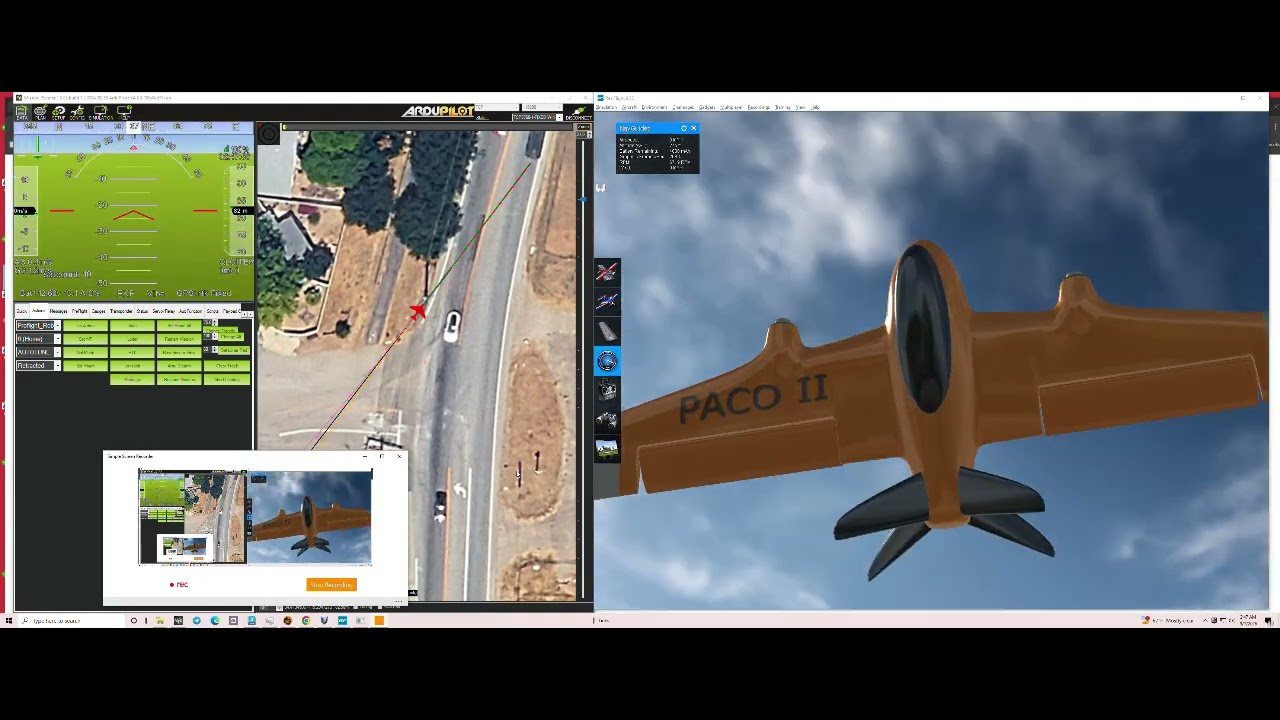

I made one more video to help show what I am seeing, this Realflight model was tested and approved and can be downloaded in Git hub. Please look at the red plane icon upper left in the MP hud and note that I just taped the sticks, please notice the model is not keeping it location as it should and is drifting way off. I have made zero changes to the working model but only currently running the new Loiter.
