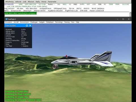

I would recommend setting up a model in realflight and using SITL to test.

yep, same file abit further down although I fairly sure ArduPlane can already do all that stuff in copter mode.
Realflight 8 if you have it or Realflight 9 if you have to get it.
http://ardupilot.org/dev/docs/sitl-with-realflight.html

totally possible to do VTOL tilitrotors, see this example from @kd0aij
It won’t accurately model power draw and drag ect, but the physics are correct.

So it will model the thrust vectoring??? wow! thats impressive. thanks Pete…
