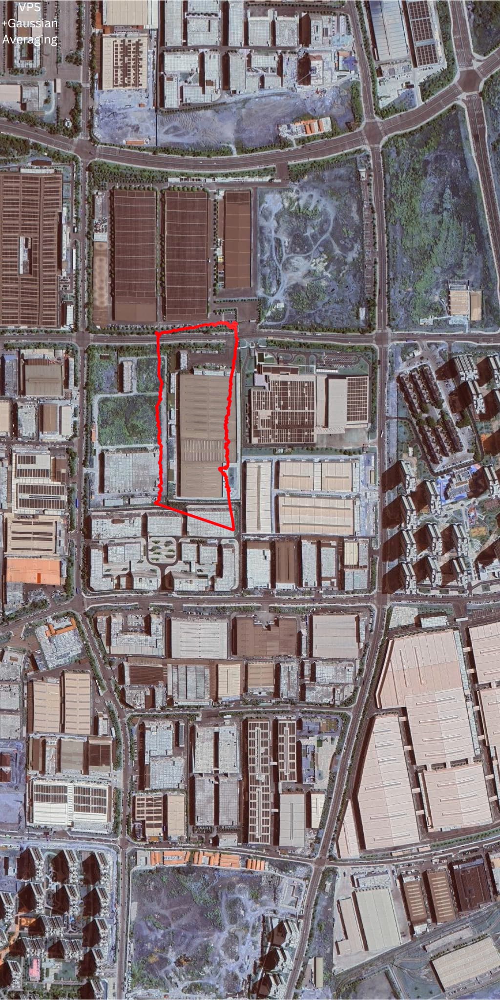

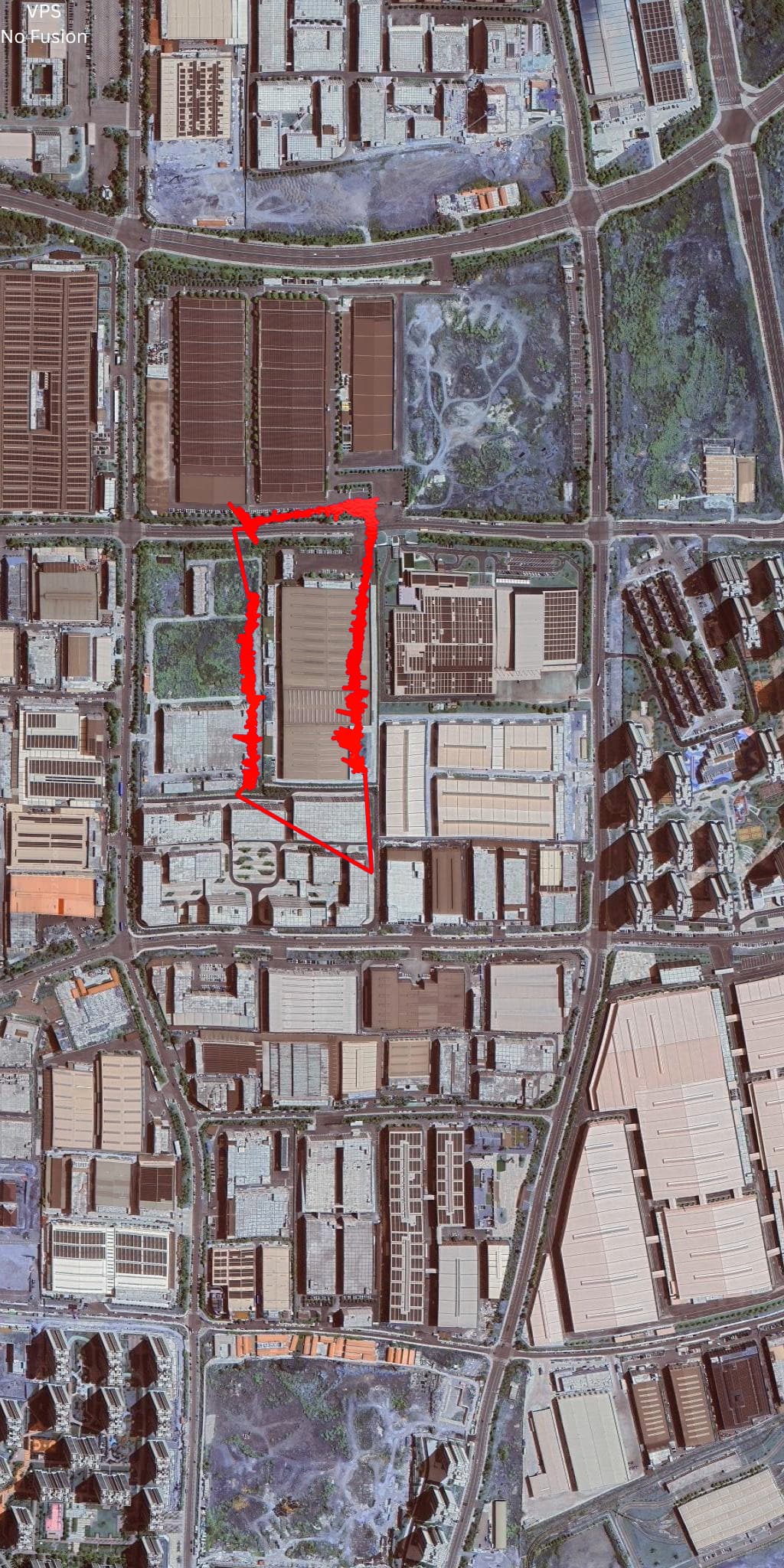

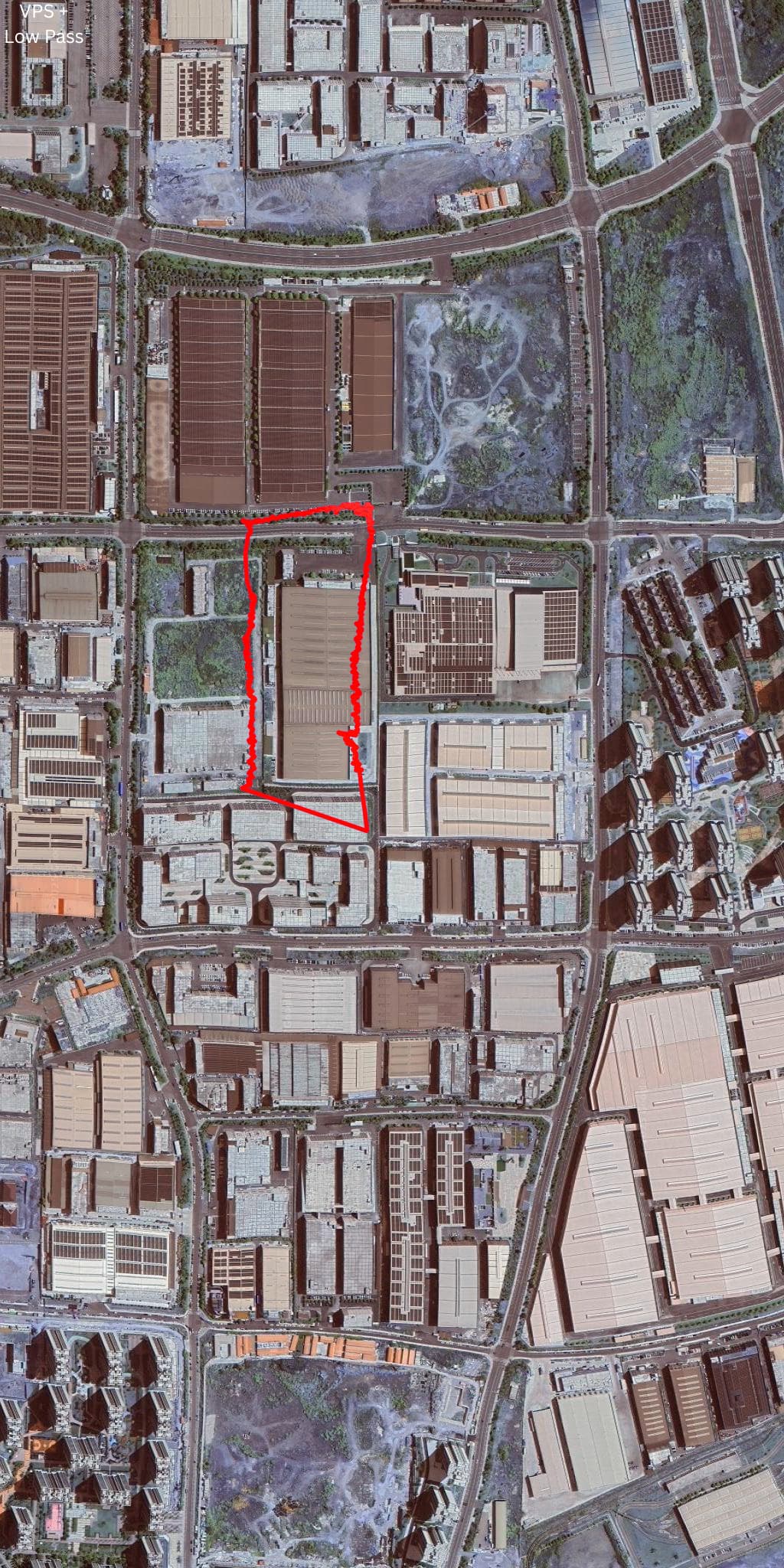

Estimated UAV trajectory at 150 m altitude overlaid on satellite imagery. Left: raw VPS. Middle: VPS + moving average. Right: VPS + Gaussian averaging.

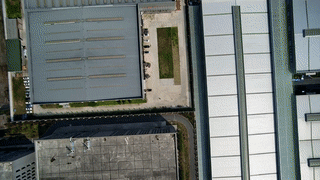

Downward-looking camera footage (Ɨ4 speed) used for VPS map matching at 150 m altitude flight.
Click on this to redirect to the Raw VPS estimation inferencing visualization video

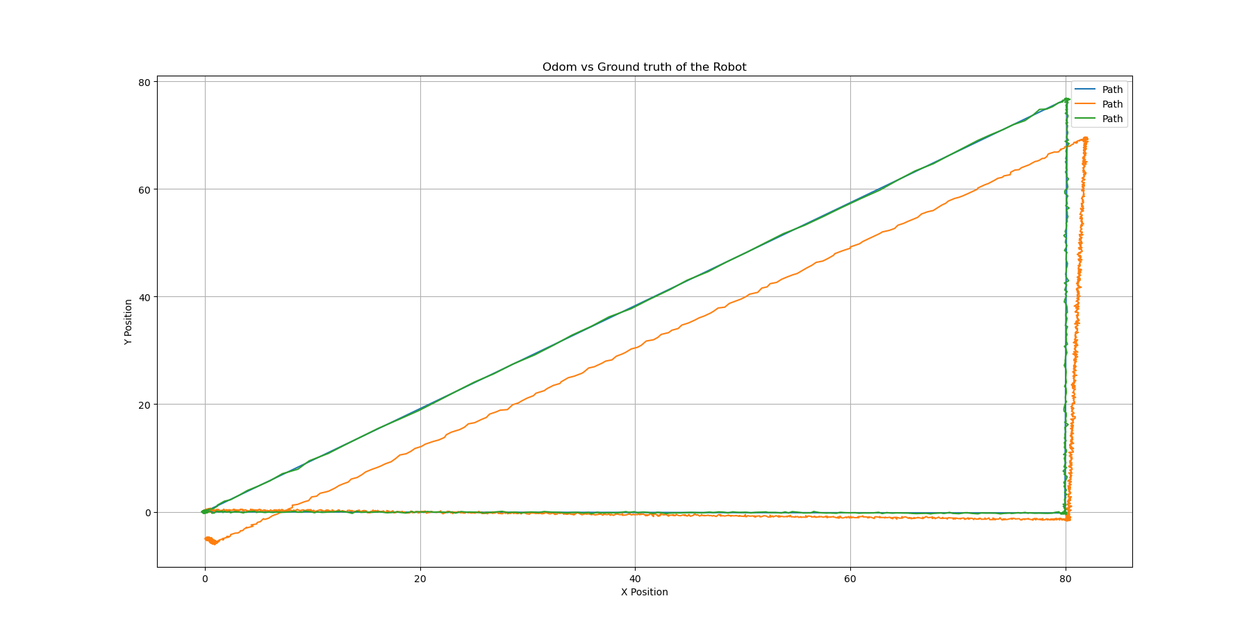

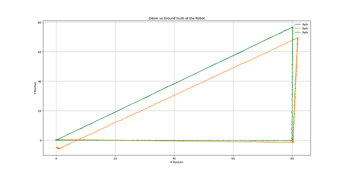

Simulation results: ground truth vs. raw VPS vs. VPS fused with VIO.

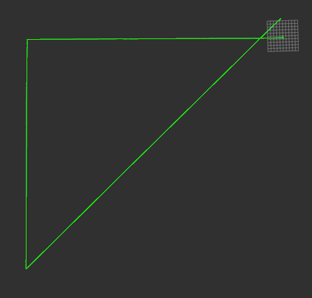

A 3-point triangle trajectory simulated in gazebo
The ROS2 bag file for this tests is around 14GBs. I am still figuring out a way to share that;

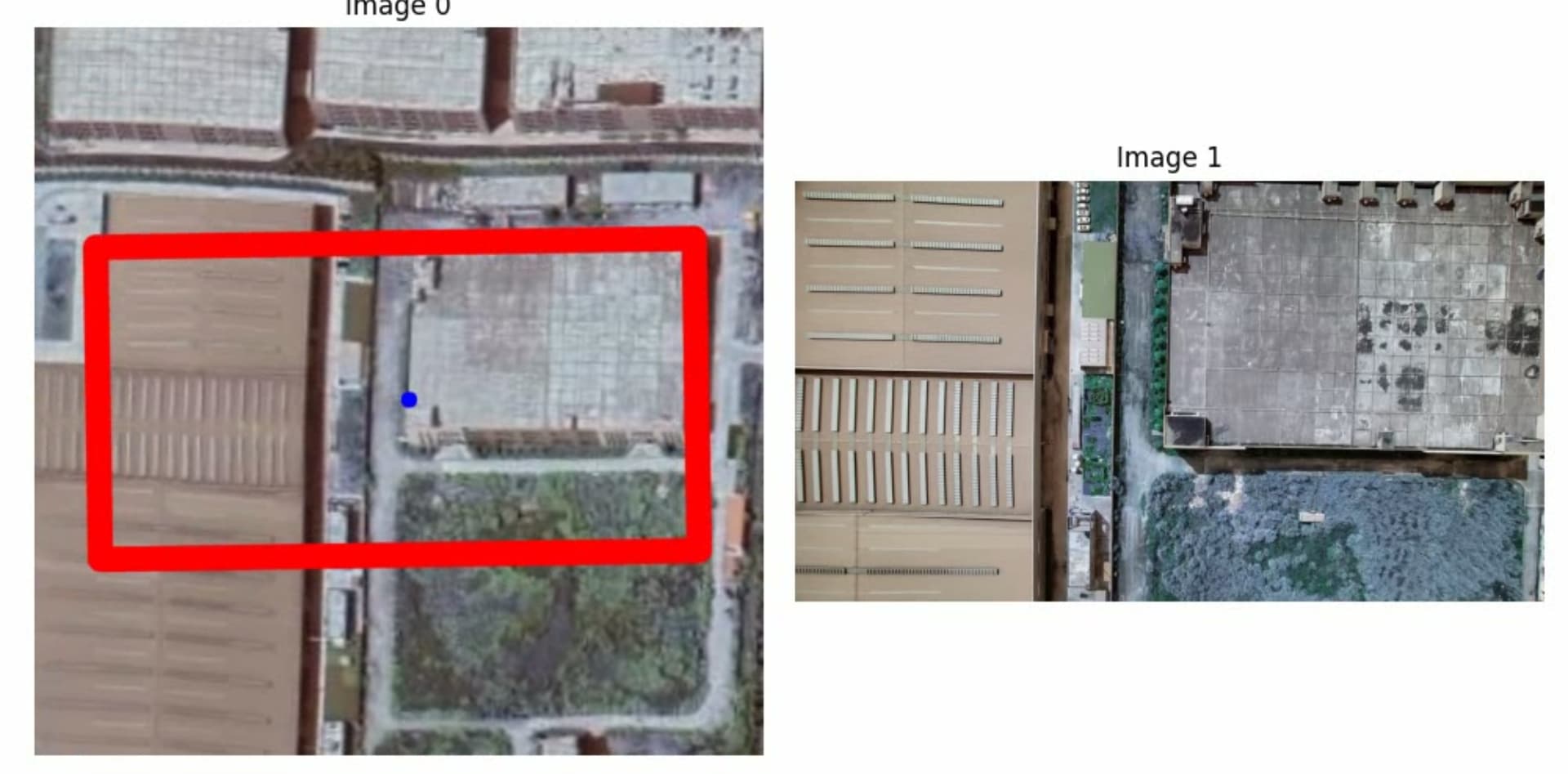

Instead of my original custom detector-free VPS positioning and map-matching modules, this version uses LightGlue + SuperPoint (or optionally ALIKED) for image-based matching between the drone view and the reference map. This is integrated with VINS Fusion VIO for motion estimation.
