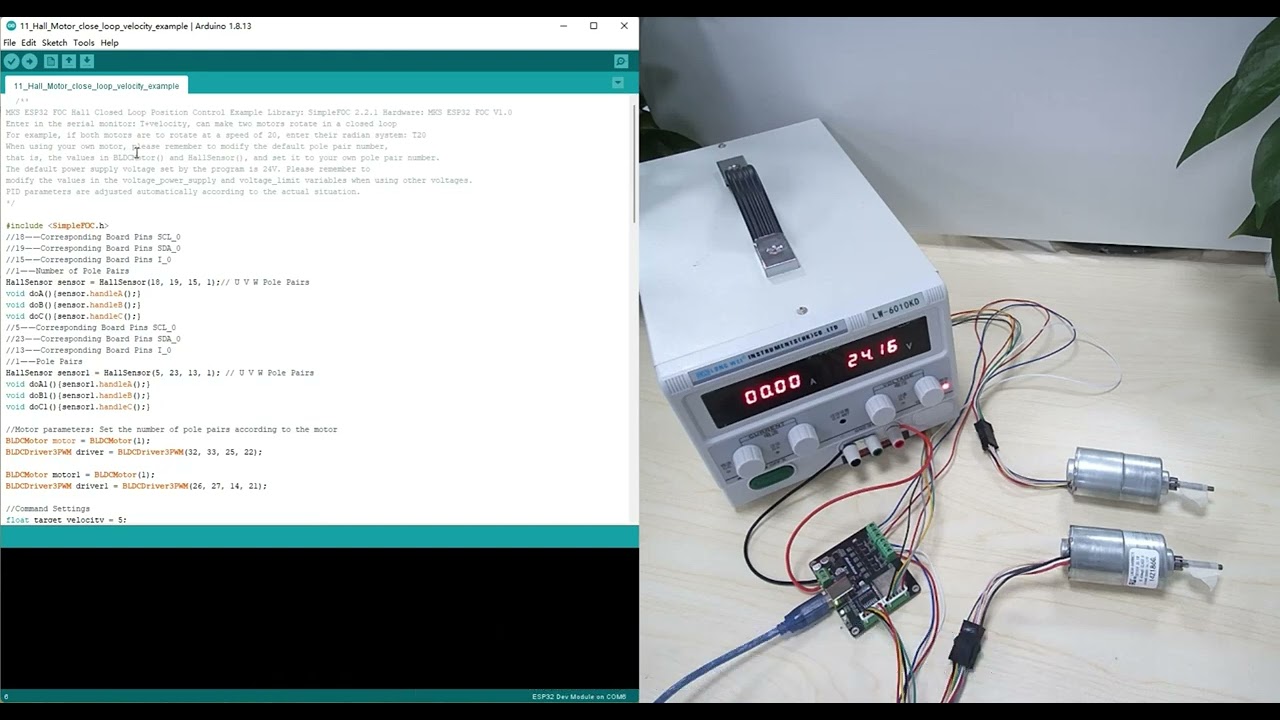

Unfortunately it doesnt leave many options for a low cost replacement but this SIMPLEFOC controller looks interesting. It can do 2 motors at 12A for under £20 and it runs off a ESP32 so its fully programmable. I should be able to make it connect directly with mavlink.

I have made a first draft of a Mavlink ESP32 SimpleFOC Dual motor controller. it takes mavlink telemetry servo outputs and converts them to velocity requests, telemetry is then sent back using some named floats. Motor control runs on Core 0, telemetry runs on Core 1.
its untested as I don’t have the hardware yet.
Something that the SimpleFOC controllers have is per motor real time phase voltage and current monitoring, so it should be possible to monitor the torque and RPM output of each wheel. With that it should be possible to make a traction control system that limits wheel slip.
In theory, it could also be possible to use the front wheels as a type of bumper by detecting current spikes. When the front wheel contacts something, the torque for that the front wheel needs will go up as it will try and lift the rover over the obstruction. the rover can then stop so it doesn’t run it over and mark where that wheel is as a proximity obstruction. Essentially using the front wheels to “feel” It’s way around.

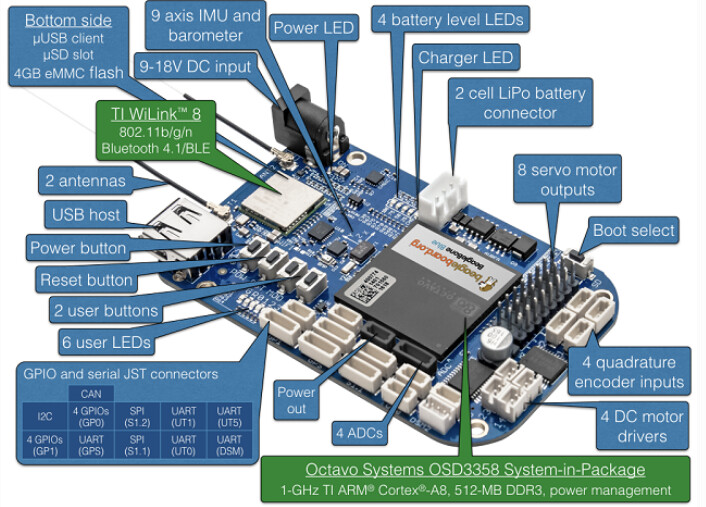

I have been on the look for a cheap flight controller to replace the series of defective Matek H743 boards I have been struggling for over a year with at this point and due to circumstances i have had to prioritise other things so i havent been able to fund a very expensive flight controller upgrade to one of the higher end H743 boards. so I have been looking for alternatives. I checked out a lot of the DIY linux boards but most of them are EOL due to sensors that are not made anymore, I looked at esp32 but its still experimental but then I remembered about the BeagleBone Blue and Yuris efforts to simplify the install process HERE
After some checking I realised it can still run the latest firmware and lua. I started looking to see if i could get one. Yuri offered me his but I can find them in the UK new for £18!! for that price its worth some effort to get it working.

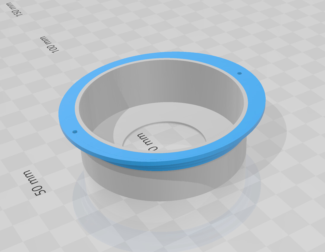

I have designed some low friction 3d printed tyres for testing traction control on the new ESCs, printed in PLA they are very smooth. The problem is the tyres it has now are just too grippy with their chunky tread to test without resorting to extreme setups. These should let it slip much easier. I also wanted something that was a little kinder to the grass in the garden, the tread was ripping up chunks of grass when it tried to turn on the spot. They could also make good regular tyres if they are printed in a soft material.

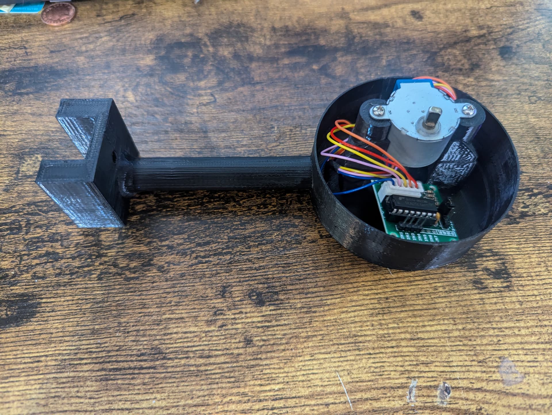

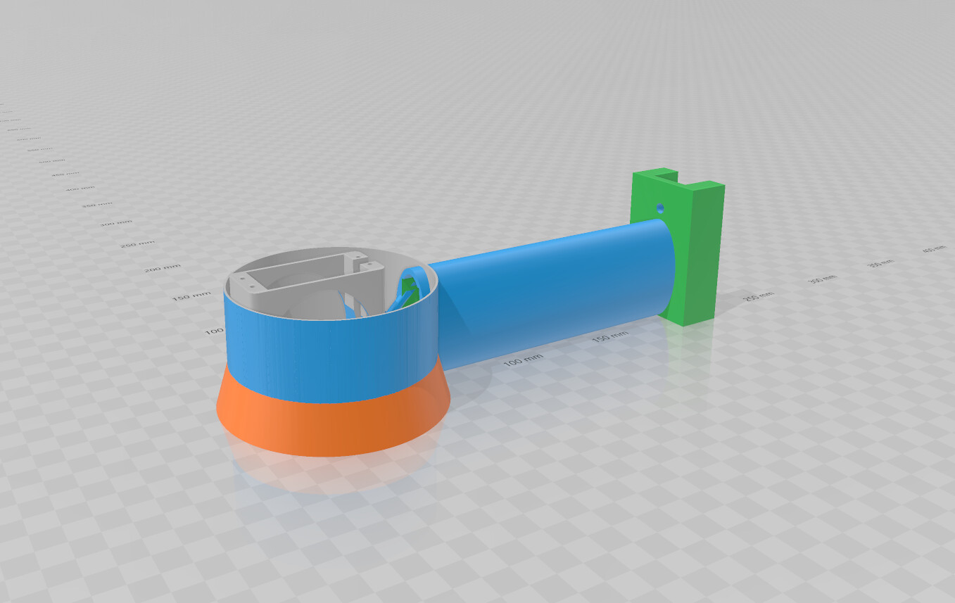

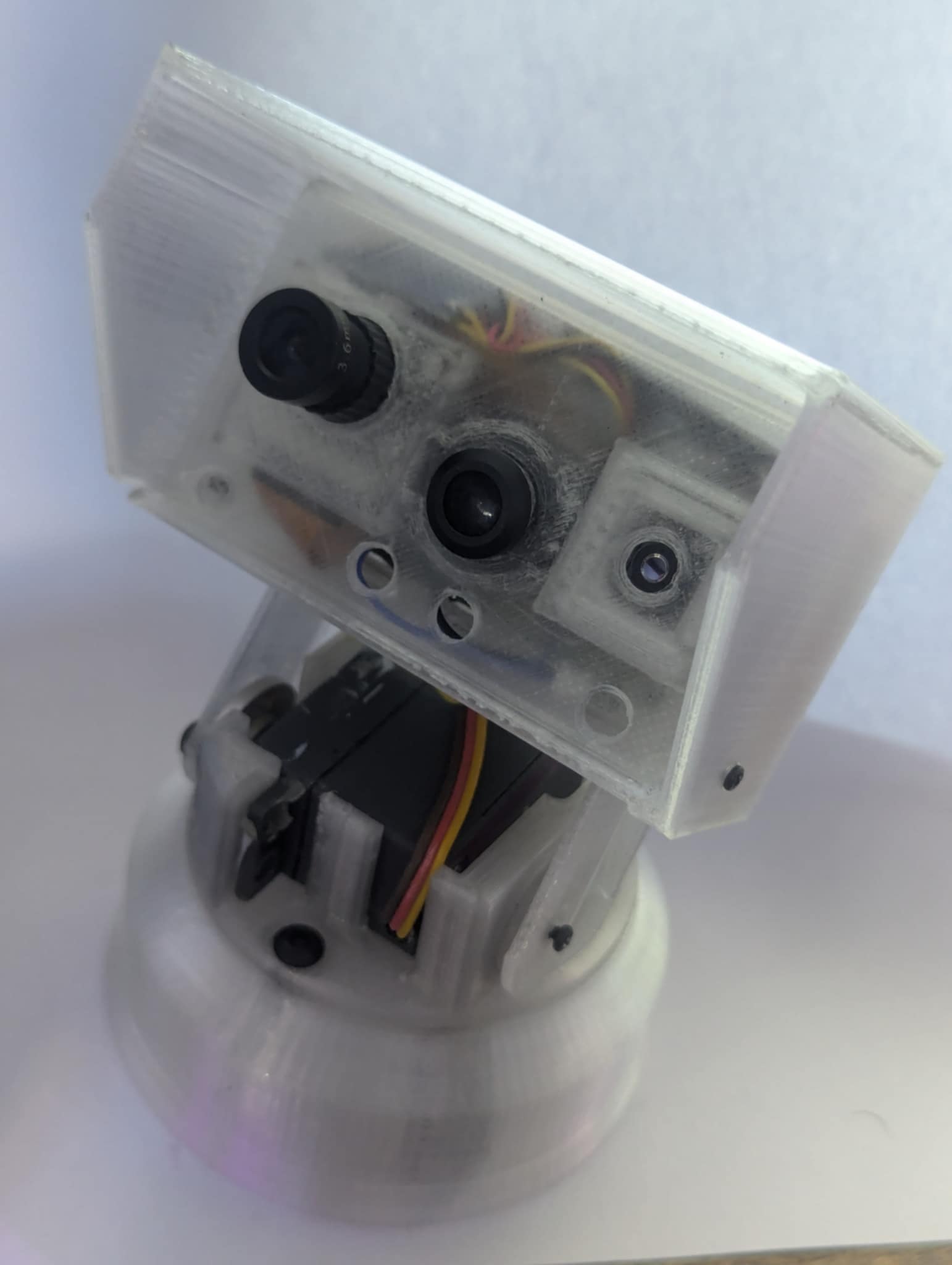

My servo gimbal that has the Raspberry pi zero 2 running drone engage has been getting a lot of upgrades, Im replacing the sail winch servo I’m using to pan the camera gimbal, I thought the servo would be a good idea as it can travel 540 degrees but after testing it, it can do that range, but it has zero accuracy (±10 degrees), its very slow and just totally unsuitable for cameras. so plan b is a cheap stepper motor.
I have designed a version of the gimbal that takes a 28BYJ-48 geared stepper motor rather than a servo I still need to figure out a way if setting the starting position like a switch or remembering where it was when it went to sleep.

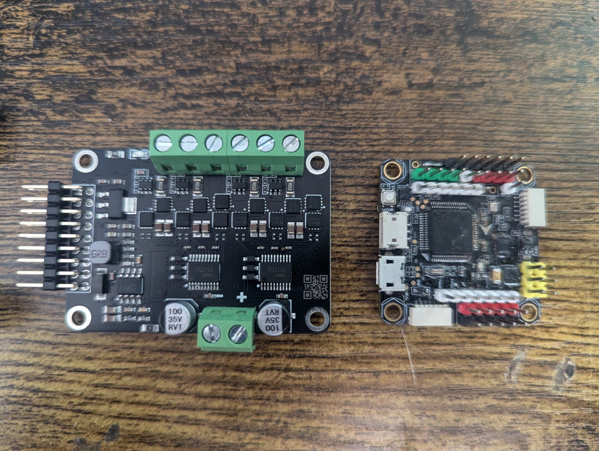

The new Flight controller arrived, it’s chonky I have never seen a flight controller this big, it’s about the size of a PI4. what is slightly annoying is that it doesnt come with any wires at all. so i will need to order some JST1.0 connectors.

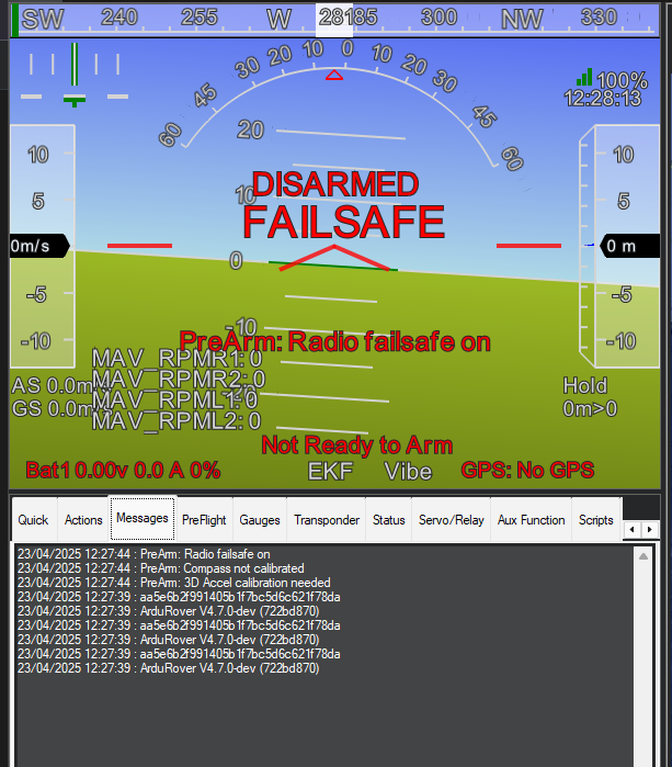

Getting it set up was a piece of cake, it took me 30 minutes from opening the box to connecting to mission planner. thanks to @Yuri_Rage and his updated setup guide.
It dwarfs my omnibus controller.
New escs arrived it’s a dual channel 12A ESP32 SimpleFOC controller. it’s tiny, about 1/4 the size of the hoverboard esc.
