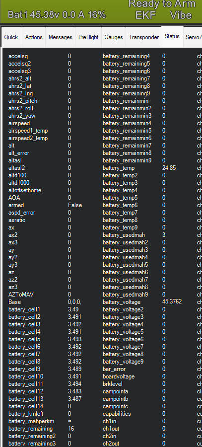

I have a new BMS library to test to get my bluetooth BMS to communicate with ardupilot, This library looks much more promising as it’s their app that I use on my phone for them. I still need to get ardupilot to use the mavlink battery data using this script.
local mavlink_msgs = require("mavlink/mavlink_msgs")
local msg_map = {}
local battery_status_msgid = mavlink_msgs.get_msgid("BATTERY_STATUS")
msg_map[battery_status_msgid] = "BATTERY_STATUS"
-- initialise mavlink rx with number of messages, and buffer depth
mavlink.init(1, 10)
-- register message id to receive
mavlink.register_rx_msgid(battery_status_msgid)
function update()
  local telem_data = ESCTelemetryData()
  local msg,_,timestamp_ms = mavlink.receive_chan()
  if msg then
    local parsed_msg = mavlink_msgs.decode(msg, msg_map)
      if(parsed_msg.msgid ~= nil and parsed_msg.msgid == battery_status_msgid) then
        telem_data:voltage((parsed_msg.voltages[0] or parsed_msg.voltages[1]) / 100)
        telem_data:temperature_cdeg(parsed_msg.temperature)
        telem_data:current(parsed_msg.current_consumed / 1000)
        esc_telem:update_telem_data(1, telem_data, 0x0D)
      end
  end
  return update, 1000
end
return update, 1000
void MAVLINK_BATTHB() {
  uint8_t autopilot_type = MAV_AUTOPILOT_INVALID;
  uint8_t system_mode = MAV_MODE_PREFLIGHT;  ///< Booting up
  uint32_t custom_mode = 0;                  ///< Custom mode, can be defined by user/adopter
  uint8_t system_state = MAV_STATE_STANDBY;  ///< System ready for flight
  mavlink_message_t msg;
  uint8_t buf[MAVLINK_MAX_PACKET_LEN];
  int type = MAV_TYPE_GROUND_ROVER;
  // Pack the message
  mavlink_msg_heartbeat_pack(1, 180, &msg, type, autopilot_type, system_mode, custom_mode, system_state);
  uint16_t len = mavlink_msg_to_send_buffer(buf, &msg);
  Serial1.write(buf, len);
void MAVBATTERY() {
  uint16_t CELLSA[10] = { CELLS[0], CELLS[1], CELLS[2], CELLS[3], CELLS[4], CELLS[5], CELLS[6], CELLS[7], CELLS[8], CELLS[9] };
  uint16_t CELLSB[4] = { CELLS[10], CELLS[11], CELLS[12], CELLS[13] };
  uint8_t system_id = 1;  // id of computer which is sending the command (ground control software has id of 255)
  uint8_t component_id = 180;
  uint8_t id = 0;
  uint8_t battery_function = 2;  //propulsioni
  uint8_t type = 3;              //liion
  int16_t temperature = bms.get_ntc_temperature(1);
  uint16_t* voltages = CELLSA;
  int16_t current_battery = CURRENT;
  int32_t current_consumed = (20000 - CAPACITY);
  int32_t energy_consumed = 10000;
  int8_t battery_remaining = SOC;
  int32_t time_remaining = (CAPACITY / CURRENT);
  uint8_t charge_state = 1;
  uint16_t* voltages_ext = CELLSB;
  uint8_t mode = 0;
  uint32_t fault_bitmask = 0;
  //Pack battery message
  mavlink_msg_battery_status_pack(system_id, component_id, &msg, id, battery_function, type, temperature, voltages, current_battery, current_consumed, energy_consumed, battery_remaining, time_remaining, charge_state, voltages_ext, mode, fault_bitmask);
  uint16_t len = mavlink_msg_to_send_buffer(buf, &msg);  // Send the message (.write sends as bytes)
  //if (CELLS[1] > 1) {
  Serial1.write(buf, len);  //Write data to serial port
