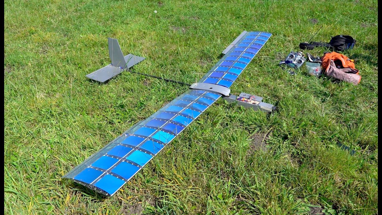

Check out my old post: https://discuss.ardupilot.org/t/solar-rc-plane-300km-7h/60981
