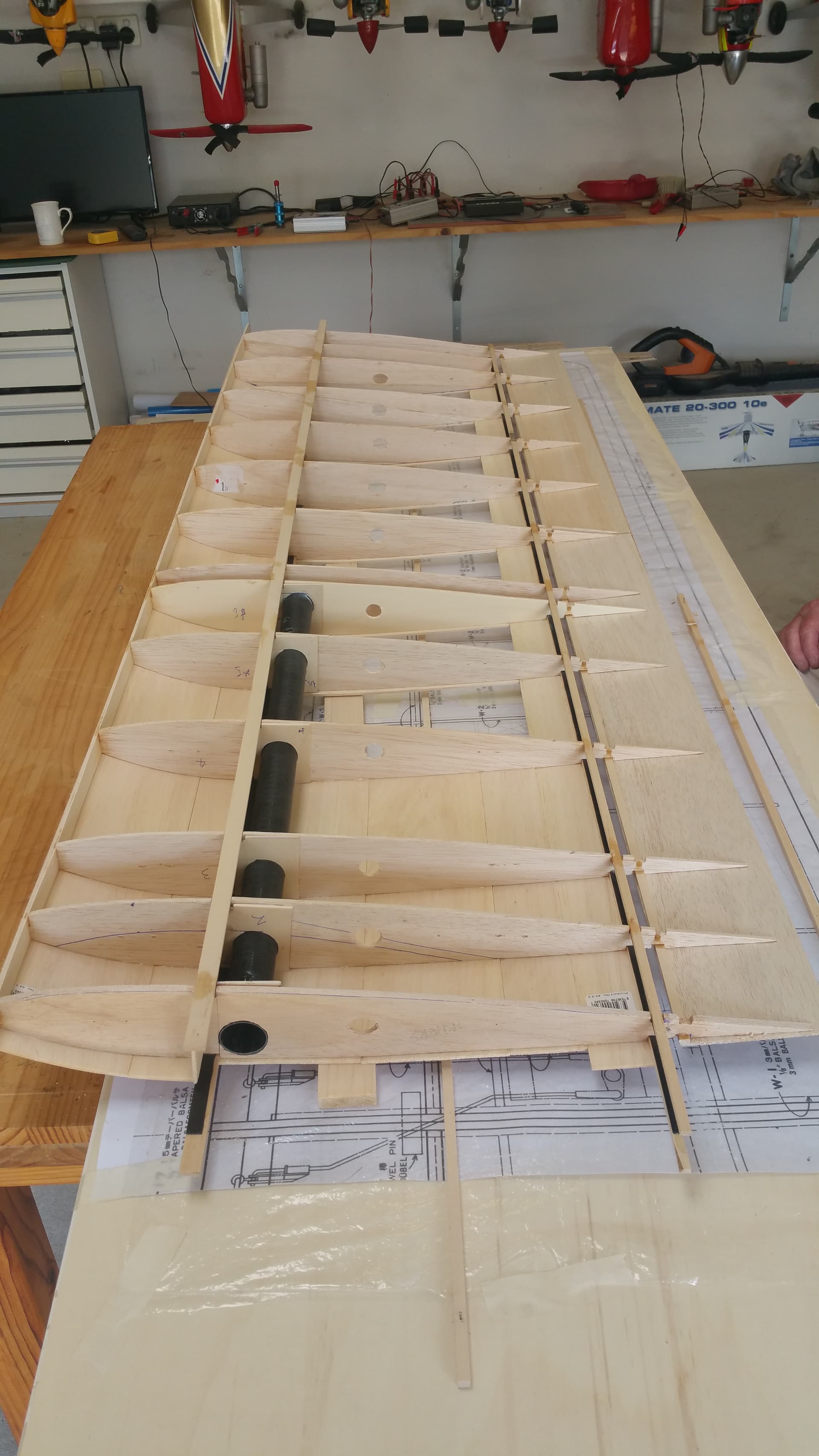

Hi Colin, Have followed your build with interest, however i may have missed the following. What profiles did you use for the wing and v tail. If you havent shown/discussed etc could you please post some details. Plus were the plans scratched up or did they come from another source.
Regards
sorry no plans hand drew
buy end of the build i cut them up to trace out the parts i should of got them scanned
but the main wing rib was the root rib of 100cc extra 300 same as tail
Thanks Colin for the feedback. Bloody hard to find any CLEAR drawings /profiles on the net

Hi Colin… that airplane looks great!! Are the wings made of balsa wood or foam? One question: where did you buy the strobe light in this photo?
Kind regards
https://discuss.ardupilot.org/uploads/default/original/3X/8/8/8858741d8ee4bee4fce3750cfb7795e4293c1ce2.jpeg
balsa wing to big foam 3.1m wing
