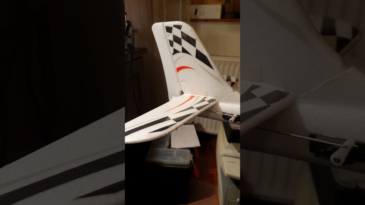

fly witn 4.1.0 beta. Matek f405 wing. sonicmodell binary 1200
Run new autotune. Not found any big improvement for traditional 4 channel plane
here logs https://1drv.ms/u/s!AuFPVI_eDaZbhbwWqZzoPirkPVgl2g?e=Sscwi8
plane have jerks on roll axis
and here video of flying
https://youtu.be/1yFLdk9Yi3E
