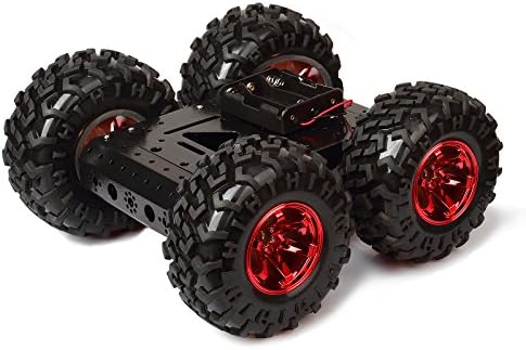

Also I found another small rover on amazon. Wanted to hear your thoughts on it. Looks pretty basic but similar size to the wild thumper and much cheaper:

Also not sure about which motor controller to purchase that’s suitable for the rover and what would work best with the pix.
Bad AHRS means it’s not happy with the position estimate. This can happen on start-up if it doesn’t have good GPS position info yet. If that’s the case and it goes away after a minute or so it’s no problem. I don’t think it’s related to the compass but you do only have one enabled right?
I think you will get what you pay for with that vehicle. It looks Toy grade to me. How fast do you plan on running the vehicle during a typical mission?
Yeah your right it does go away after a bit of time but during driving it manually when I turn left or right all the way like doing a doughnut it then comes back up,
Yes it is toy grade lol it’s says it can go 320rpm but I’m not looking to take it past 0.5 m/s
All those chassis including the Wild Thumpers use 25D brushed gear motors with 6 or 12V rating. The wheels are fixed to the gearbox output d-shaft with a set screw. So all the forces that occure during driving/turning are taken by a brass sleeve bearing and a small pin on the opposite end of the output shaft. The brass bearing and/or the pin wear down quickly, especially if the rover is heavy. The brushed motors also tend to fry if they stall for to long. And replacement motors are surprisingly expensive.

There are some robot chassis that use bigger 37D motors with gearboxes and they have 6mm output shafts instead of 4mm, but I never used them, so I can not tell you anything about the quality.
Lynxmotion A4WD2 and A6WD2 use 37D motors for example, but they are not cheap.
