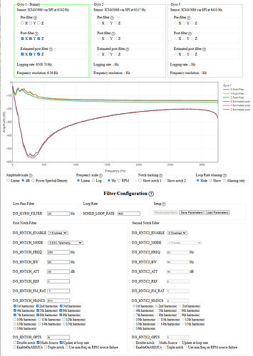

Any chance you can validate my understanding of if I am doing this notch filter configuration correctly? What I am not understanding is how to know when I have reached optimal settings from the Filter Review Tool and if there is a more scientific way of determining what the proper settings should be. I’ve basically just been messing with settings until I find a combination that leads to the biggest drop in dB. I’ve pasted a screenshot below of what I believe is my most optimal parameter settings so far by looking at the estimated post filter vs the post filter. What Ive gotten there so far has been done by pure trial and error.
I can have a max of 54 notches before the auto pilot errors out on reboot. I have a hexacopter and am using ESC telemetry (cube orange plus and hobbywing x6 motors). I can get the dB to drop the most when I enable more in INS_HNTCH_HMNCS. However, I have to uncheck EnableOnAllIMUs in INS_HNTCH_OPTS.
Here’s the main area I dont fully understand: How do you determine the right value to use for INS_HNTCH_FREQ? And tradeoff wise, is it better to have more harmonics and disable the notch filter on all IMUs? Or should I have all EnableOnAllIMUs selected and have less harmonics selected? Will these settings have a dramatic impact on CPU as well that I will regret? Alterntively, am I just completely off track here and not understanding the optimization goal here? I’m thinking I need to balance this all with CPU load somehow as well.
I’m thinking of starting with INS_HNTCH_HMNCS=15 (first 4 harmonics), and not checking EnableOnAllIMUs to see what kind of CPU load this causes.
I’ve read the blog post by Peter Hall several times, watched the associated Youtube, and have been reading several other wiki articles. I’m just not finding anything that says objectively “here’s how you know when you’ve taken this step as far as it can go for the most optimal setup”.
Here are the same settings, but only applied to the first 4 harmonics:
Thanks for any additional help you are willing to provide!
Also here’s a slightly different view. If I switch the amplitude scale to Linear now I can more easily see to minimize it to 0.
Maybe this is my best setup, minimizing to 0 for as much of the X axis as possible with the least harmonics selected. I’m still not sure if I should check EnableOfAllIMUs or not, is it worth the additional computational overhead?
INS_HNTCH_REF and/or INS_HNTC2_REF = hover_thrust * SQUARE(min_freq / hover_freq)
Should look at /analysis the pre-filter data.
More challenging if you face multiple peaks.
if the autopilot is capable of running the FFT (most F4 based autopilots are NOT), then by enabling the FFT_ENABLE and using the RC Auxiliary function “162” (Auto Throttle Notch Setup) during a sustained hover, the center frequency, INS_HNTCH_FREQ, INS_HNTCH_ENABLE, and INS_HNTCH_MODE will automatically be setup for the first notch, avoiding log analysis to determine center frequency as outline below:
For an ESC telemetry based notch, hover freq / 2 is usually adequate to set the lower bound (base frequency).
Then use the filter tool as above with as light a touch as possible, enabling as few harmonics with the lowest bandwidth and attenuation as reasonably flattens the noise peaks.
Real time calculated FFT filtering is unnecessary in most cases, especially when ESC telemetry is available, and the harmonics occur in regular/expected intervals with respect to the hover frequency.
Enabling on the primary IMU is probably all that’s needed, but I don’t think you’ll do much harm enabling on all IMUs.

Also of note when you’re configuring ESC telemetry following notches:
INS_HNTCH_FREQ simply should be lower than the lowest expected flyable RPM-based frequency. Leaving it as its default of 40 keeps it high enough to avoid most controllability impacts. Hover freq / 2 is also a rule of thumb but isn’t very critical (and could potentially be imperfect advice on larger propped copters).
INS_HNTCH_BW is typically set to half of INS_HNTCH_FREQ, but you can adjust it to provide a little more or less notch width. It ends up as a ratio of sorts with respect to the followed frequency.
Leave INS_HNTCH_REF = 1 for an ESC telemetry based filter.
Experiment with enabling a triple notch vs multiple harmonics. The triple notch option will effectively broaden each notch (though not a technically correct description) and has a somewhat significant CPU cost, though an H7 shouldn’t struggle too hard unless you enable a bunch of harmonics and/or a second notch filter (which is usually not required on a well behaved quad).
Enabling on all IMUs will help with EKF lane switching (redundancy). If you have multiple IMUs enabled, it’s probably worth enabling this option. Further log review can help determine CPU impact.
Again, use the least amount of filter options as reasonably flattens the post filter noise curve. Don’t chase tiny spikes, especially those that change between logs.

If you use notch-per-motor then you should use INS_HNTCH_BW = INS_HNTCH_FREQ / 4
