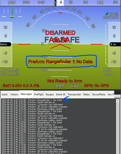

Unknown special characters are written.
And, Arduino’s RX Led flashes at the same time interval. And, when the Mission planner has set up, a message called Rangefinder 1 No Data is displayed.
the unknown characters are mavlink, there should be a line with the sonar readings on it too.
can you send a screenshot of the data from the adapter?
with it connected to a pixhawk serial port, check on mission planner for data, press CTRL+T then open mavlink inspector from the options, look and see if any rangefinder data is getting sent back .

The information seems to be confirmed in Mavlink Inspector.
But the Arduino serial monitor shows something strange. Is it because of the binary system?
But likewise, No Data
on Arduino serial monitor you are seeing the mavlink data followed by the serial print.
is current distance reading changing on mavlink inspector?
can you change line 57 to
  uint8_t id = 1;                              /*< Onboard ID of the sensor*/
can you set
rngfnd1_type: 10 (mavlink)
rngfnd1_orient : 25 (Down)
rngfnd1_addr: 1
Thank you friend.
Thanks to you, everything has been resolved.
