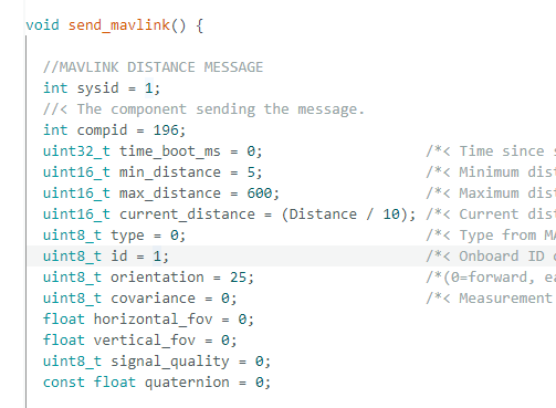

I’m currently trying to use TF02-Pro LiDAR sensor and GL042MT (Arduino / Mavlink) together.
TF02-Pro LiDAR to CUAV V5 Nano FC Telemetry 2 port.
GL042MT to CUAV V5 Nano FC UART4 port.
I connected and set it up, but it only reads sonar sensor data.
However, when I disconnect the sonar sensor, TF02-Pro LiDAR data comes in.
It seems like there’s some kind of data conflict.
How can I fix it?

is it the mavlink adapter you are using on the sonar? is the lidar configured as rangefinder 2? if you try and set it as rangefinder 1 then it will conflict with the sonar.
I did it like this.
I set the parameters.
RNGFND 1 β†’ TF02-Pro
RNGFND 2 β†’ Arduino + GL041MT
that wont work, the rangefinder mavlink adapter is set as rangefinder 1. you would need to change the adapter code to 2 for it to be rangefinder 2.
  uint8_t id = 1;                              /*< Onboard ID of the sensor*/
I think I’ve tried this too.
it wont work in its current configuration, you have the lidar set to rangefinder 1 and you have the sonar sending data to rangefinder 1.
int sysid = 1
uint8_t id = 1
Should I change both to 2?
