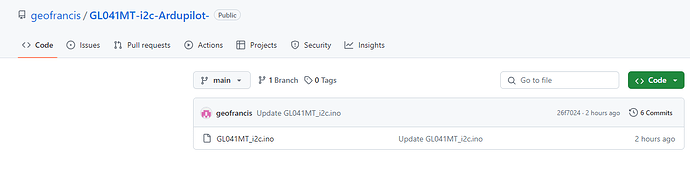

How can I add a mini sonar sensor GL041MT GL042MT to my ArduRover firmware?
try your GL041MT_Test to verify the sonar still works.
It works correctly.
Please refer to the picture.
I removed the startup print to serial, its the only extra line of code thats running. it should be line for line identical to what your example, as everything else is commented out
when you remove whats commented out its identical, thats why im confused as to why its not working

i2c transmission part,
If you properly combine the GL041MT related codes,
It seems to work.

Hi @Peter_Kim, @geofrancis ! Did you manage to get the i2c data for autopilot ?
basically the 115200 speed is causing softserial to conflict with i2c, so we were working on connecting the sonar to the hardware serial port to get around that issue.
my next step was to take the working example and swap the hardware and softserial ports, this will let us run the hardware serial at 115200 and the softserial at 9600 for printing the values. we can use it to get the sonar working with hardware serial, once that is working we can add i2c then disable softserial.
