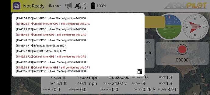

Things are working better but I can give it a shot. I use the Pix Racer pro almost exclusively. Was a early tester for Phillp Kocmoud.
Yes some odd pre pre arm issues after a voltage change battery swap 4s to 6s. I rebooted the compass cal and was able to arm but then got the twitch/oscillations that i could not tune out as normal. Normally would fix it. https://www.youtube.com/watch?v=2YzIqk1vcG4
I just got around to flashing the FC .
Didn’t seem to fix it. Also its is showing up as a f9p and its just the holybro m10. GPS is set to auto config both units.
@prsh8ya I’ve now reproduced the issue and fixed it. I’ve put a new firmware for you to test here:
http://uav.tridgell.net/tmp/copter-Pixhawk6C-bdshot-4.6.0-beta4-ublox-gps-test2.apj
please test!
@tridge That has fixed the arming issue for the gps. Thank you!!!
