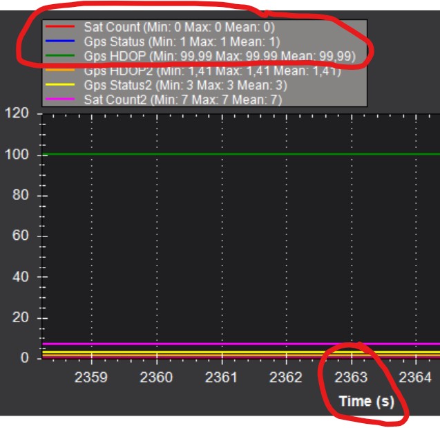

I have got two issues with ublox GPS yesterday with 4.6beta4
First, GPS can wait for a fix forever …
The other was a problem with set_home, what was not set on arm but much earlier, like on first fix or even at a boot.

There is definitely a problem with the M10S @tridge . I had a plane that was struggling to get satellites on its M10S on master, so I replaced it with a brand new one out of the box. After booting on master I waited 2 hours and got no (zero) satellites, then I flashed 4.5.7 and it immediately came up with 11 satellites.
