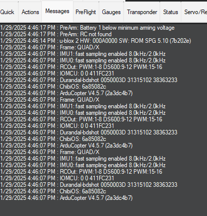

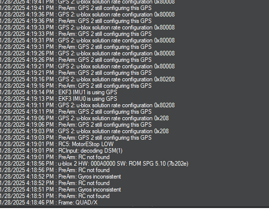

GPS still config error after updating to beta 3
This is the second quad that I updated to this beta version and I get this same message.
I am using different gps’s.
I just flashed 4.5.7 back and the gps error went away
I dont get that issue with 4.6 Beta 2 or 3 (or earlier)

29/01/2025 11:06:08 AM : EKF3 IMU2 is using GPS
29/01/2025 11:06:08 AM : EKF3 IMU0 is using GPS
29/01/2025 11:06:08 AM : EKF3 IMU1 is using GPS
29/01/2025 11:05:53 AM : u-blox 1 HW: 00080000 SW: EXT CORE 3.01 (107900)
29/01/2025 11:05:51 AM : GPS 1: u-blox saving config
29/01/2025 11:05:47 AM : Field Elevation Set: 57m
29/01/2025 11:05:47 AM : EKF3 IMU2 origin set
29/01/2025 11:05:47 AM : EKF3 IMU0 origin set
29/01/2025 11:05:47 AM : EKF3 IMU1 origin set
29/01/2025 11:05:37 AM : GPS 1: detected u-blox
29/01/2025 11:05:37 AM : GPS 1: probing for u-blox at 230400 baud
29/01/2025 11:05:29 AM : ArduCopter V4.6.0-beta3 (110acc96)

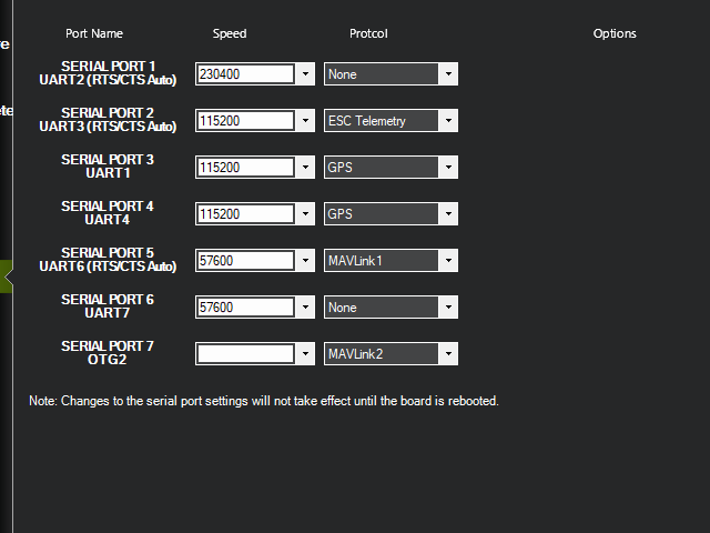

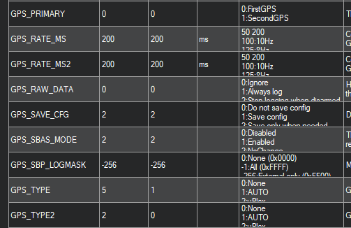

What are all of your GPS and SERIAL settings?
@xfacta Are you running single or dual gps units?
I’ll have to get my serial settings tomorrow and report back.

Serial ports should be:
SERIAL3_BAUD,230
SERIAL3_OPTIONS,0
SERIAL3_PROTOCOL,5
and same for SERIAL4 - Ardupilot tries all valid baud rates until a GPS unit responds (or not) unless you know your GPS unit will only do a specific baud rate.

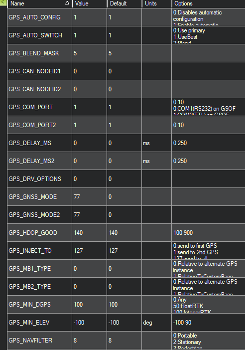

Your GPS_GNSS_MODE2 should be 5 or 65 - it wont do all those other constellations at once.
I tried both baud rates but didn’t change anything.
I’ll try the mode and see if that changes anything

Those three logs are no different for GNSS-related parameters. I did not see a config error message.
Try using GPS1_GNSS_MODE,5 since the first GNSS unit is erratic with it’s update rate.
Probably use GPS2_GNSS_MODE,65 for the other.
If that update rate is affecting the position controller you could set PSC_VELXY_D,0.25 to settle it down a bit.
