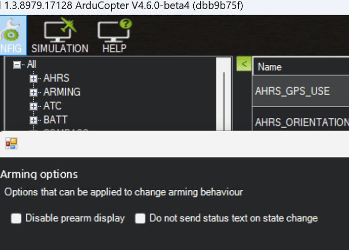

there’s no such option
Hi @twistedwings,
Thanks for the report. It looks like our parameter descriptions haven’t been updated with the changes from -beta4. -beta3 is there in the drop-down but not -beta4 yet. I suspect it will appear given another day but I’ll ask some of the other devs like @peterbarker and @khancyr if they know.

Same problem here, I cant do motor checks indoors. Arming_options looks like this over here:
The new parameter is actually ARMING_NEED_LOC
If you dont touch it, motor tests all work as per normal - I just tested it.
I set it to 1 and disabled my GPS (since it was working inside just fine) , rebooted and Messages indicated waiting for Home and all the expected things for requiring a location. FENCE settings have nothing to do with the motor tests either, only hardware (un)safety switch.
I was still able to do motor tests just fine
