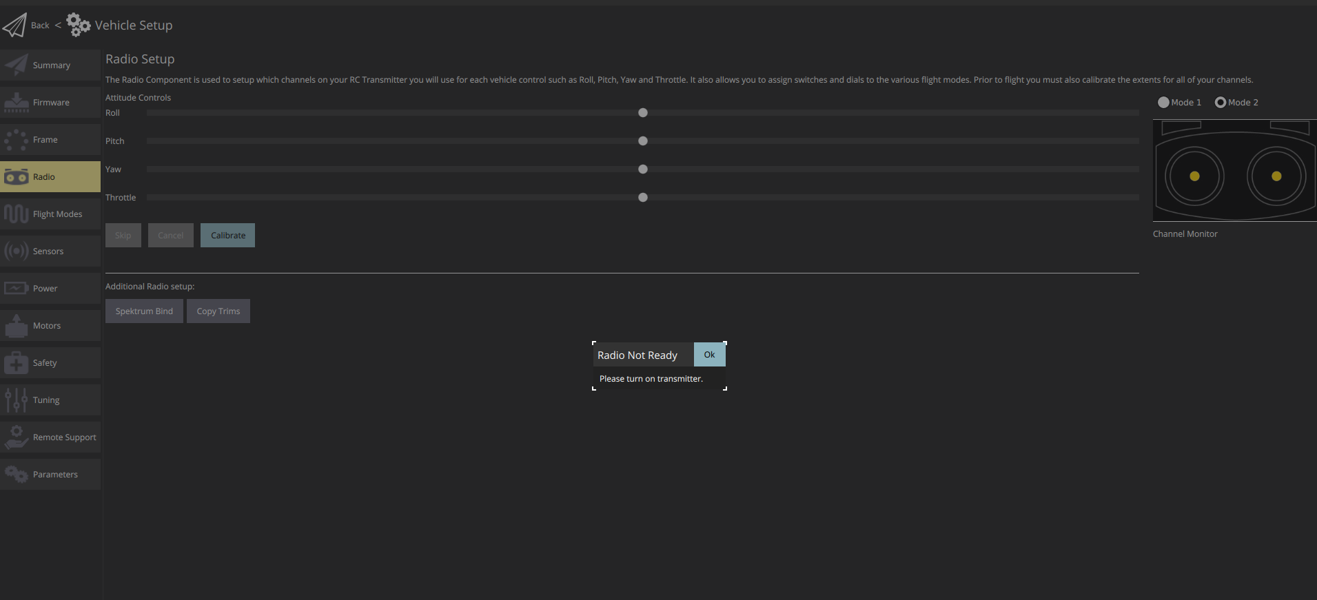

I was not only for the motors. Now I remembered that I could not configure the RC, so I did not receive the controller inputs either. I will give a try and then I inform you.

It is basically not detecting any transmitter…

First, are you saying that RC is not working? I was confused by your comment about not detecting a transmitter. If not then Bdshot is not the priority.
When the BDShot Firmware is installed, I do not receive nothing from the RC and when I press the button calibrate I get this message from QGC:
Check that if serial port is changed when you change firmware
According to the manual RX6 is still Serial7, I mean, nothing is mentioned about that change.
