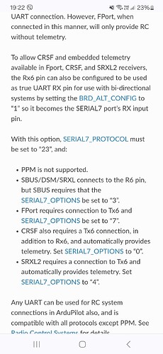

OK, let’s backup. You need a working RC before worrying about telemetry.
BRD_ALT_CONFIG,0
SERIAL7_PROTOCOL,-1
SERIAL7_OPTIONS,0
Restart the board after making the change.
Does RC work now in Mission Planner (forget about QGC for now)?
Yes I have, but it is disabled from the FC. So it shouldn’t be a problem.
With backup I understand you mean to return to the NO bdshot firmware right?
If so, before I changed to bdshot firmware the RC works perfect. And the last time I tried to use bdshot firmware, when you suggested to me the RC didn’t work neither. And when I returned to the NO bdshot firmware begins to work again.
Tomorrow I will test with that configuration. Now I have not access to the drone. But I expect that without bdshot firmware the RC will work.
We need to find why Rc doesnt work with bdshot firmware, are you using SBUS connection to receiver? You can stay with normal firmware and use FFT insteed of Rpm telemetry but from my experiance rpm notch works best for smaller crafts.
If you are on Sbus you configure it like this, and when you do update to bdshot you shoud check parameters special brd_alt_config.
No. Just make those changes.
If you want to revert back to non Bdshot after checking this that’s up to you.
Nothing guys, my fault, sorry. The receiver robbe r6107sp works only with PPM and at this moment I can not use a different receiver. So, according to Matek using bdshot is not possible to use PPM…
I should return to the NO bdshot firmware.
