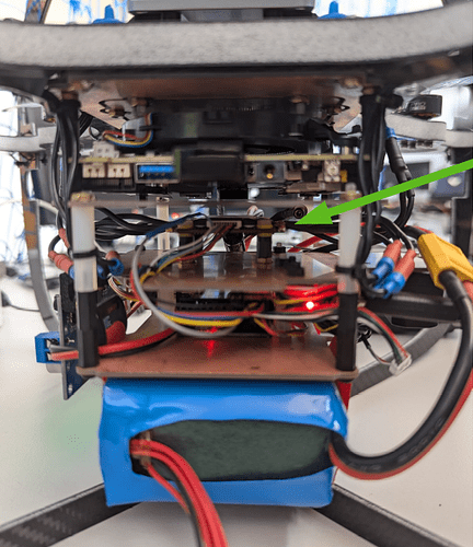

Recently, we build a quadcopter with a custom frame and equipped with:
Matek H743 Wing V3
T-motor Velox V45A V2 (4 in 1 ESC)
4x T-motor F80PRO 1900KV
6S2P Li Ion battery of 9000 mAh
TFmini plus rangefinder
The whole quadcopter weighs about 2300g (it is also equipped with LiDAR and an onboard computer). You can see the copter in the photo below:
After some calibration, thanks to some friends of this forum, I found that the problems I had (power loss and even stop motors during a flight) are due to a ESC overheating. It reaches 140 C in about three minutes and the ESC starts its safety procedures. I touched the ESC and of course is very very hot. I don’t exactly know if is possible that with this configuration (current is about 35-40A) is normal to reach that temperature. Is it maybe because a defective ESC or hardware configuration (the ESC does not have a lot of airflow and need to be placed in another place) or is just parameter configuration?
In the next photo you can see the location of the ESC:
Thank you in advance guys!!

Hard to tell in the photo but the esc looks to be very close to the plate above it perhaps trapping heat. Is that right?

single ESCS on the arms would fix the overheating as they would get plenty of airflow.

The props are AzurePower Race Propeller 6145 Tri-blade . Yes, I moved the ESC but I wrongly think that leaving more space in the bottom part would be a good idea, wrong…
Definetely I will try to leave the maximum space I can in the upper part.

And yes, the space in the upper part in only about 4mm. I will try to leave more space, and test again.

I was suggesting to leave more space on top, on the top of Esc are heatsink and temparature by nature are going up. You can also add a small fan on top of heatsink to lower temps, but that is going to make some other (problems) if fan is too much vibrating. Do you have good quality wires going from Esc to Motors? Low quality wires have greater resistance and also can increase a Esc tempararure.
Yes I understood, I moved the ESC in a position a bit more forward (not just in the middle of the panels) and leave some extra upper space, as you can see in the image.
Now the temps seems to be a bit more controlled and stabilize at 120C. But I’m not sure if this temperature is still too much high.

I’m am thinking in moving the ESC full outside of the structure ant vertically attached. Do you think is a good idea?

I think Esc is more then covered with airflow now. Im not sure what else can you do now other then add fan or change esc to one with more Amps. Pretty sure that motors pull’s alot of current. Do you have calibrated current monitor properly so you can be sure about Amp draw?
If you ran eCalc as you said you must have seen the warning about max current over the limit for that ESC. As @geofrancis suggested earlier you should have selected a higher rated 4-in-1. 120C is cooking pretty good, that may degrade the ESC quickly.

I will try to change the ESC position again to see if better results in temp are reached. If not, we should buy a better ESC or maybe individual ESCs.
Thank you for your help!!
In your case individual ESC’s may be the better choice. Not as clean looking but practical.
If you can find suitable ones that is. These days the selection is a bit limited. I see DYS has some AM32 units that look interesting but I have never used their products.
One question, in the case the motor is located oriented down (like we have the front motors), so the individual ESC would be situated in the arm being above the motor and the props, the airflow would be sufficient?
Thanks in advance!!
I’m sure it would be. I think your only problem, other than under capacity, is the heat trap.
