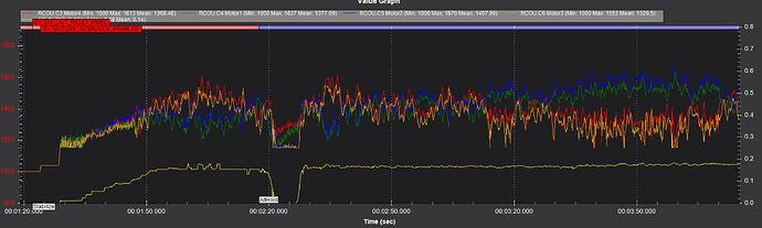

According to the logfiles of ardupilot I am hovering at 17-20% thrust. Of course I don’t know if that is the true.

Let’s back up and look at reality. Antoni’s craft in a hover is as shown on the following graph. There is no lack of thrust, Ctun>Tho at hover is around 18% as he says. Average Rcoutput at hover is ~1400us. The thrust/weight on this craft is fine. He has a ESC cooling issue with the capacity of the ESC he has.
