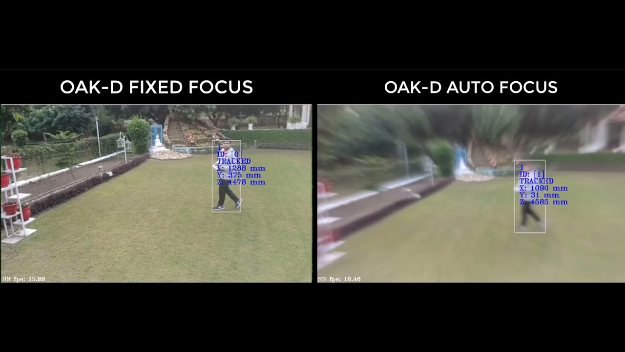

I would also like to mention some of the issues that I have faced with the camera: There are issues with focusing on the RGB camera when it is put in high-vibration environments. This is being addressed by Luxonis by launching a “fixed-focus” version of the camera in the near future. A comparison of fixed focus vs auto focus can be seen here:
The other issue is that the quality of the Depth Frames isn’t as good as the RealSense cameras. They definitely have more noise. I have found workarounds, though. The Luxonis team plans to launch OAK-D-PRO, which should again improve this.
