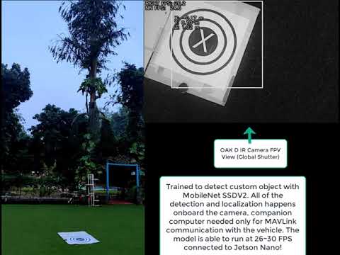

Precision Landing:
I trained a custom MobileNetV2 model to detect this target:
You can theoretically train any number of such targets. In my experiments, I found that the relatively small marker could be detected at 10+ meters. This range can be further significantly improved by either increasing the size of the marker or training the model a little better. The future firmware of the OAK-D’s will probably also have the ability to detect AruCo markers (or similar markers), which can be additionally used for more reliability. The setup and instructions on how to use this are given here:
