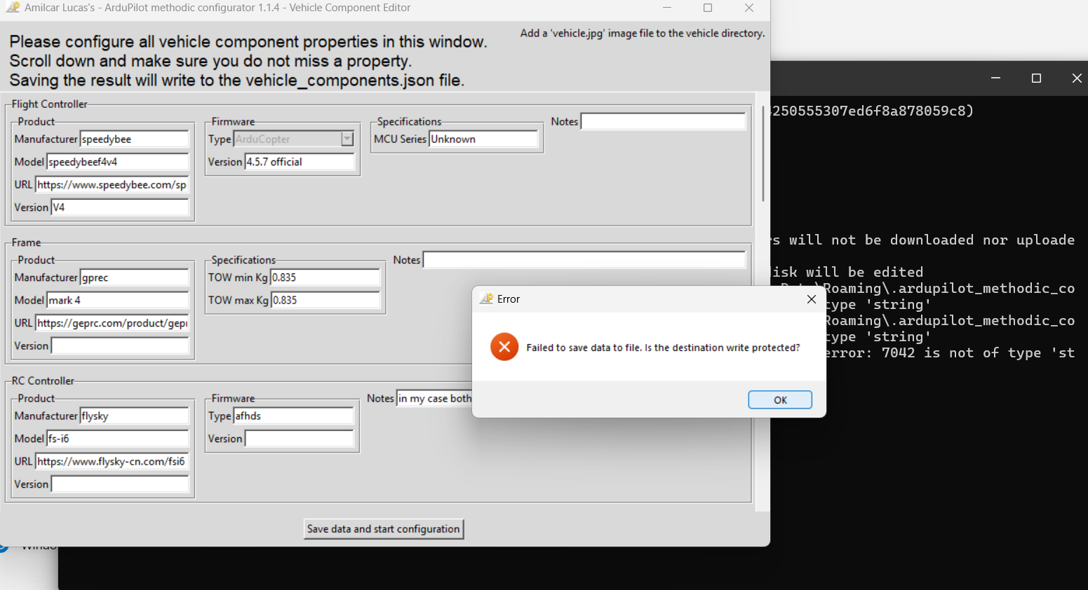

here is the zip file:
and by the way the write protection error still exists in 1.1.4

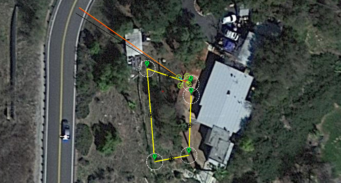

Hey I sorry your having issues, if you like i can help you make a 7" quad as seen in the video.
I don’t have any issues. The poster had plenty. The worst of which you can see in the 1st reply. I wasn’t guessing. I graphed the log, reviewed the pertinent metrics and gave a reply that accurately described the problem and the reason for it.
I have to admit the oscillation is a odd issue. I get oscillations one out of 20 builds. I just use the twitch slider and it’s fine. Also I’m able to have a setting for hyperflight" light twitch" for flying next to trees or a non hyperflight for open spaces. The 7" video I showed can fly my very tight property using waypoints go around a tree like a pro.Obviously am am satisfied with the results.
@bhargava_ram_alla I looked at the files you posted and fixed the save issue.
Please update to v1.1.4 or to the development build and use the following fixed files:
mark4build.zip (176.7 KB)
When configuring the vehicle you must always skip step 16 with this particular template!
Redo steps 11 and 14. After that continue normally on step 19.
thanks @amilcarlucas i will use the fixed files but the latest version of methodic configurator has the same error.
You need to use the development build, not the latest stable.
Those are two different versions.
And on the background window looks to me as you did not loaded the files from the .zip file I sent you.
i downloaded the dev build now it is working smoothly
