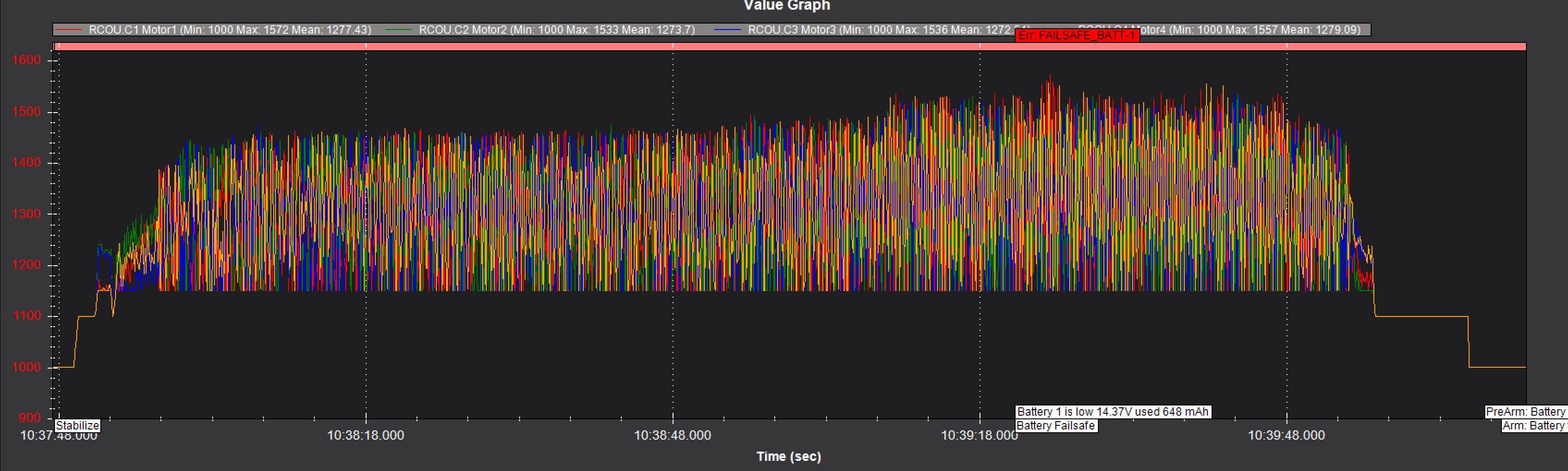

Drone is continuosly vibrating in flight and when i change to alt hold mode the drone is coming down
when i arm the drone and increase the throttle the drone start to vibrate but still it flys but with vibrations and when i reach to a certain altitude i changed mode from stabilize to altitude hold mode then it descends downwards, i checked the condition of the props they are brand new and here is the drone param list and my flight data:

If you want to look at a metric that is indicative of the problem here you go:
The infamous Output Oscillation.

The infamous Output Oscillation bug. Seems to have come back. Probably best to update firmware,

There is no bug, this is simple tuning.

Whatever changes you made did nothing to address the problem. You have output oscillation. It’s not a bug, it’s tuning. Anyone that can graph a log of the RCouputs can see this. Certainly a Developer can see this.
Bugs, GPS problem, IMU temperature calibration; none of this is relevant to the issue at hand which is basic.

I could give you several Parameters to change to fix this problem, that’s how basic it is. But, at your level of knowledge you should follow the Methodic Configurator.
