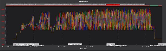

update: i tried arduipilot methodic configurator but it is very complex for me so i entirely formatted the fc and reinstalled the ardupilot again so now i used chimera 7 configuration values and changed them a bit(pid values) now the drone is vibrating again and oscillations continue here are my log and parameter files:

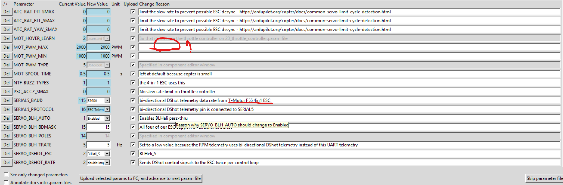

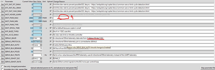

  • so first thing i am confused is why is the reason asked(is there any generative ai model impl so that model can understand what we trying to interpret)
  • the next thing is i already given my entire parts description in the first step but still it is going with default one eg: During the begining phase i mentioned my esc as speedybee 60a esc but when i go further in the process of tuning it is showing me tmotor f55

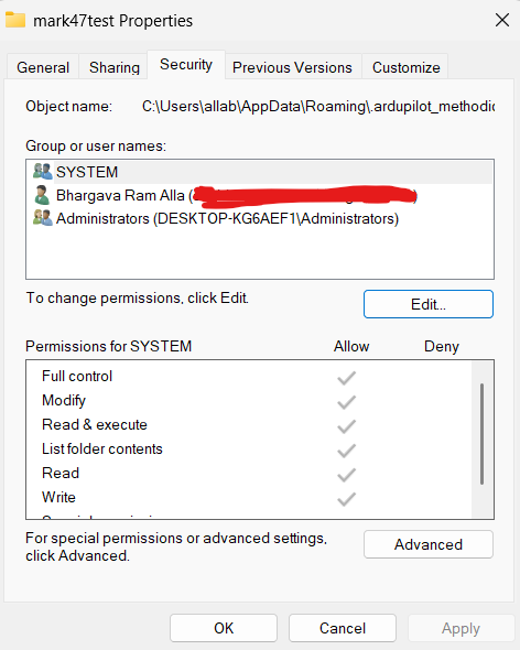

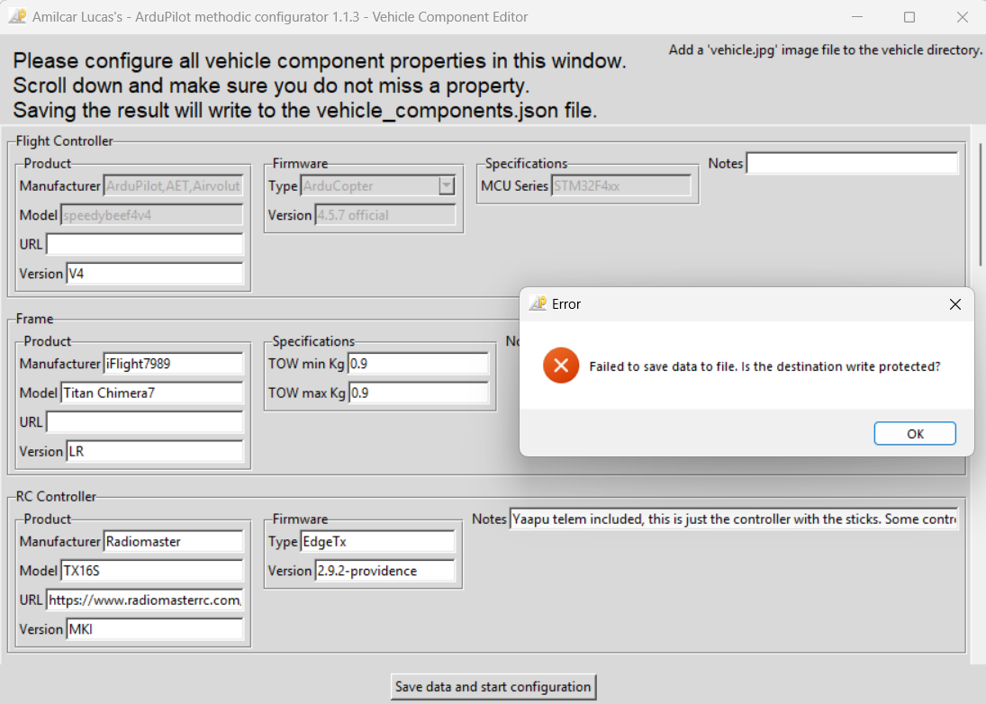

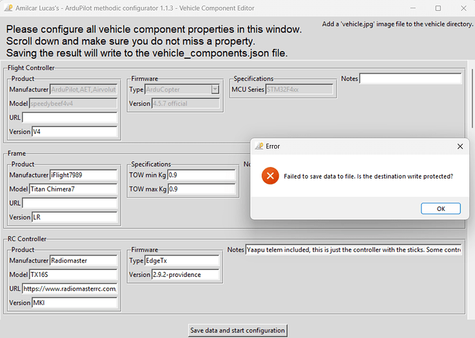

  • I think it is not saving the parts list i am getting write protection error(i even tried using administrative mode)here is the image of the error

  1. That is from the original vehicle template, you need to edit those fields. Those are just guidelines/examples of what/how to fill in the values. You still need to fill them yourself, unless they are greyed out. Greyed out field are automatically filled in and you do not need to change them.
    Like explained in the popup: you need to edit ALL New values and their change reason to meet your vehicle

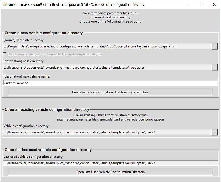

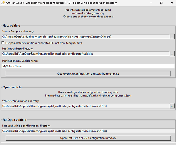

  2. Post a picture of the vehicle selection window. I want to see the name of the vehicle directory you gave, and it’s file path. The file path needs to be writeable.

  • here is the window image
Thanks for your questions, I now improved the change reason mouse-over tooltip:
And I think you found a regression bug with the vehicle directory, I fixed that and did a development build that you can test.
I fixed the fail to save data regression. Please update to v1.1.4

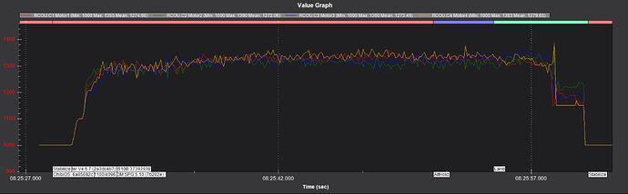

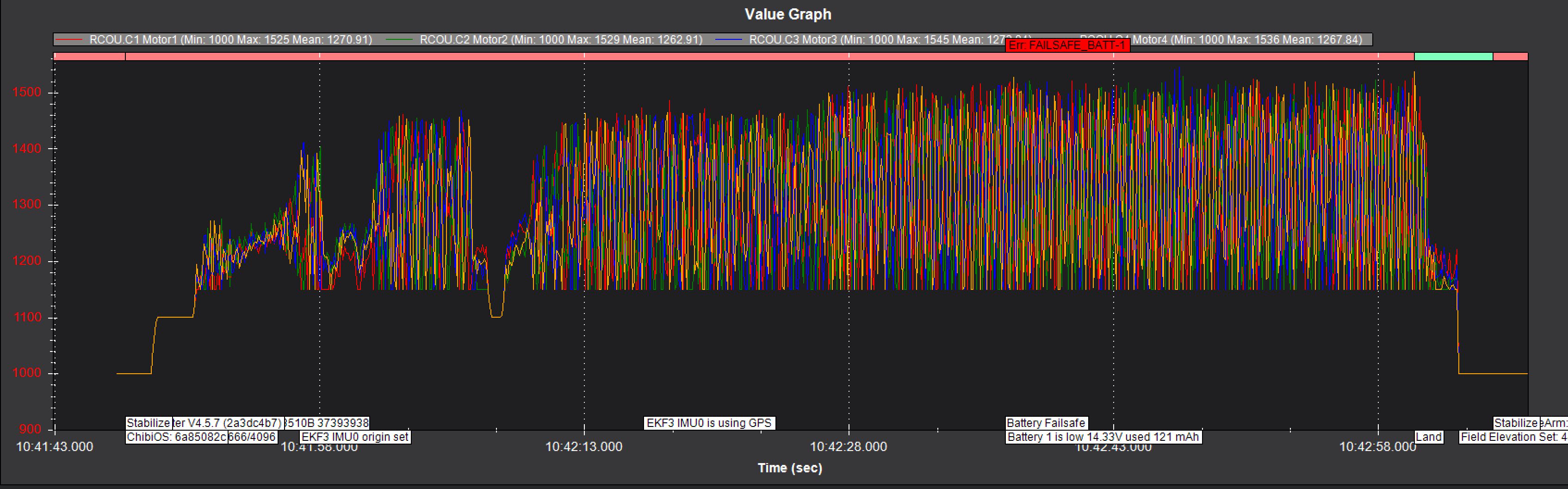

hi @amilcarlucas so today i degraded to methodic configurator version 1.0.15 in this version the save feature is working and i am able to successfully tuned the quad, when i tested my drone for a flight there are no vibrations now and also i examined the rcou graph the oscillations are less compared to the previous days flight data but still i dont know whether these oscillations are normal or not, i will attach my log file. The only thing that is not working is when i change from stabilize to althold the drone alt is descending and eventually lands.
Update to ArduPilot Methodic Configurator 1.1.4 and fix your notch filter settings. That BW is way too high and you have too many notches.
Post a .zip file with the files generated by the configurator.
That’s because your hover throttle is really ~.120 (or maybe less) and you have it set to .200
I guess he did not do step 20 yet.

Let’s review for the benefit of anyone that comes across this and thinks that default parameters are suited for a 7" craft. Or practically any craft for that matter.
Before (under a bad assumption):
After (with some very basic tuning suited to this size craft):
