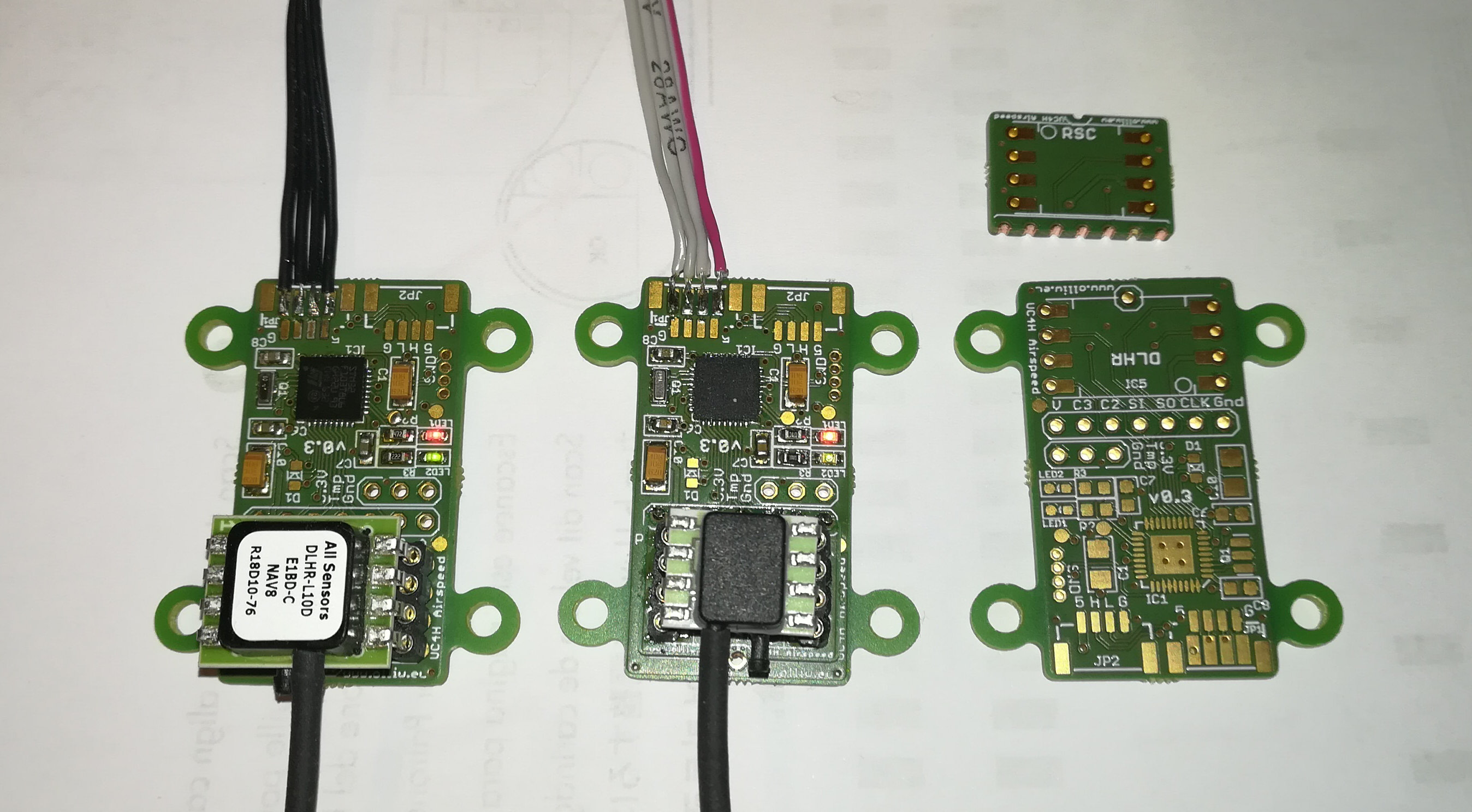

UC4H Airspeed v0.3 arrived
6. Dez. 2018
The new UC4H Airpseed v0.3 PCBs just arrived, so I had to assemble two of them. The ā€žnewā€œ feature of the v0.3 board is that it allows installing different differential pressure sensors using a small add-on PCB. Per default it hosts a DLHR sensor, and I also did one hosting an RSC sensor. I plan to do some comparative tests of these two sensors.

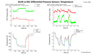

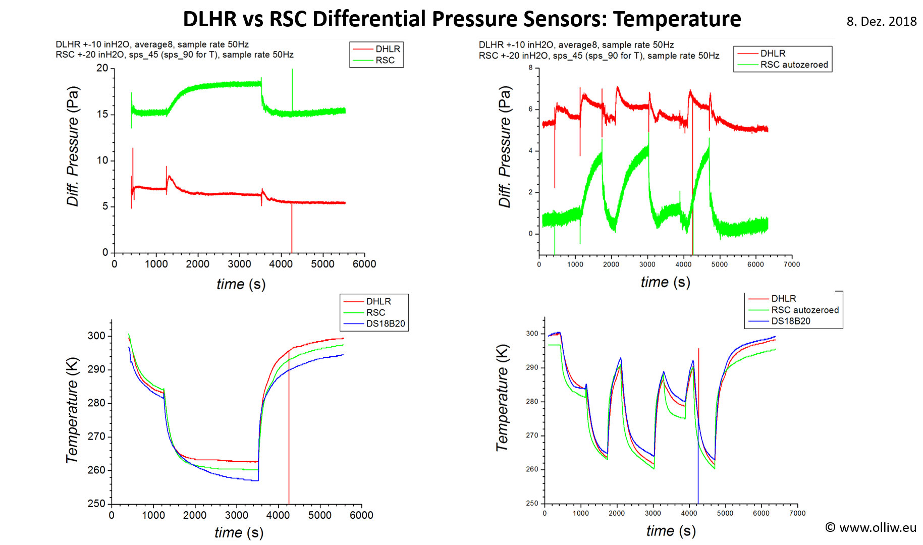

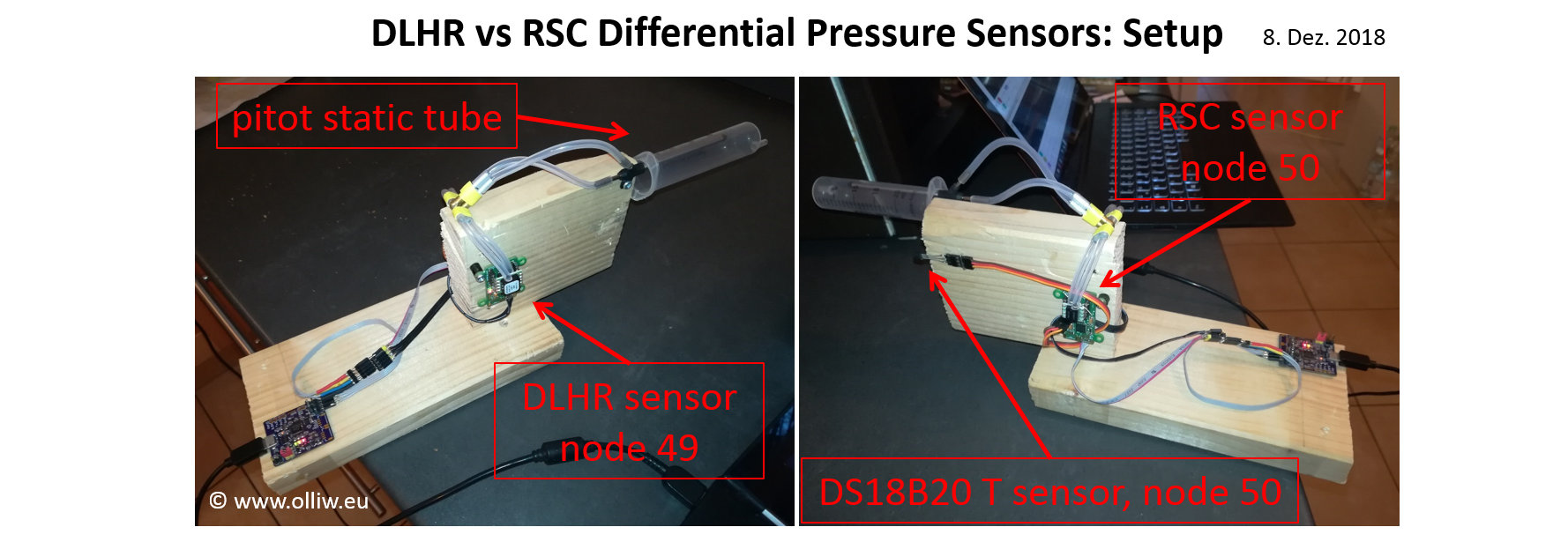

Differential Pressure Sensors: DLHR vs RSC Comparison II
8. Dez. 2018
Both the Honeywell RSC Trustability and AllSensors DLHR differential pressure sensors are very promising candidates for application in state-of-art airspeed sensors. I’m interested in understanding better their relative advantages. So, I’ve added support of the DS18B20 temperature sensor to the UC4H Airspeed node firmware, for independent temperature measurement, and built a setup there both sensors are connected to one and the same pitot-static tube. In this first set of experiments I focused on the zero-pressure offset, with respect to its noise and dependence on temperature variations. For achieving different temperatures I put the setup repeatedly in ambient air, in the fridge, and the freezer.
The RSC sensor datasheet provides an autozero algorithm, so the data were taken first without this being done, which shows the ā€žrawā€œ offset and then with autozero applied. The autozero procedure is not simply an offset subtraction, so it was interesting to see if it does anything.
In the comparison of the data the different pressure ranges of the two used sensors has to be considered. RSC: ±20 inH2O, DLHR: ±10 inH2O (±20 inH2O correspond to ±5000 Pa).
The noise analysis reproduces the findings I’ve obtained earlier here. The temperature dependent results indicate a significantly better offset stability of the DLHR sensor.

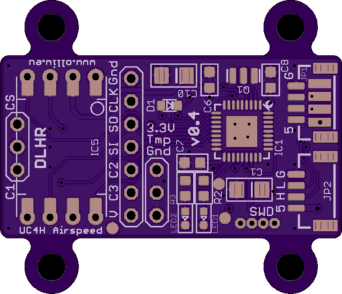

C4H Airspeed v0.4 released
8. Dez. 2018
The v0.3 version of the UC4H Airspeed node PCB is working very well, but I realized I easily could do a minor but significant improvement which furthers its usage range. So I did that, yielding the UC4H Airspeed v0.4 version. The design of this node was a long story now, and went through 5 different versions. However, the v0.4 version I expect to last for quite some time, so I just have released it. The Eagle files and other material you’ll find as usual in the github repository.

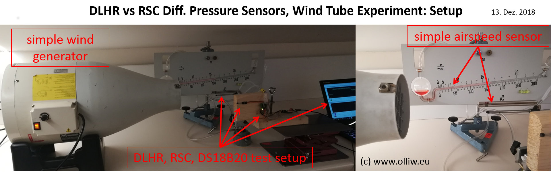

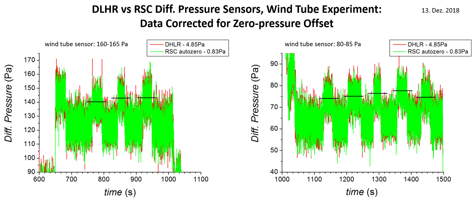

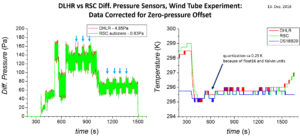

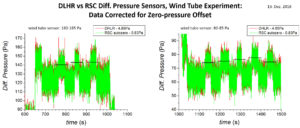

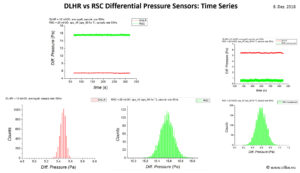

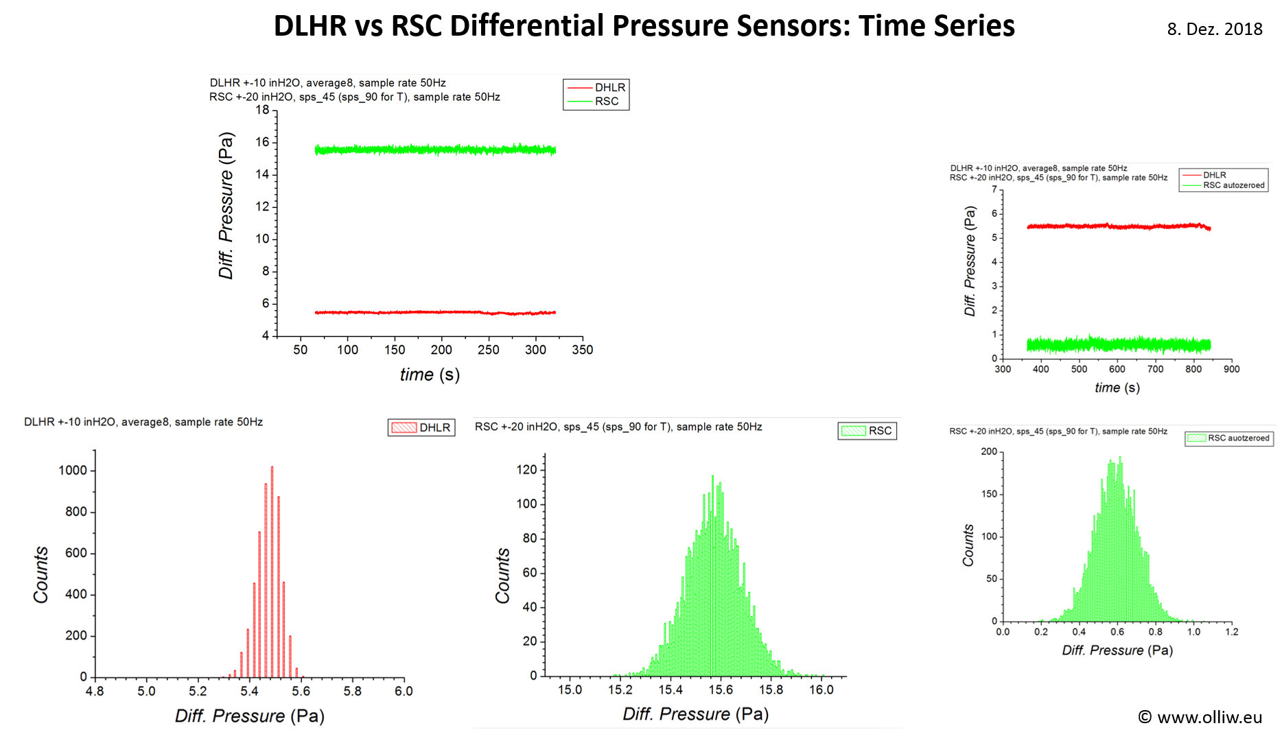

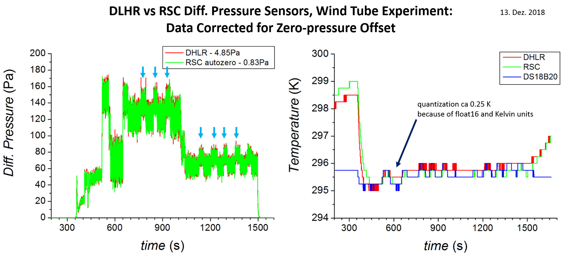

ifferential Pressure Sensors: DLHR vs RSC Comparison III
13. Dez. 2018
In continuation of my efforts to evaluate the Honeywell RSC Trustability and AllSensors DLHR differential pressure sensors, I’m trying to also get some ā€ždynamicā€œ, actual airspeed data. An article by xDevs.com reported a scale error of ca 5% for the RSC sensor; the DLHR was found to be within specs. Unfortunately, I don’t have the means for reliable measurements. I did had the chance to use a simple wind generator with airspeed meter. It was clear that it won’t be very accurate, but I thought it might be worthwhile to use. I was wrong.
The setup and recorded data are shown below. The DLHR data I corrected by subtracting an offset of 4.85 Pa, and the RSC data by subtracting 0.83 Pa. There is some info in here: The DLHR zero-pressure offset reported some days ago (here) was ~5.4 Pa, which implies a ā€žzero-offset stabilityā€œ of ~0.6 Pa. For the RSC the offset was ~0.6 Pa, and now is 0.83 Pa. With that correction, the data of the RSC and DLHR are pretty consistent – within experimental error – which is pretty low here as seen by the huge noise in the data with the wind turbine on. A further point to note is the quantization in the temperature data of ~0.25 K. The resolution of the temperature sensors themselves is much better than that. The 0.25 K comes from the airspeed UAVCAN message, which uses float16 and Kelvin as units; the offset of 273.14 K significantly cuts down the resolution which would not happen with Celsius. This is just another example of the general observation that the UAVCAN messages of the standard DSDL set are very poorly designed. I also tried to ā€žcalibrateā€œ the RSC/DLHR against the simple pitot tube. The reproducibility was some few m/s, but a clear mismatch has to be noted. For two wind speed settings the simple pitot tube was measuring 160-165 Pa and 80-85 Pa, and the RSC/DLHR sensors were reporting 140-145 Pa and 75-80 Pa. Clearly, this experiment wasn’t even close to accurate enough to draw any conclusions as regards the scale accuracy of the RSC and/or DLHR sensors. I need to find a way to do better. LOL.

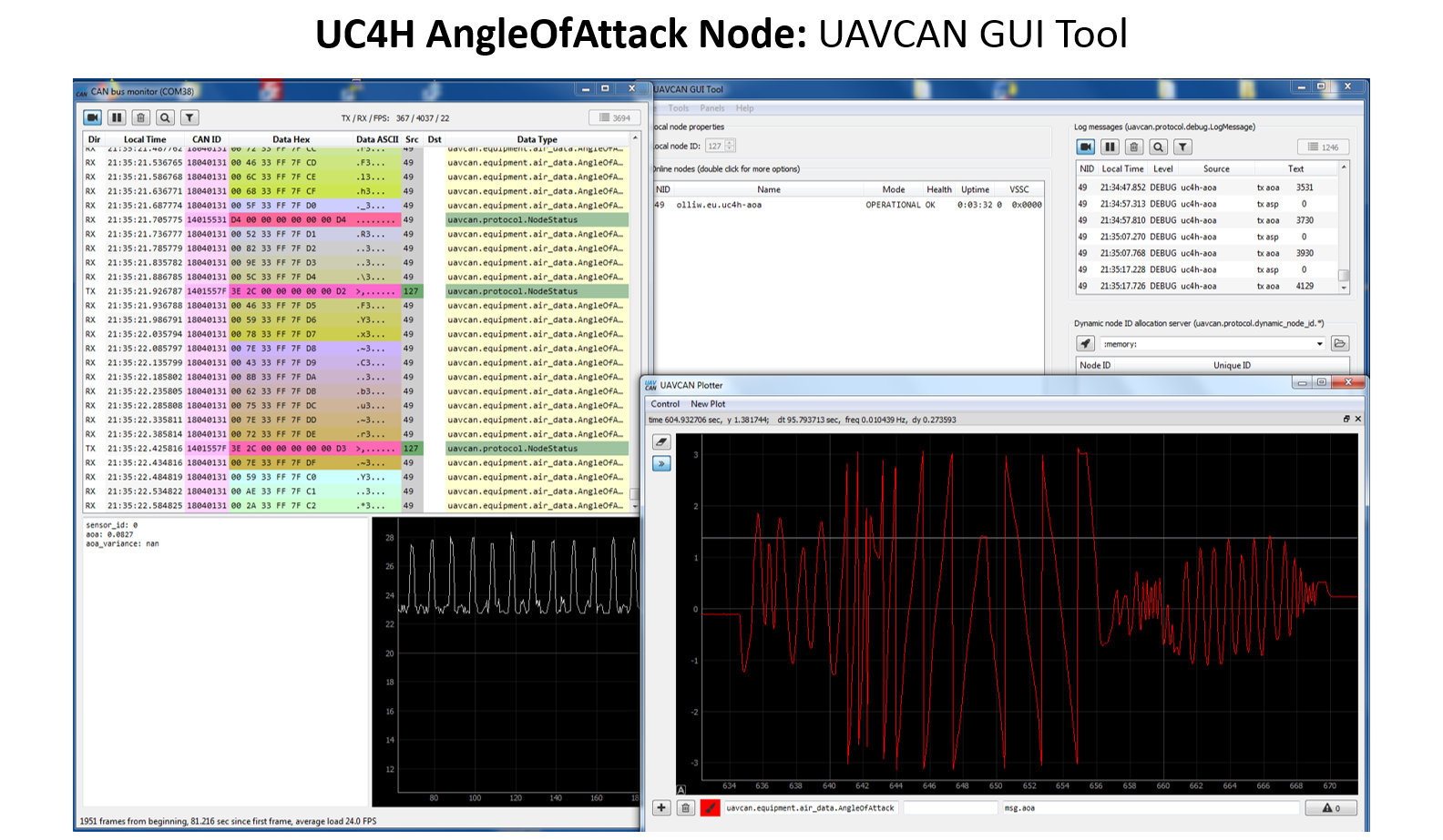

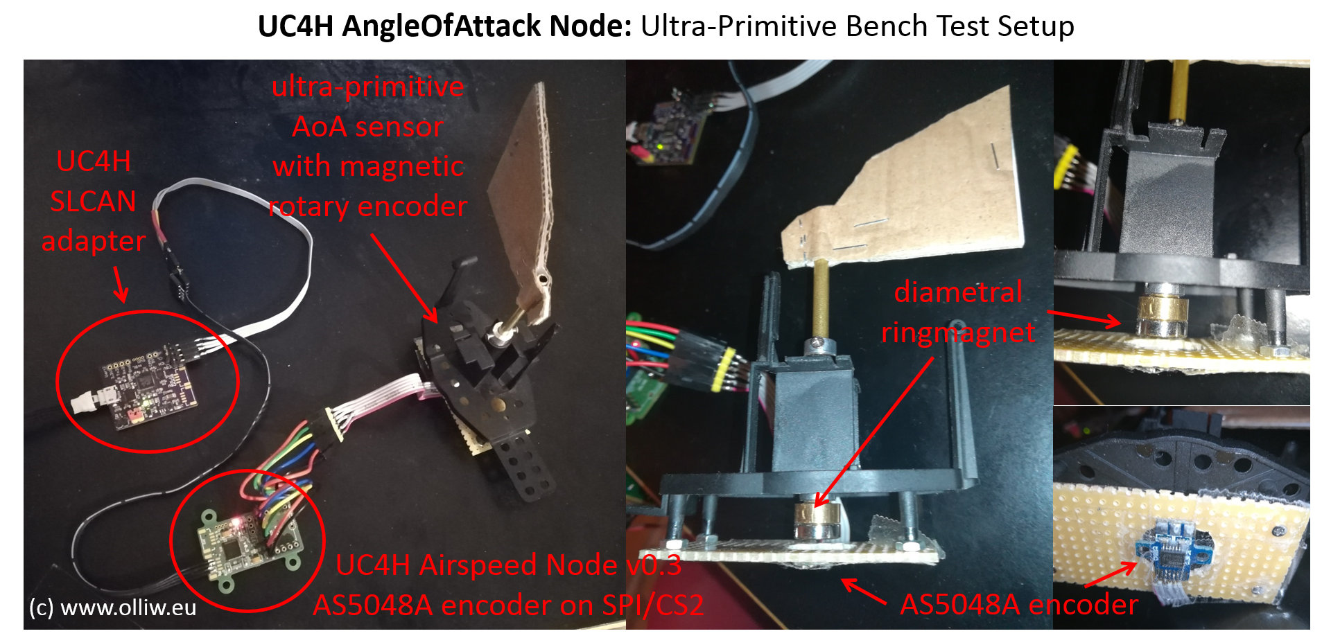

UC4H AngleOfAttack Node
15. Dez. 2018
The second SPI port on the UC4H Airspeed Node needs some usage, right? So I did this little, quick addition, for the sake of the fun, and because I could. LOL. Thanks to the T-STorM32 project I was already familiar with magnetic rotary encoders, such as the TLE5012B or AS5048A. I had the code pieces and hardware pieces available; I ā€žjustā€œ had to put them together. The result you see below. Please don’t tell me that this is a very crude setup mechanical wise, I know this You are welcome to do better. The good message: If you decide to do so, you now get a UAVCAN AngleOfAttack sensor. Maybe I do a test-flight with the AoA sensor mounted on a copter … not that this makes sense, but … it’s fun. LOL.

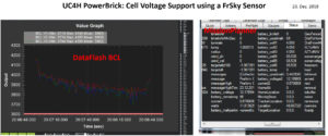

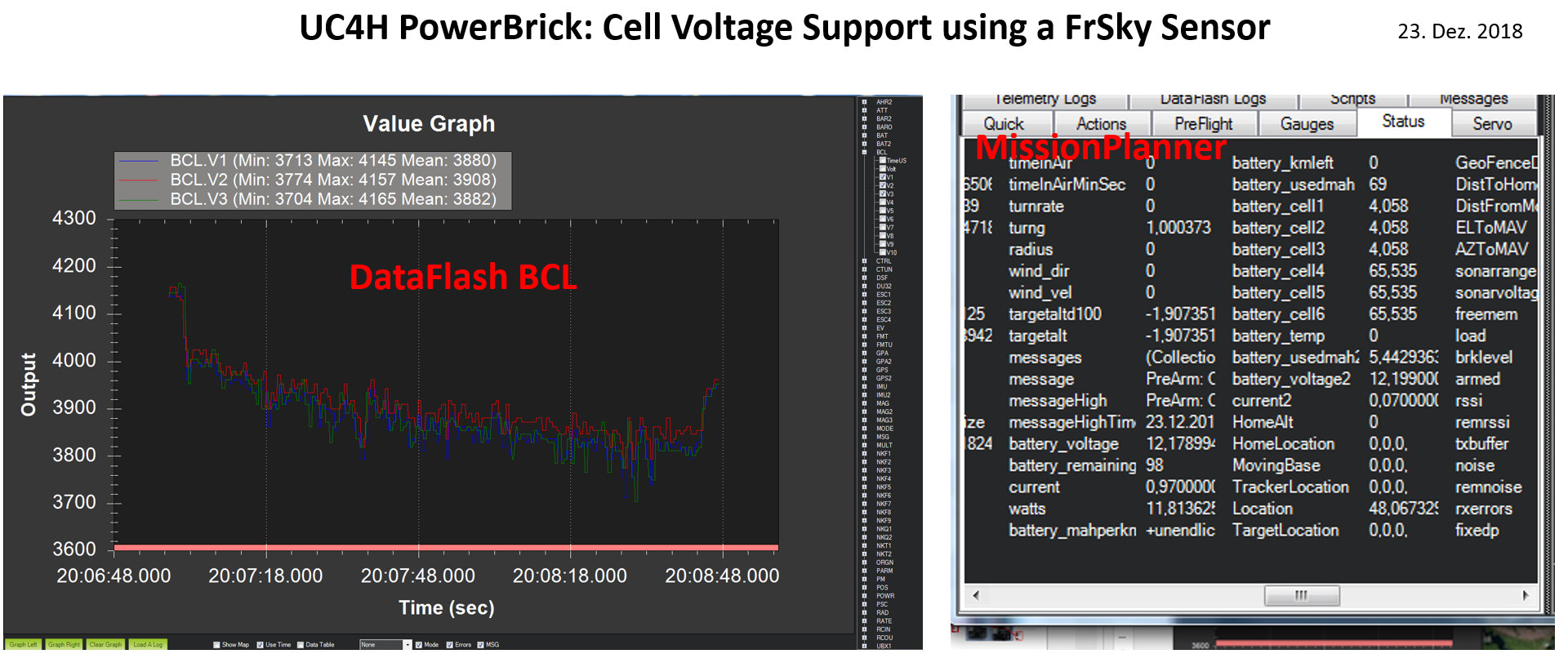

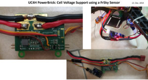

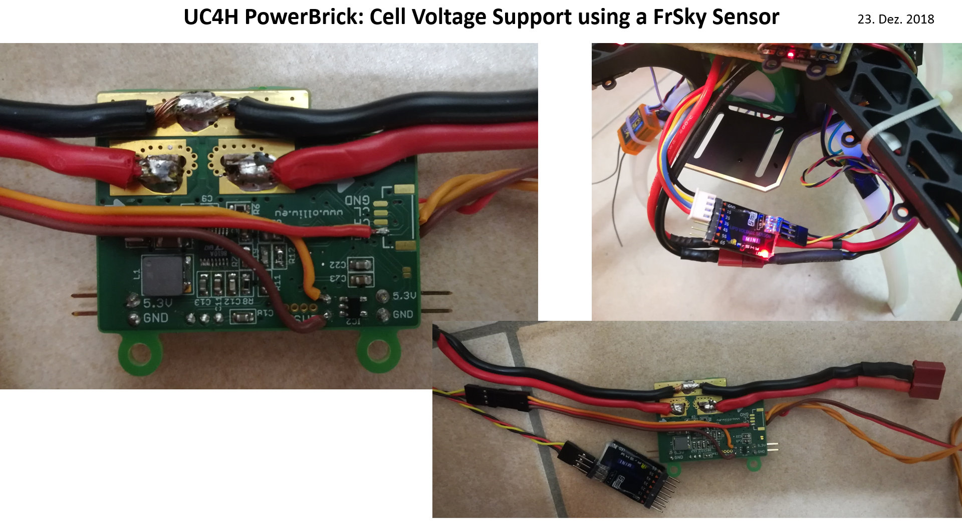

UC4H PowerBrick: Cell Voltage Support by using a FrSky MLVSS
23. Dez. 2018
One feature which was missing so far was monitoring of the voltages of the individual cells of the battery. I was actually pondering about this for a while, and how a solution could look like. I didn’t wanted to have the required additional electronics on the UC4H PowerBrick board, since it would make it bulkier. So I ended up thinking that if a FrSky lipo voltage sensor (MLVSS or FLVSS) is good enough for many it should be good enough for us here too. The advantage: It is readily available, relatively cheap, folks are used to how to use it, and anyone can decide freely if she/he wants to add this feature or not. Gladly, I had put a solder pad on the UC4H PowerBrick, which I now could use to connect to the FrSky sensor. Also, gladly, I had prepared the uc4h.GenericBatteryInfo UAVCAN message for cell voltage support. So, adding respective code to the PowerBrick firmware and the BetaCopter code wasn’t very difficult. And this is the result:
One disadvantage of the FrSky sensor is that it is very slow. For a 3S/4S cell it provides a new data set only every 0.6 s. However, it’s main purpose is to detect battery issues, and this should be good enough, right? And after all, this is the same sensor everyone is using so happily
I am of course planning to design a new PCB for the UC4H PowerBrick, which offers a FrSky S-Port port. I in fact started already, but this will take time LOL.

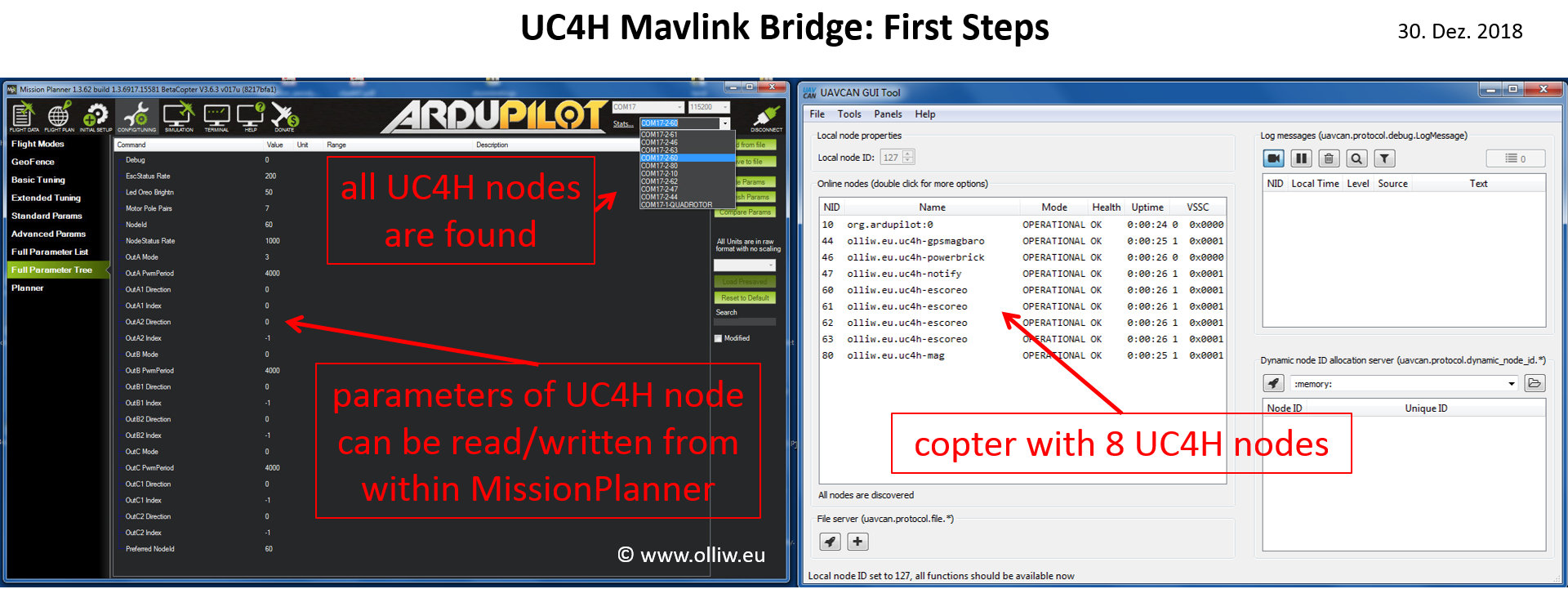

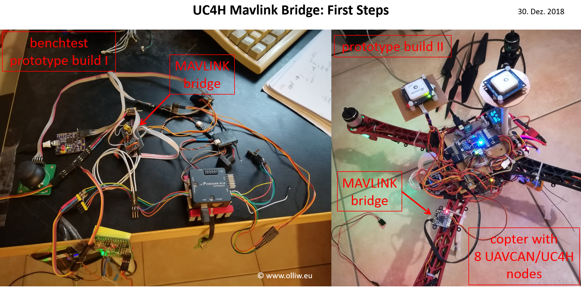

UC4H Mavlink-Bridge: First working Prototype
30. Dez. 2018
Another feature which was badly missing is the possibility of configuring the UAVCAN nodes seamlessly in a user-friendly way with ā€žArduPilot toolsā€œ, i.e., without the need to connect an extra SLCAN adapter and use special software, such as the UAVCAN GUI Tool. I’m not claiming to have solved that completely now, but this might be a significant step forward.
As regards configuration of parameters, a solution has in principle been defined several years ago as UAVCAN-MAVLink bridge, see here (and it appears to be implemented in PX4 since 2016). As usual with UAVCAN, ArduPilot is behind, and doesn’t have anything of this. Interestingly, MissionPlanner in contrast has already some support!
In principle, the MAVLink bridge should be part of the ArduPilot code, but this I couldn’t yet achieve. However, I could do it with a ā€žpiece of on-board equipmentā€œ, such as a general-purpose UC4H node. As usual with UAVCAN, the UAVCAN messages have not been well designed, which results in some not-so-nice issues code-wise and makes it trickier and more resource-hungry than needed. I guess I’m going to add my own UAVCAN messages. Anyway, a first well-working prototype I have now completed:
Finally, I have to say that I’m not convinced that the UAVACN-MAVLink bridge concept is the final answer. An alternative approach would be an integrated on-board SLCAN adapter, which would decouple the development of the UAVCAN configuration tools from the ArduPilot development, which would be much more efficient workload-wise and likely would give the user much better tools. I guess I’m going to try this approach too.

UC4H Mavlink-Bridge II
2. Jan. 2019
The UC4H MavlinkBridge has matured. It now also has passed flight testing, i.e., is ready for prime time. A short demo video:
Many thanks to Michael_Oborne, the MissionPlanner maintainer, for having swiftly added some UAVCAN Interaction features to MissionPlanner. Thx, sir!
