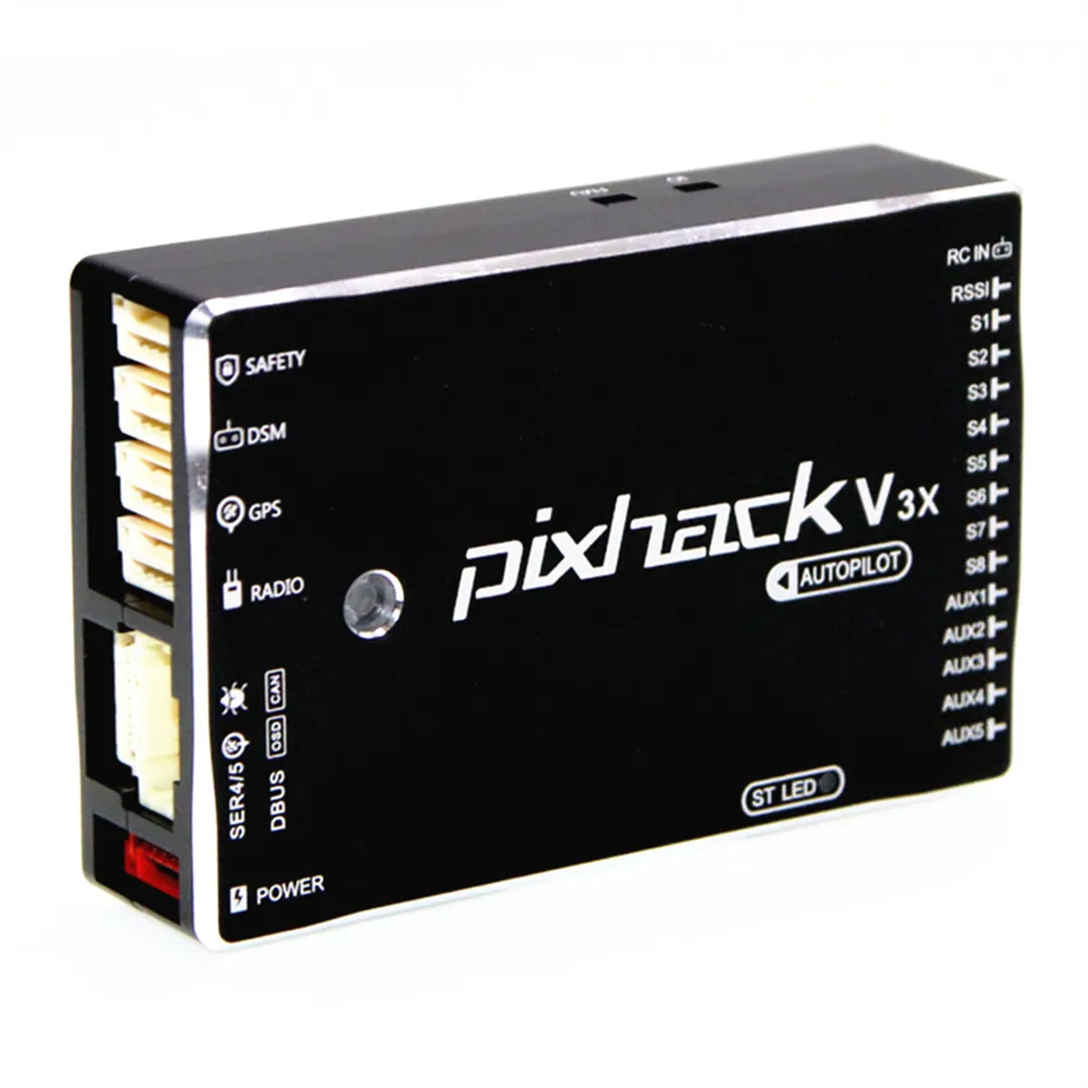

How about the Pixhawk 4 mini? I’m confused about IMU dampening as I read my pixhawk cube have just one dampened IMU. Pixhack V3 is equipped with 3 dampened IMU. Did you have some information about Pixhawk 4 Mini? I’m looking for an Gasser FC so your Help would be great!
Thank you!
I looked at this one briefly in the past and never read anything about it having internally damped IMUs. Otherwise it looks very similar to the CUAV V3.
After what I’ve been through in this thread, I’m sticking with the CUAV V3 even on future helicopters. Or at least until someone proves there is a better one for me. There is now the V3X which is supposedly better. I think Chris Olson has a couple of these that work very well for him.
Thank you @Chris_Khosravi!:sunglasses:
I think I let the Pixhawk Cube rest for other wing or Multicopter Projects.
It make sense to trust other users experience with pixhack v3. I’ve checked some Stores here in EU but seems like only chance is to order one in Chinese Stores:face_with_raised_eyebrow:
Matthias,
I replaced a new Pixhawk cube with a new pixhackv3x.
That pixhack v3 is better suited with Helis than other FC. No problems for me to get that with Aliexpress store.
Look up what others write about their experiencing.

And yes, my Soxos has no damping mechanism. The V3 is also nice, compact and extremely well made.
I believe Chris swears by it as well.

So Guys I have to thank you for your experience :v:
Pixhack v3 is on it’s way :grinning:
Welcome to the club! You will love how well it works for helicopters.
@Chris_Khosravi, did you have some another advices for me in sight of external dampening/ mounting the pixhack unit like moon gel or “milton mod” stuff? I’m familar with vibrations on my zenoah gasser:woozy_face:
