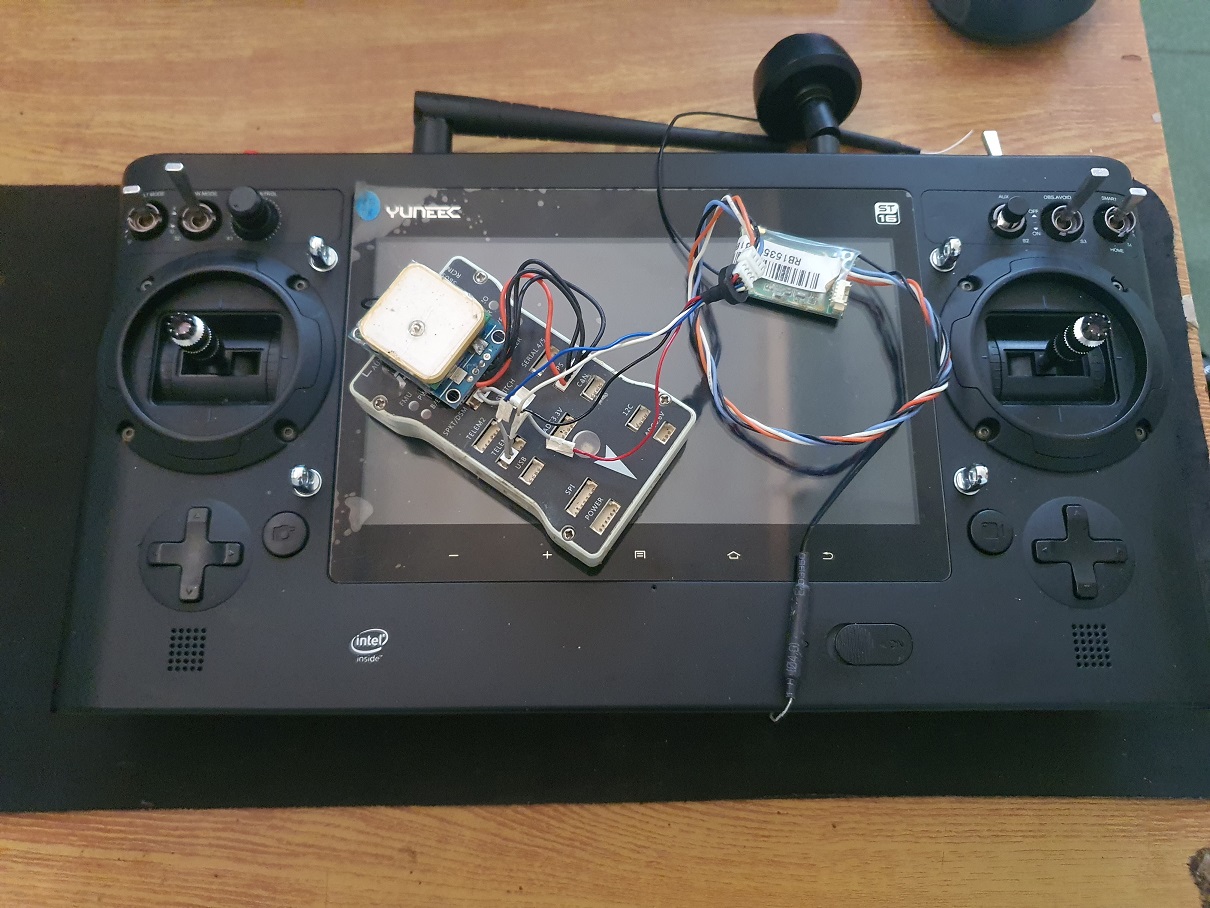

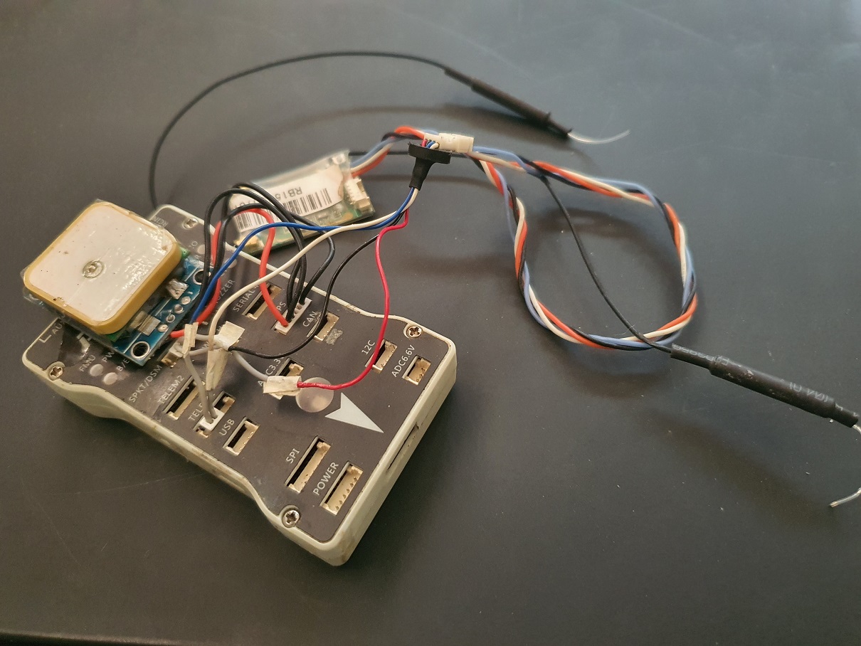

yes just like that, make sure your RC PROTOCOL include ST24 (not every board have it) you must custom build if your board are not pixhawk
set any serial which connect to the SR24 baudrate @115200 and protocol 23
and it just connect
this is my setup, i just update to newest firmware this morning and yes just a few click and connect
*edit: carefull!! on the picture i put connector start @pin number 2!! not in the edge (5v), only need tx rx
