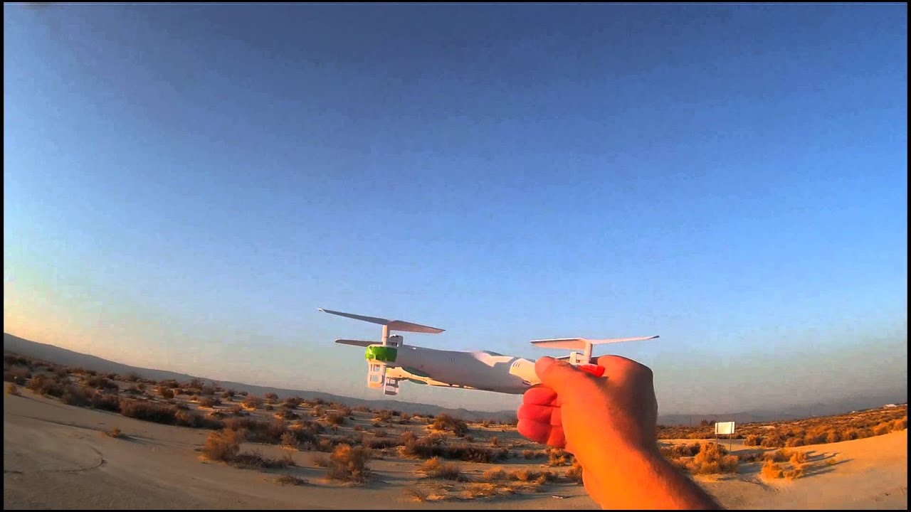

since ppl might conclude from this thread that VRS doesnt occur in multirotors, here is what i think is a convincing demonstration that it in fact can happen in multirotors:
After the third time crashing (via hard landing) my own drone in similar fashion, i came across this thread and video. of course the design of your multirotor may make VRS more or less likely. in my case the rotors are relatively far apart, esp. longitudinally, which might make my quad more susceptible to vrs.
I think the main point is that while a Vortex Ring State can form on a traditional Helicopter it can’t really on a Multirotor so the effects on a multirotor attributed to a Vortex Ring State are actually something else. What’s a good buzzword for “descending into variable prop-wash”?
yes, i actually agree, i was going to edit my post. but i couldnt find any terms for “descending into downwash”! or whatever it is! ™
btw the poster of the video (which is 8 years old) thinks that this doesnt happen with newer drones but did not elaborate. any thoughts? maybe better-controlled descent rates? and/or more powerful motors?
oh, and what would mitigate this effect? extreme rotor tilt (e.g. 10 deg)? coaxial (maybe this makes it worse)?
