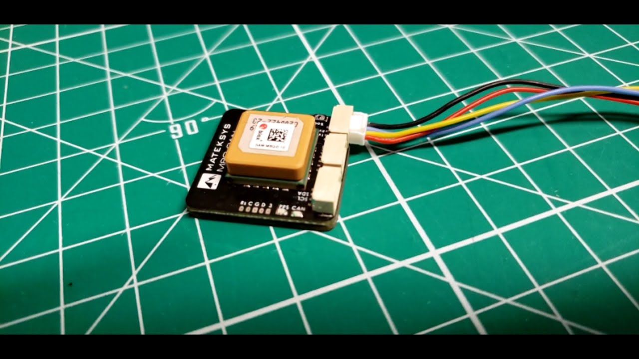

Hi there, I’m having trouble bringing my GNSS to life. The GNSS turns on and eventually finds a fix (indicated by green LED switching on for a few ms at roughly 1 Hz). However, it seems like the communication to the GNSS is not working at all: Even with a fix, my position as indicated by APMplanner is lat/long = 0,0. No GPS fix is indicated by Ardupilot, and of course 0 satellites are in view. Interesting enough, MissionPlanner does not show any Node in Setup/Optional Hardware/UAVCAN.

The hardware is a Matek H743 Wing together with the Matek M8Q-CAN GNSS module. Currently I’m running Arduplane 4.0.8. The GNSS is directly wired to the FC with the included JST cable.

@Rolf This does not seem to be the case. I use the JST CAN connector on the bottom side of the middle PCB of the H743 (http://www.mateksys.com/?portfolio=h743-wing#tab-id-3, http://www.mateksys.com/?portfolio=m8q-can#tab-id-4) together with the middle connector of the GNSS.

I just noticed, the order of the cables on my cable is different that in the picture from Matek On the GNSS side it is red, yellow, blue, black (5V, CAN-H, CAN-L, GND). On the FC side of the cable I have yellow, blue, black, red (CAN-H, CAN-L, GND, 5V), while the FC board itself should have CAN-L, CAN-H, GND, 5V, according to this. I will try and swap them.

Does compass or barometer work for you ? If not, this would also be an indication of a defective cable. The cable has different connectors, at the FC the order is 5V-GND-CAN high-CAN low. The Clickmate connector is correctly standardized with 5V - CAN-h - CAN-l - GND.

I’m not sure about compass and barometer. I was unable to calibrate the compass (probably related to missing GNSS fix). Barometer works, but the H743 comes with one onboard, so that’s no indicator on the cable. I notices that after the cable swap, GPS_FIX now is 1 instead of 0. What does it mean? The cables should be correct now.
After swapping the cables, now the GPS is at least detected in the UAVCAN section of MissionPlanner. I guess my issue is solved. Thank you for the advice and help!
