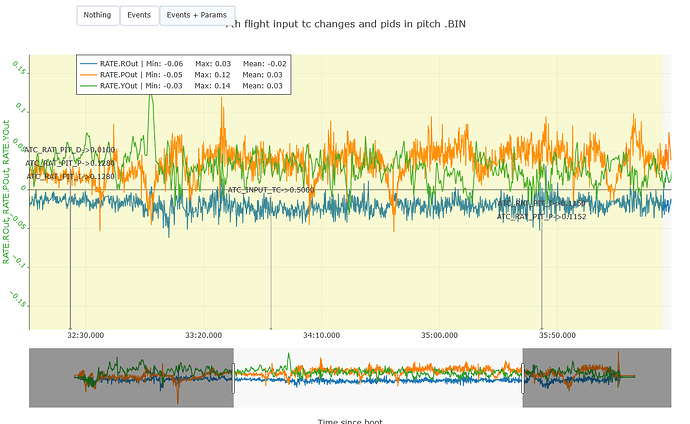

i am reducing in the pitch axis to get the rate out p within the 0.1 lower limit any other thing that i can do ?? atc_ang_pit_p should i reduce this ?? @amilcarlucas
Do one change after the other, not all at once.
yes right now will reduce the atc rat pit p,i,d in one flight and then check for rate out prams.
if not good then will reduce the ATC_ANG_PIT_P

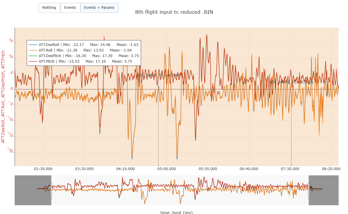

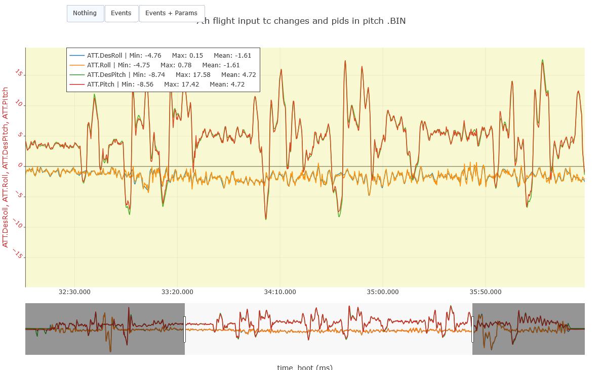

so we changed the atc_input_tc from 0.2 to 0.5.. and the rate out for p has got better and below 0.1… even the pids forpitch were changed.
atttitude control looks good
log-

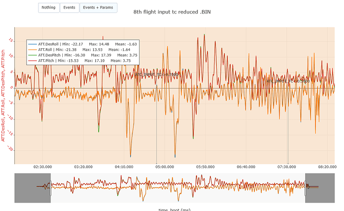

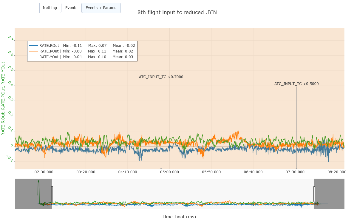

@xfacta @amilcarlucas so the rate outs have reduced finally wihtout oscialltion and other issues even when this huge copter is moving at 10m/s
had incresed the atc input tc to 0.7 and then there was a spike in rate out p and was very slugish. back to 0.5 and everything is in limit.
motor 1 is working more than other but that could be due to the windy conditions right now..
