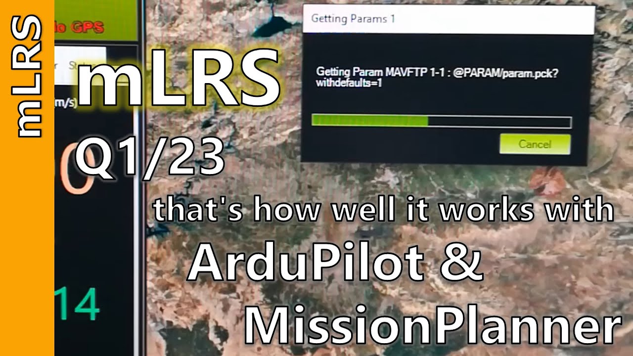

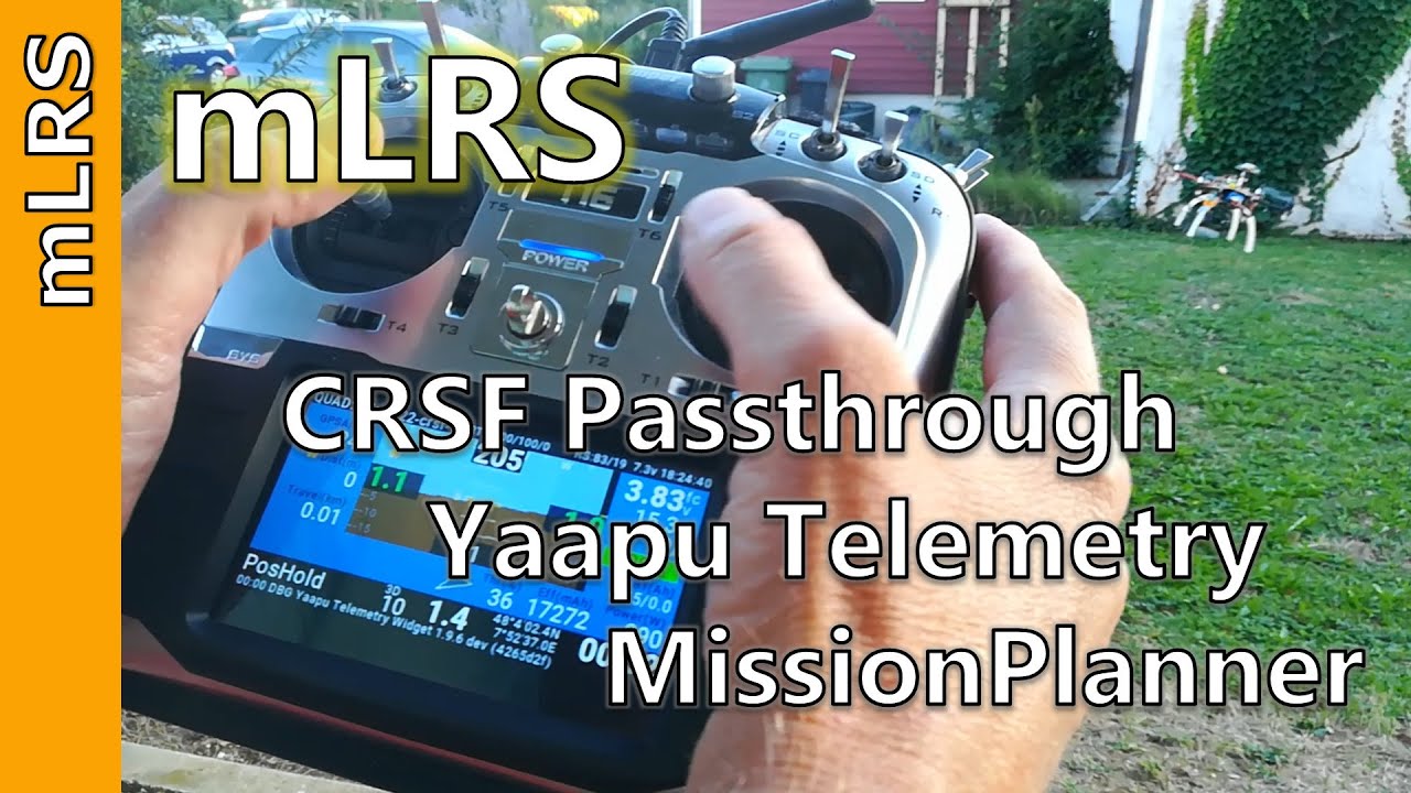

There is no light and cheap equipment to transmit Mavlink more than a few km
I beg pardon, but this is not correct:
2 x 15$ = 30$ for a tx and rx (DIY) module
crsf, yaapu, ardupilot, mavlink, mission planner, all there:
=> statement not correct at all :slight_smile: :slight_smile:
Olli, I know your projects … But there are no easy and cheap modules that you can just buy ready-made. With DIY is of course much possible, but I think that was not asked.
Personally, I am also bothered by the fact that mLRS hardly has a community. I believe everything you write, but it is also so that exactly only one person develops the system. If you have no problem with it as a user, everything is fine …
