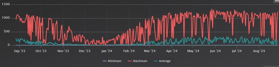

I have been looking at turbines the problem I have is I can’t find any test data on any of the microturbines, like that one you link to, they just state what the battery built into the base can do but not the actual turbine itself.
production is quite low but it can produce something if you are at a windy area. Should be enough for 1arduino or esp not at full power

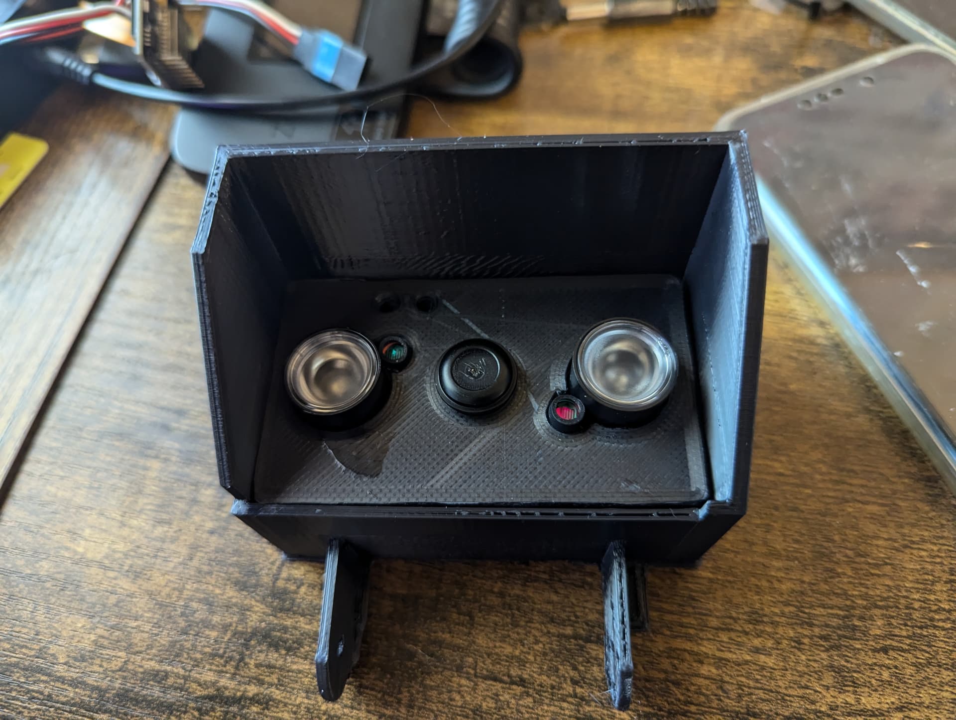

I’m still trying to get good depth information from the AI camera, using the radar works but it has a lot of issues. the main one is what to do with data that doesn’t match, so what do I do with an object that doesn’t have a corresponding radar return or radar returns with no object detected? I have tried using the lower box pixel position to give a rough estimate of distance but it doesn’t work well with multiple objects or uneven terrain. my next plan is to get 2 cameras and try and do some trigonometry using the pixel positions to get stereo depth. my understanding is that if I can get an angle from each camera and I know the distance between the cameras I can calculate the range.

I have fitted a little omni radar to wake it up if anything is around it as well as the esp32 timer, it only uses 7mw so effectively nothing. it gets a lot of false triggers if there is moving vegetation or water around but its only to wake the rover that will be perfectly still in the middle of a park, when it wakes it will upload data from all the sensors then go back to sleep. The boat will use the timer and a vibration sensor since it’s always going to be moving.

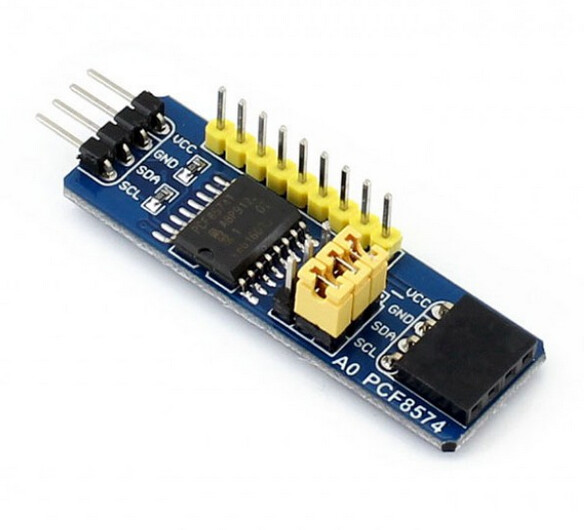

All the GPIO has been moved to the i2c MCP23X17 GPIO expander to free up pins on the esp32.

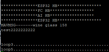

I added telnet server, so I can connect and see terminal output without having to attach a wire, its an issue as I’m using the main serial port for the flight controller so being able still use terminal without tying up a serial port is very useful.

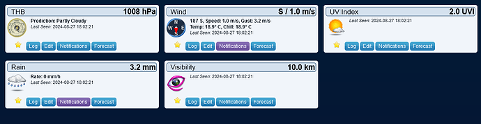

I have moved all the environmental sensors (wind direction, speed, temperature, pressure, humidity, rainfall, lightning, lux, audio level) onto a separate esp32c3 board, i couldn’t get the esp32 to run without lagging or crashing when I tried to use 2 cores, so I just moved the sensors back onto the separate controller.

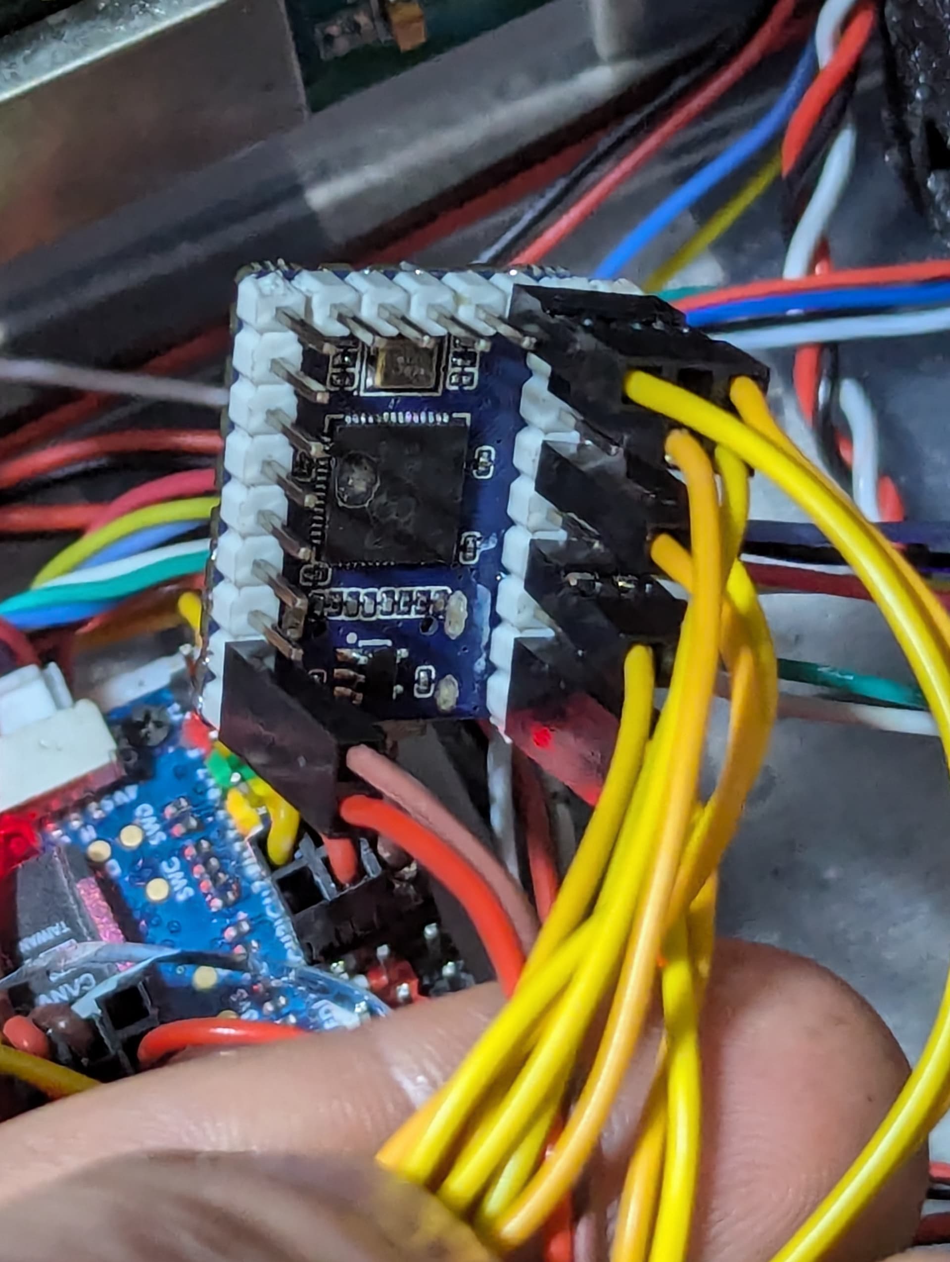

I have installed a pair of Matek I2c INA228 sensors, one for the main battery and one for the solar panels they are extremely accurate compared to analogue sensors. I also installed a pair of INA218 sensors for the backup batteries to monitor their levels.

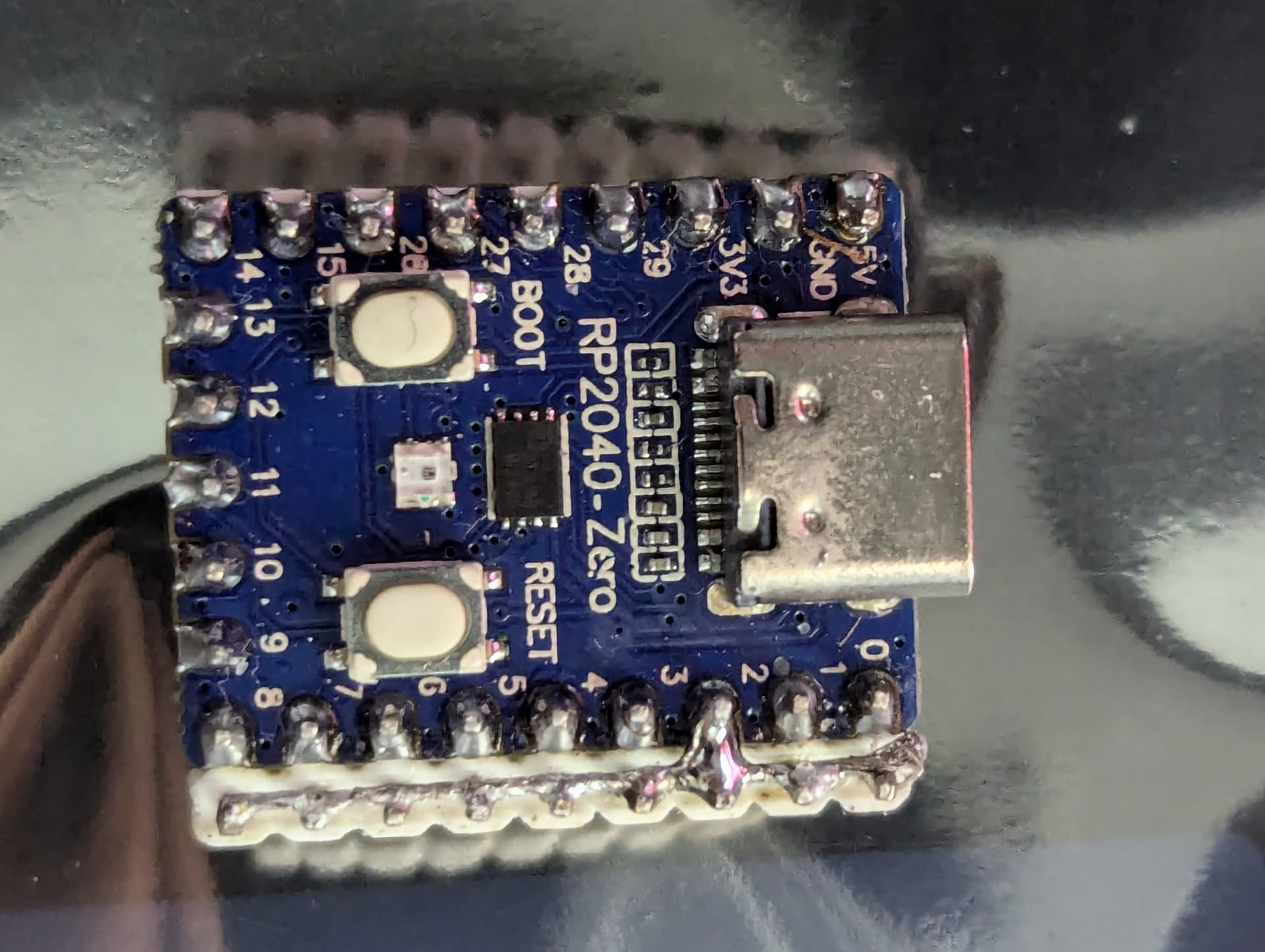

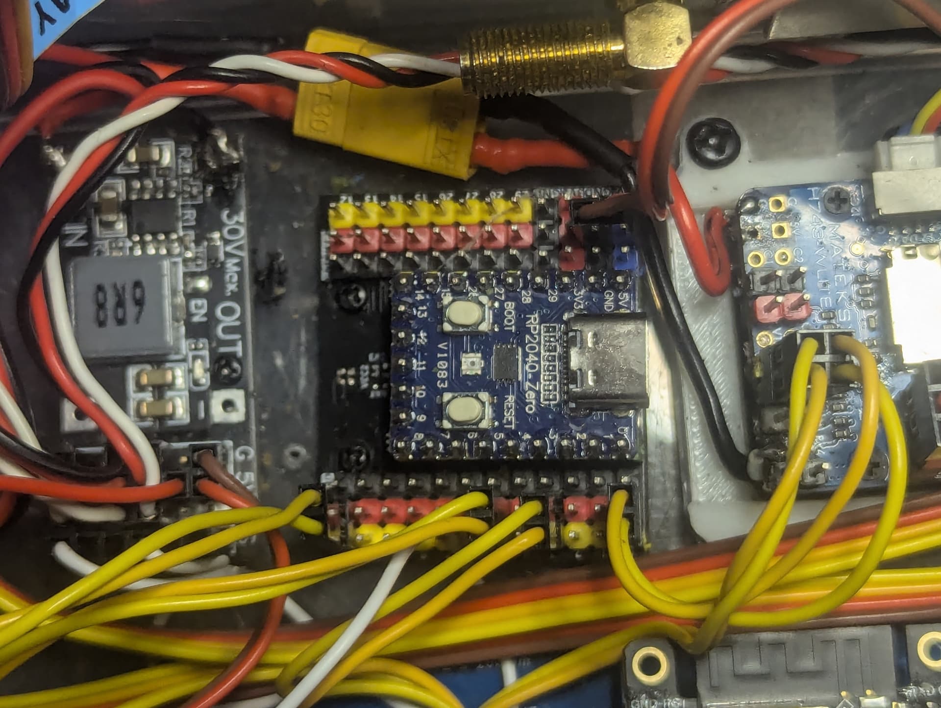

I made an updated version of my mavlink serial multiplexer so it now gives out a serial bridge heartbeat. basically it works by taking advantage of the routing between the ports on the flight controller, one port is set at 115200 and one is set for 1500000, all the device RX pins are connected to port 1 TX pin at 115200, then all the device TX pins connect to the RP-2040 serial ports at 115200, the data is then forwarded to the flight controller from the RP-2040 over port 2 at 1500000, the reason for the 2 ports is that trying to fit everything down a single 115200 port causes problems once you start sending too much data, using a second port at a much higher speed gets around that issue but if your only using low speed devices then you could use a single port.
I have redesigned my mavlink serial splitter, so now it only needs one seral port to run 5 mavlink sensors. it now relays the mavlink data out of one of the serial ports on the rp2040 that is then shared with all the other devices. The sensors still cannot see each messages from other sensors as there is no routing happening, this is fine for most sensors and I still use the flight controller serial ports for telemetry like UHF and LTE or sensors that need a dedicated port. most of the sensors im using is for things like the motor temperature, battery levels, rangefinders or proximity sensors that dont require bandwidth or need to communicate with each other.
I have a verson of it that will route but its very slow if you route to all ports

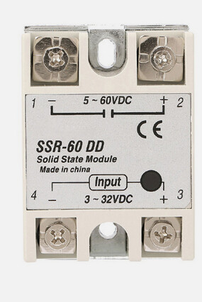

I have redesigned the power system, so instead of 2x 5v backups there is a 12v ups and a 5v UPS, the idea is that everything is backed up by the 12v ups, with the 5v UPS only powering the esp32, modem and Wi-Fi camera.
Due to a series of very minor but time-consuming issues related to the recent storms, I haven’t had a chance to do much but with the sun about to return im wanting to get this out for spring.
I have finished rewiring the power supplies, so now there is a 12v and 5v UPS so everything is now covered by one of the UPS.
there is now a 48v-12v regulator that supplies power for all the electronics along with a separate 48v-5v regulator thats running the UPS backup power supply system.
The latching relays I bought for controlling power to the main 12v regulator have been problematic as it keeps failing. I think it’s the high voltage DC that’s damaging them, so I have replaced it with a 60A 60v DC SSR that should be more reliable.

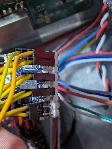

I *ucked up, I managed to plug a connector in backwards, the wire I was using has 4 colours, red, brown, yellow and orange, due to low light I managed to mix up the red and brown (+ -) and took out a large chunk of the electronics on the vehicle when i reversed the 5v rail. I am very annoyed as it was basically complete and i was just tidying up the wiring so the esp32 relay board, rp-2040 serial router, 2x INA219 i2c power sensors, i2c oled screen, i2c MCP23017 gpio board and audio amplifier are all toast, luckily the flight controller survived as its on the 12v rail.
On the bright side, I figure it was as good a reason to rebuild it better.

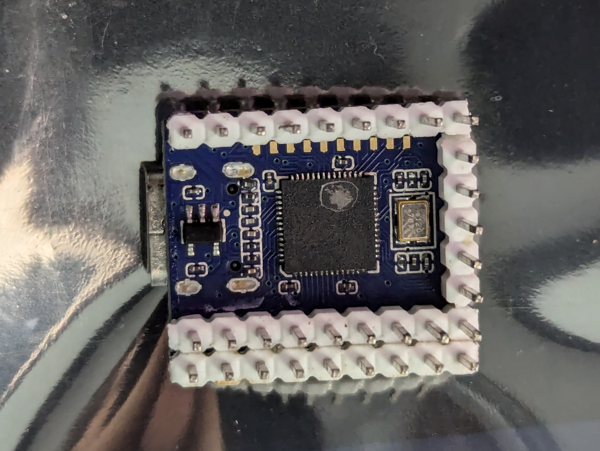

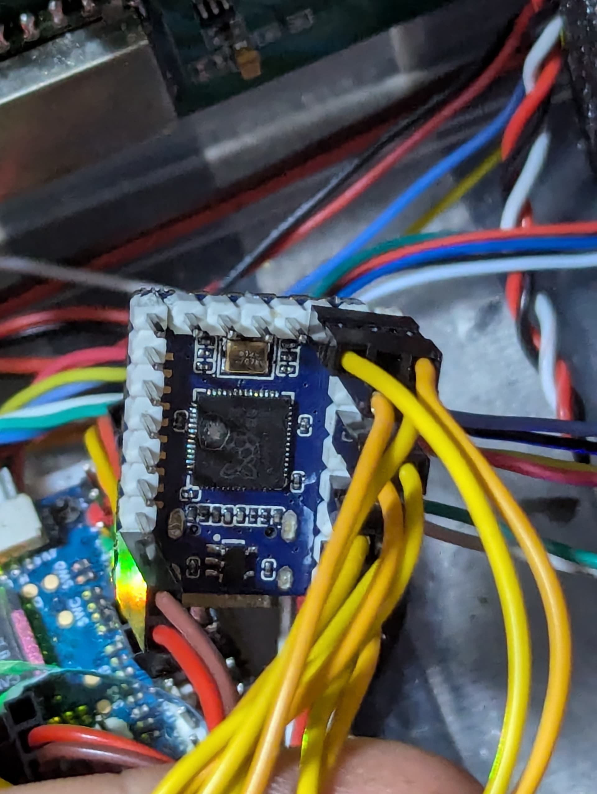

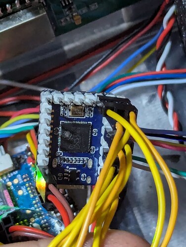

I had spare INA219 sensors. RP-2040 and OLED screen.

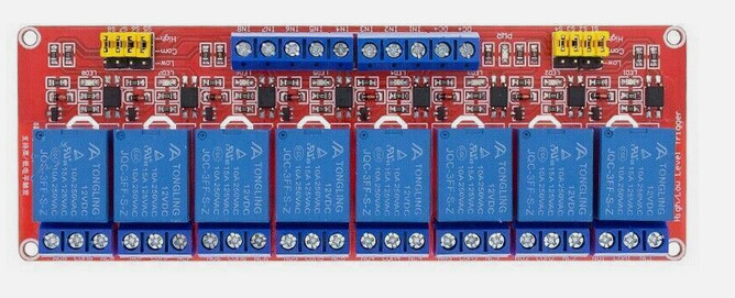

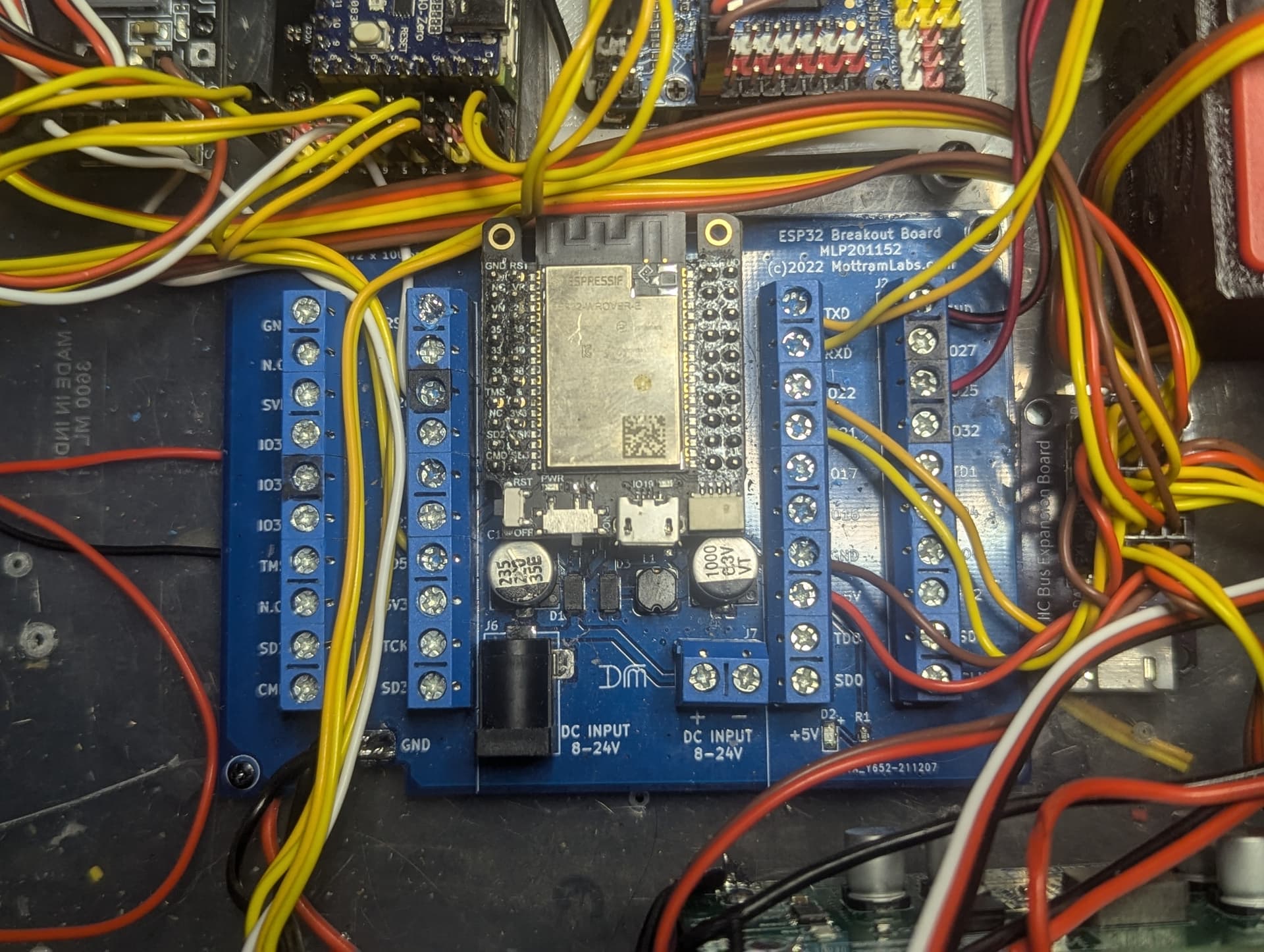

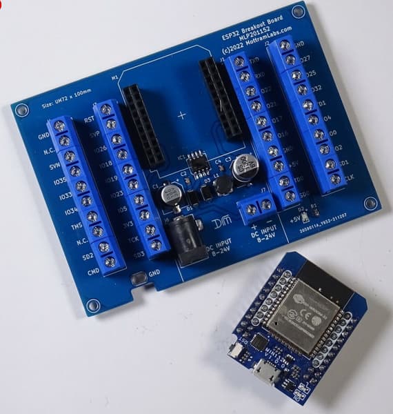

The esp32 relay board was a good idea but it soon became very limited as using all the GPIO for relays left few pins for other uses and I ended up having to modify it to be able to use pin25 that has the DAC so I have replaced it with this breakout board and mini esp32. it should allow for a fast replacement if something happens again and a lot more flexibility with pin selection. I also got a 16mbit esp32 board for it as I was getting close to the memory limit mostly due to talkie.

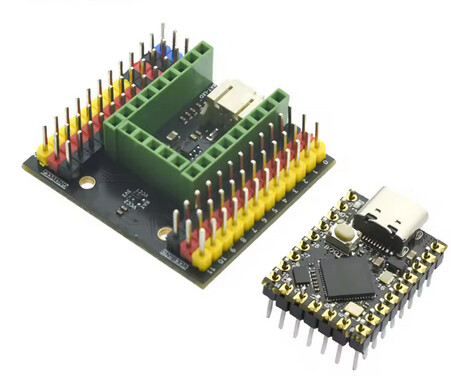

for the rp2040 mavlink splitter I have used one of these breakout boards. But to get it to work for mavlink I have removed the jumper for the 5v rail on one side so that is now the rail is the TX from the flight controller. Now I can just replace the controller without any custom soldering if it fails again.
I have got it all down to one serial port working reliably at high speeds, basically I was just running it all too slowly. With the link at 115200 there just wasn’t enough bandwidth for everything when it got busy so by changing all devices to 500,0000 and connecting them all directly to the flight controller TX pin it got rid of a lot of congestion so everything is now coming though reliably even with the lidar and radar and motor controllers running.
With ardupilot you can have 4x mavlink ports so I was using one for MLRS, one for DroneEnage and 2 for all the sensors but with this latest improvement now with the mavlink hub I only need a single port for it, that freed up a port that I could then dedicate to my esp32 companion. because it now has its own port it can receive telemetry from all the other mavlink devices routed via the flight controller. This now lets me do things like monitor the heartbeat of other mavlink devices and read things like the label name from the objects the AI camera has detected and send it back to my controller for logging or reading the lidar, or sending commands directly to the gimbal.
Since i got rid of the esp32 relay board I had to replace it with some more relays driven with a pair of PCF8574 i2c GPIO controllers, I tried to replace the mcp23017 but all the replacements I had were doa. so i had to pull some PCF boards off some old projects. It would be nice if these were supported with arduipilot directly for relays to free up gpio on smaller boards.

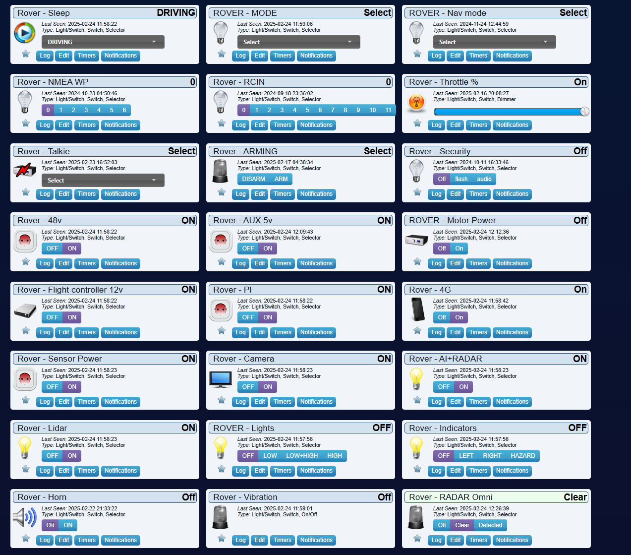

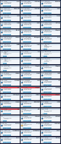

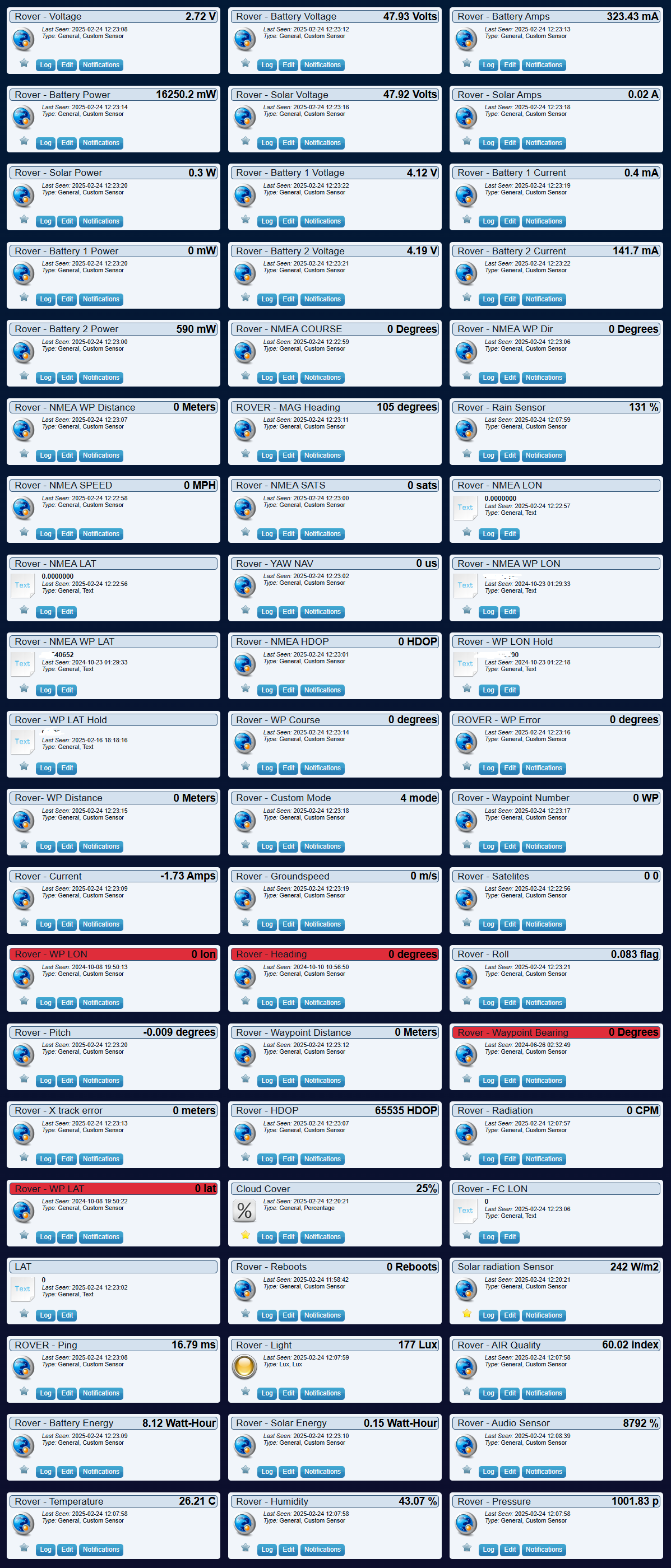

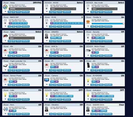

As you can see I can control most of the functions from here and im logging a lot, but there is still a lot more to do as this is just for the flight controller and the sensor controller i haven’t added logging for the lidar, radar, AI camera or the motor controllers yet. The main reason for this system is that mission planner and flight controller logs dont work when your talking time spans of months so i needed something better suited for long duration monitoring.
I have added a load of sensors onto it, sensors are cheap so I put them all on it, its pretty much a rolling weather station now
since its going to be unattended I added some basic security where it will flash its lights or sound a car horn if someone gets too close to it, the last few times it has been out OLD PEOPLE feel the need to walk up to it and tug on parts of it like the camera gimbal. I dont know why, there have been lots of kids and teenagers walking up to it and looking, taking photos, not one of them have ever touched it but old people walk up and start grabbing it and pulling on parts of it or even trying to lift it by the solar panel its like they dont belive its real, its happened multiple times now. its funny because I always get asked if I’m worried about kids vandalising my robot, but they have never once set a finger on it.

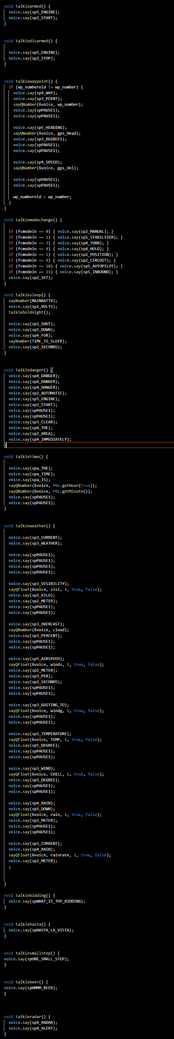

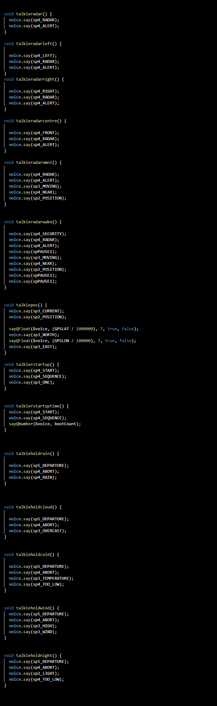

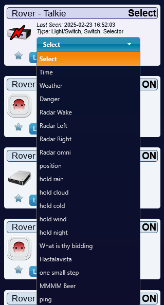

I have added a lot of talkie text to speech to the esp32 using its interal DAC to genrate speech using some retro 80s technology the roms are from :

there is about 1000 words you can use it would good if ardupilot could do this using the motors using dshot rather than just beeping.
I have a bunch of warnings setup that I can automate. so it can communicate by talking, it will:
read out the waypoints and what direction its going to go in to the next waypoint.
when it starts up it will announce a warning that its about to start moving,
it reads out flight modes.
when it’s parked and someone comes up to it will say why It’s stopped then read out all of its sensor information.
There is a way of making custom words, i want to convert one of the EDGETX voice packs at some point as i had to get creative with a few word choices.

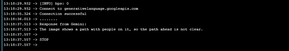

I have been playing around with my amb82-mini AI camera, there have just been some new updates to its library so it now supports connecting to AI chat APIs for sending pictures to them and asking them to describe the picture and there is now an example for doing text to speech using googles translation API.
So for testing I have combined them so it takes a photo and asks if the path ahead is clear for the robot and to describe the situation, it can then read that out aloud.
I eventually am going to do something like have it send a photo for analysis if it detects something with the lidar or its basic neural network model to get a better idea of what it’s detected and if there is a way around it.
It’s not very fast unfortunately, it takes around 5 seconds to take a picture and get the results and another 5 to use the text to speech so to get it to take a photo and say the results takes around 10 seconds or more depending on your network so its not something that I will be using for real time navigation, but for something simple like “is it safe to move forwards”. it should work fine. It should also work as a logging system. Rather than having to stream video, it can just send some text with a summary of what it sees.
giving it this image
with the prompt "discribe image, is the path ahead clear, say STOP if any people are detected";"
this is a very cool video on how to make it voice controlled and interact with the world.
basically you need to give it a prompt with what it is and a summary of the last 10 interactions so it can keep track of whats happening. It should be possible to give it verbal navigation commands, and it can hand over the coordinates to autopilot.

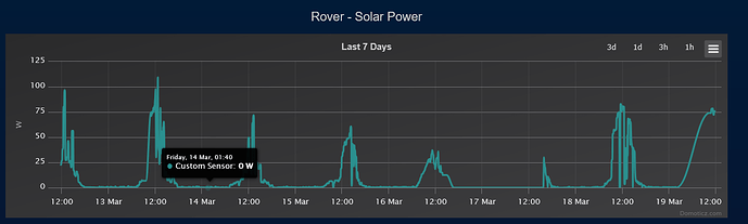

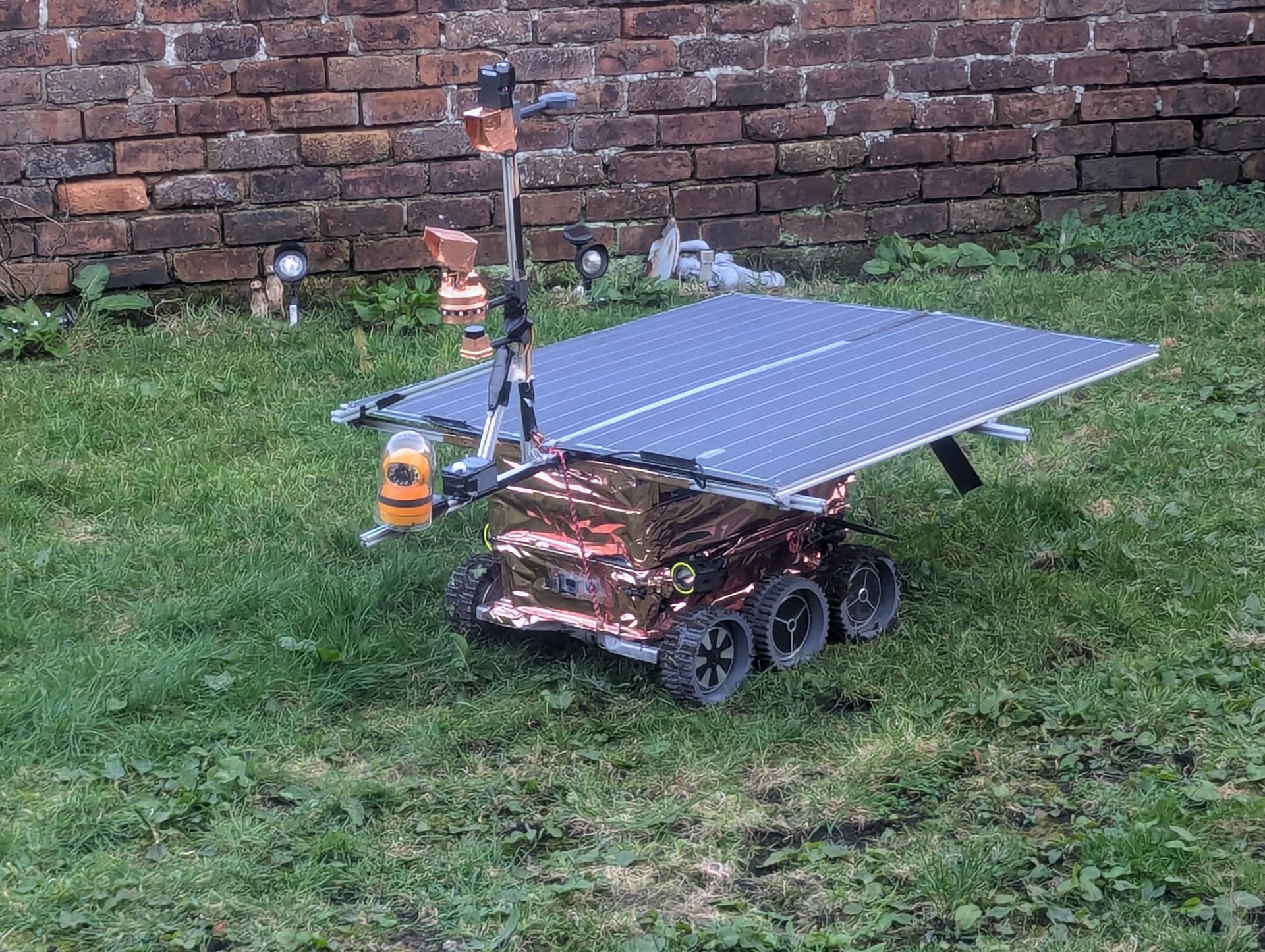

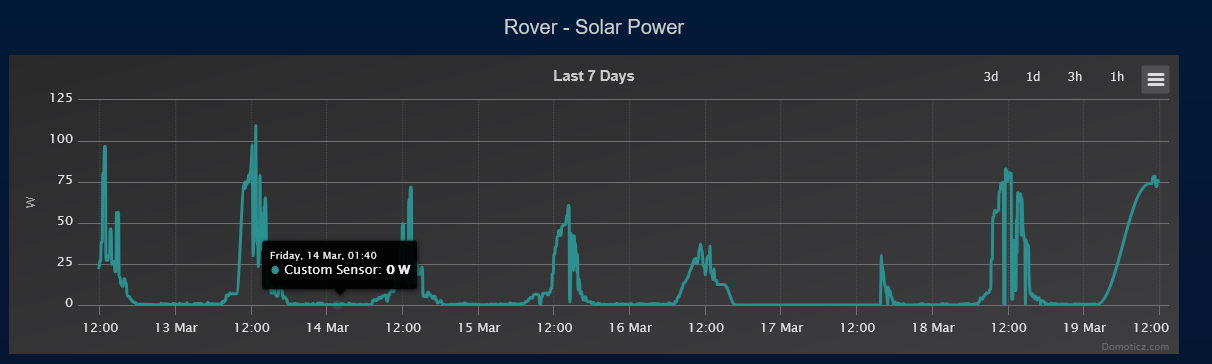

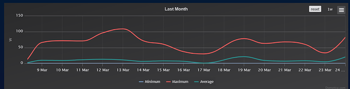

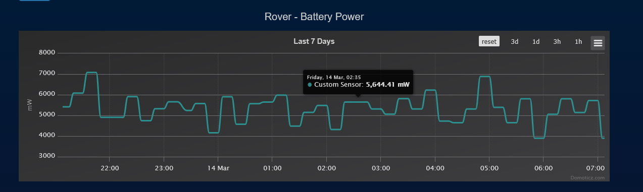

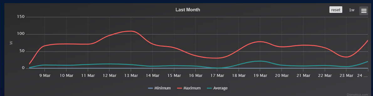

Now we are into spring and there is a reasonable amount of sunlight I have put the rover back outside for testing. It’s going to be in the garden for a month or so to work out any bugs before it goes further.
so its been over 2 weeks and I have made some discoveries…
First is that my solar panels are junk, This is the first time the rover has been out with proper power logging and its showing that my panels aren’t even putting out 50% of their capacity. Its got 2x 100w flexible panels and im barely getting 100W, so I think they have picked up damage over the years like cracks so I will probably replace them with something like a single large 200W panel. solar panels have got much cheaper and efficient, so I can get a 200w panel now for about £70 compared to the £150 i paid for each of the panels on it.

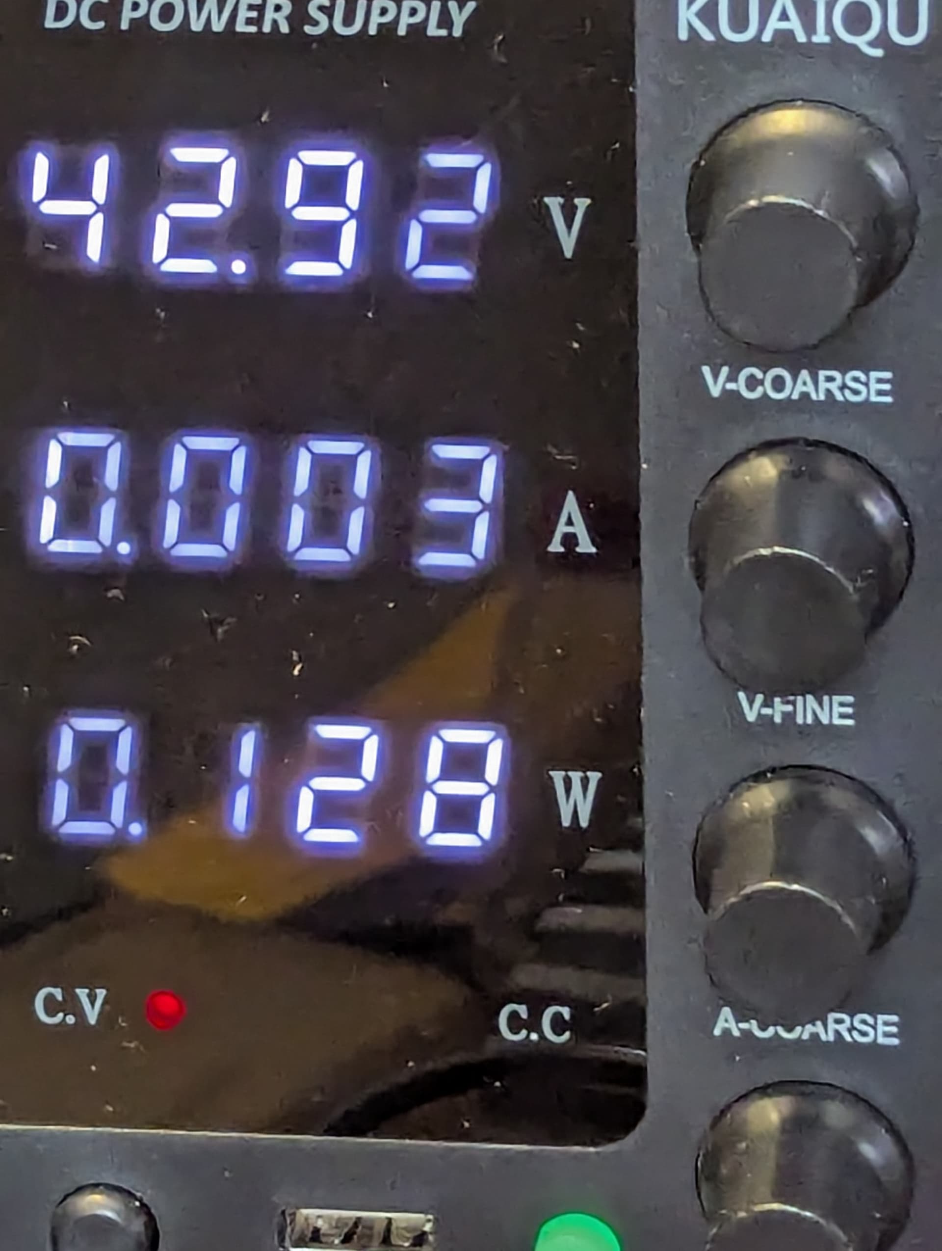

at idle with just the esp32 and the modem its using around 6W but i think I can get that lower, I am replacing one of the relay boards with a mosfet board so it should reduce its power consumption a little and im adding a small 48v>5v 1a regulator just for the esp32 and modem, that will let me turn off the main 20A 5v and 12v step-down regulators as I think that’s what is using most of the power now at idle.
Consumption with the rover fully active with all the ESCs and sensors on is around 50W with spikes up to around 250w when turning on the spot and the wheels are digging into the grass.
ESC 2 has a fault where its feeding voltage to the RP2040 chip that controls them via its serial port causing it to not start occasionally. When this happened, I would need to remove the power for it to boot again by either physically disconnecting the battery or using the bluetooth app to turn it off and on. my plan was to connect to the BMS over serial to get the battery information and control, but the library I found looks to be for a slightly different BMS I need to investigate it more. I am going to replace the ESC but to be sure I have connected the BMS battery switch to a relay so I can switch it. The rover has a backup battery so it can switch off main power for short amounts of time.

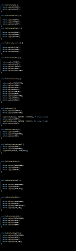

I have rewritten the esc controller code so it has more sophisticated management of the motors, it can now detect and automatically alert and deal with a few issues like if the controllers are overheating It will turn the overheating ESC off when its critical, and back on once its cooled down.
if any motor is running slower than the rest of the wheels on its side or if any of the motors are stuck it will send mavlink alerts.
Rather than controlling the ESC power switching directly from domticz it’s now fully automatic-
when the rover is disarmed, all the ESC’s will be off,
when the rover is armed and in hold mode, it will only start the centre ESC to use it as a brake to keep it from rolling.
When the rover is armed and in any other mode, all the ESCs are on.

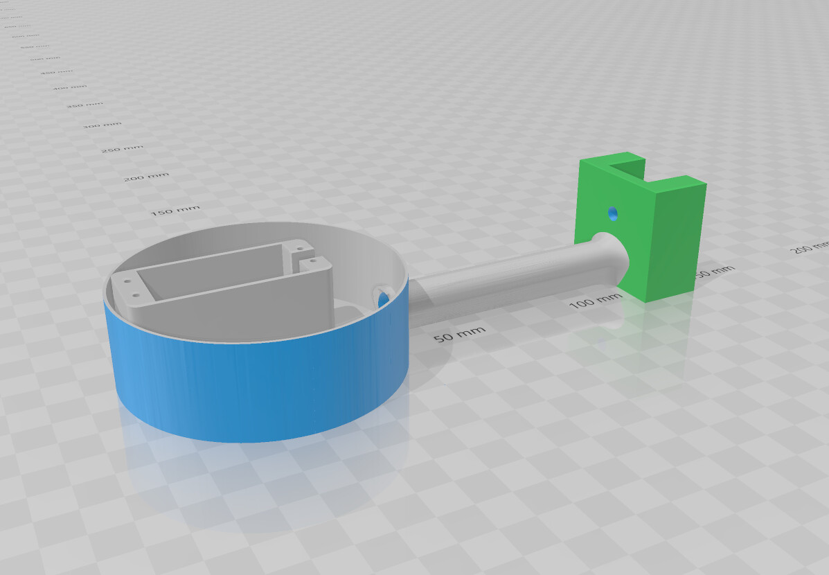

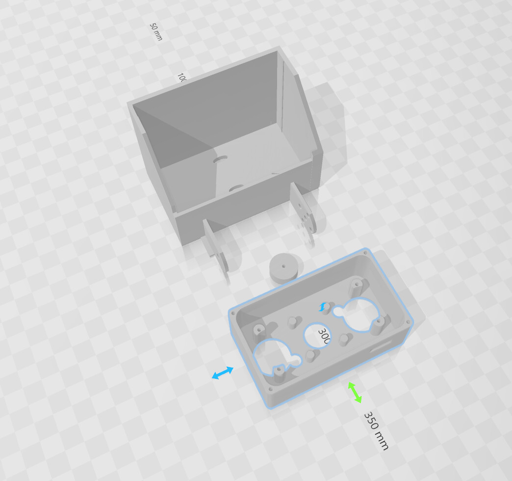

The 3d printed gimbal mount that sits above the lidar snapped when it was going over some bumps, when it dropped, it covered the lidar, blinding it and causing it to crash into a plastic garden chair. so i reprinted the mount with some internal bracing and support so it doesn’t snap at the same place again. im going to add a backup rangefinder, probably a sonar in case something like that happens again. It also shorted out the 5v when it pulled the wire off of the led strip as it fell causing problems for all the other devices on 5v. So I am going to add some 1A poly fuses to all the 5v devices, that way if something totally shorts it should recover.
The ld06 lidar is still having issues in the sun, I have the filter at 200 out of a maximum of 255, and its still useless in sunlight so next time it’s in I’m just turning it up to 255 and hoping for the best. If that works then I can use the onboard light level sensor to dynamically change the filter depending on the ambient light levels.
The radar/AI camera combo works quite well as long as they are directly ahead or close up, the 2 neighbours were in the garden and I could see them moving around on mission planner but the camera has a much wider fov than the radar the further out it is so once something gets to the edge of the screen and the radar cant detect it anymore it gives the range of the next object like the wall that’s usually much further away. I belive this is the problem the v1 tesla autopilot had with its mobileeye+radar system as it would pick up objects with the radar and fail to fuse that with the camera data.
im happy to report that the matek flight controller has been behaving, now its connected to a relay with no accessories powered from it, I havent had any memory corruption since i have isolated it. the only connections to it are mavlink serial, 12v and canbus.
My domoticz control system is working, It can automatically wake up the rover, arm it, set auto mode. drive for a set time disarm and once the voltage gets low then it will set it to go to sleep automatically.
at the moment im using a lot of delays to get everything to start up in the correct sequence, so flight controller, then accessory controllers, cameras, then the ESC’s, but that’s not ideal, I’m working on adding feedback to the startup sequence so it checks each component as it’s turned on for the correct feedback to check its started correctly before moving to the next, there is no point turning on the ESCs if the flight controller isnt detected.

I don’t believe this, maybe these modules not last state of the art, but…
The nominal capacity shown in the data sheets are only a theoratical value which is never ever reached. This value is only for comparsion of different modules. It shows the maximum power earnt under direct absolute clear sunlight with 1000W/square meter comming absolute ortogonal to the panel.
This can’t be reached with your setup under normal conditions.
To check if the panels are defect you can compare the two modules against each other as the both has mostly the same light conditions. So if the output (voltage and current) of both is nearly the same they are most probably ok as they don’t will have the same defect.
I dont have any power monitoring on that side of the mppt controller but unplugging one at a time should give me a good idea if it’s just one terrible panel or both are struggling.
Are the two panels parallel or serial connected to the MPPT charger?
