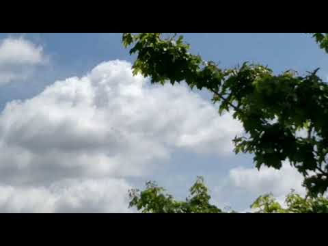

Yesterday I did more tests with the 4.4 dev, but it didn’t go well. In particular trying to do a mission between two waypoints, the copter seems to do it, but it gains altitude without any input from the pilot, turning yaw as if looking for something, even though the front sonar and bottom lidar sensors have been deactivated with aux switches. Furthermore, the copter does not respond to the RTL command, simply hovering where it is at the time of the RTL command. I attach a small video where you can see how she gets up and turns yaw and the flight log. There are more details in this thread.

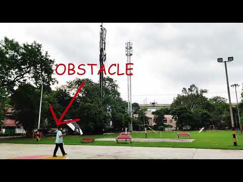

My aim was just to test the vertical bendyruler exactly as seen in Risha’s video. The terrain where I carried out the test had no obstacles and the front sonar has a range of a few metres, I don’t think it can see obstacles. Could it be a front sonar malfunction? Yet the simple stop works, as seen in this video. I will still try disabling the bendyruler. Could all of this explain why RTL doesn’t work? Meanwhile I updated the fw to 4.5 dev

yesterday i flew disabling the front sonar (prx1,0) and in auto mode it works fine. It must be a problem related to the bendy ruler, but I don’t understand how to fix it :frowning:
note: I only left the point down lidar active and, although the sonarrange was correctly updated in mission planner and in flight via yaapu script, the copter seemed not to use it (simple stop slide set). Could it be some wrong setting on prx/rngfnd?
