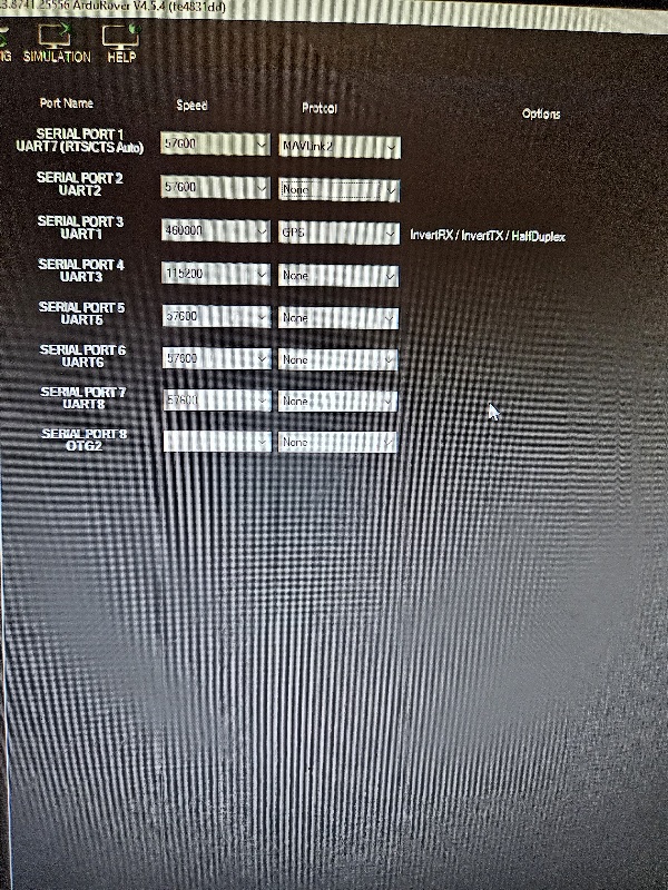

Connected via USB. HUD is “No GPS”. Tx-Rx wiring per photo, Using default GPS uart 1 on Kakute. Uart 1 set to 460K baud but has message “InvertRX/InvertTX/HalfDuplex” under options.
Thoughts?
Set SERIAL3_OPTIONS=0.
Thanks. That got rid of the invert notice. Still “No GPS”. Serial 3 protocol is set to gps. baud rate is 460.
GPS_TYPE=5, as stated multiple times above.

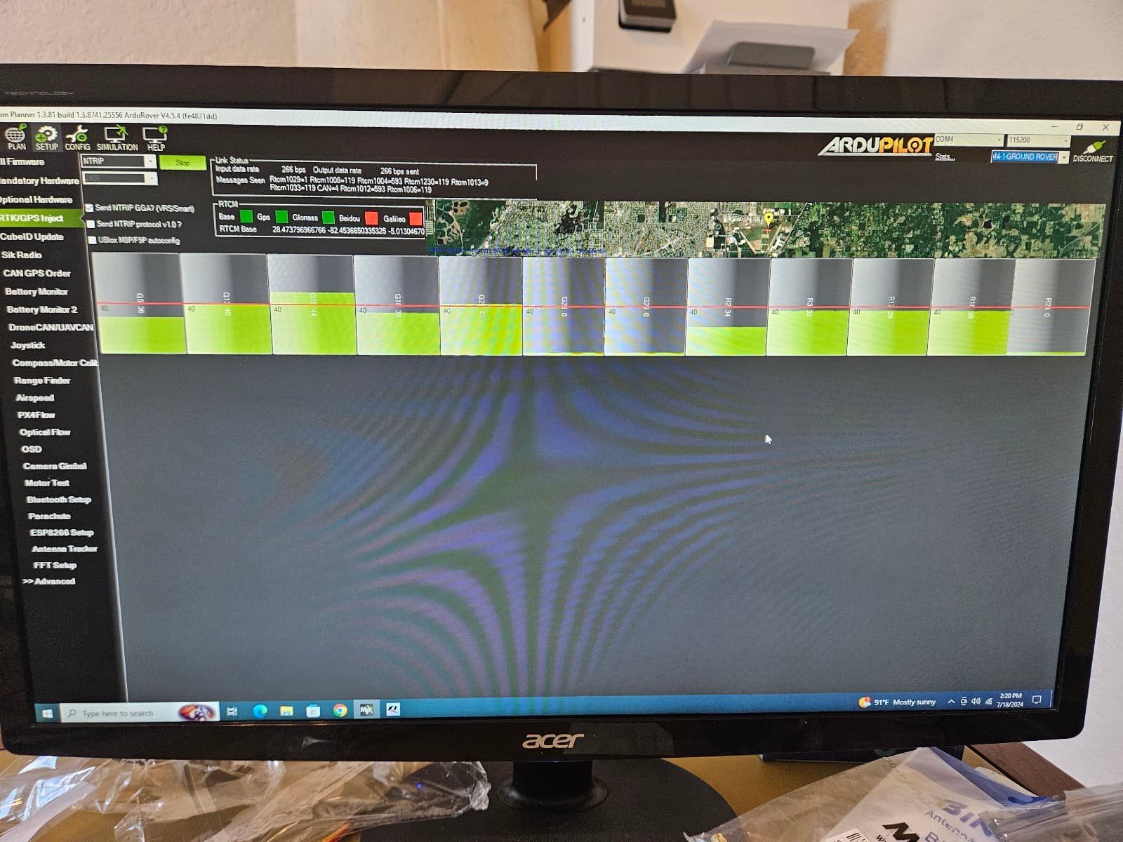

Yuri, I attempted to set the 5hz. Took your txt to ini. In QGNSS, connected LC29 via usb, switches to USB setting. HDOP was .7, view of sat sig strength showed 20 satellites. Did “command console”, Load, selected the ini, got 35 lines, clicked run. When the last line was red, hit “stop”. After running it, it took a while for HDOP to get back down to .7. No longer could see sat strengths in QGNSS; I assume because you have blocked that data for bandwidth. Moved GPS back to MP and injected NTRIP. HUD says 24 satellites with GPS antenna out the window. “GPS: 3D Fix”. Shouldn’t it say "RTK Fix or something similar? So what cockpit error am I making now?
Your NTRIP source looks non-standard. You should be seeing 1005 and 1230, along with 1074, 1084, 1094 and/or 1124 (or 1077, 1087, 1097 and/or 1127).

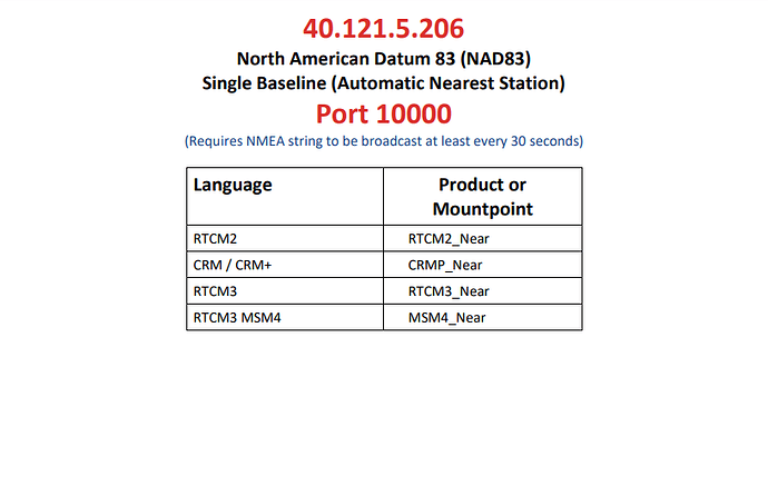

Yuri, Thanks for the response. I’ll take a look tomorrow. Its standard state of Florida NTRIP data, so I may have set something wrong trying to grab it. Late Night update: I asked for “RTCM3” data in my request. That came down as mostly 1004 and 1012, considered “legacy” GPS and glonass L1 and L2 corrections, respectively. Your 1074, 1084 etc are MSM4 corrections. I apparently didn’t ask for those (since I didn’t really know what they were, I didn’t know to ask). I wonder if I should change my request to MSM4 from RTCM3? Looks to me like the data I requested is getting into MP, but not getting into the LC29, or at least not correcting the data, since the GPS status in HUD should have “RTK” in it if it were working right. RTK 3D, RTK float, or RTK Fix. Instead I’m just getting 3D fix. The 915mhz telemetry radios operate at 57K baud, so that concerns me as well, though I may just be worrying. You had helped be get access to Florida NTRIP data in another thread in May and I seem to remember discussions around MSM4 in that. I’ll look it up again in the morning (really later this morning). Here are the products Florida offers:
You want RTCM3 MSM4. Those legacy messages aren’t used by ArduPilot.

Did a quick test. changed to MSM4 and picked up all the 1074, 1084’s etc. And added Beidou and Galileo. At upper left, “Send NTRIP GGA?” is checked. Also could be “send NTRIP protocol v1.0” is possible, but that sounds old. GPS is still “3D Fix”. I’ll do the 115K next… Wondering if its getting data from the LC29 but not putting data into the LC29? The wires look OK, but maybe its that link? Is there a way to see the raw data that is going into and out of the LC29?
check the switches
Wow. That was a spot-on idea. Unfortunately both switches were toward serial. I turned switch to usb and back just to make sure its OK. But I wonder if the switch is defective? How to see what data the GPS is actually getting?
