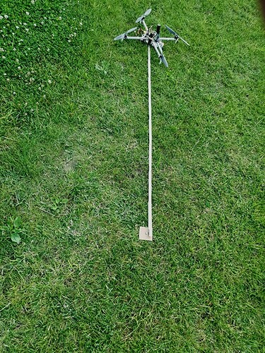

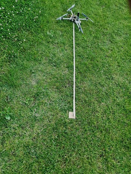

To my delight, during today’s test flight with the Quectel GPS[0].Lng and POS.Lng (and Lat) were in good agreement, in contrast to earlier flights:
And the landing was now also accurate to within 15 cm.
I can’t yet say what the reason for this difference was. Individual flights certainly don’t say much. So either I extend the small copter so that the Quectel and the Ublox GPS fit both on it or I build a mount so that I can quickly swap them. The waypoint flight route remains the same before the copter has to land again at the home position via RTL.
The timing is still much more irregular than with the UBlox GPS.

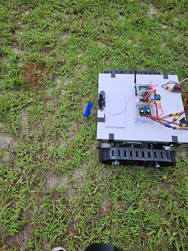

Good news. I checked the protocol for serial 7, the telemetry radio, and it had been -1. I changed it to 2 (mavlink2), took it outside and let it find 25 satellites and NTRIP was started in setup, and I got “GPS: RTK Float” in the HUD pretty quickly, followed some time later with “GPS: RTK Fixed”!!! Thanks so much, Yuri, you are, as always, awesome. I believe this means that NTRIP correction data is getting into the LC29 and correcting the GPS position. Concerns are that the little rover on the map is floating all over the place, perhaps a circle of 2-3m diameter or so, with physical gps stationary. The HDOP at the bottom of the map was varying from about 1 to 2. That seems a little high for a RTK Fixed position?!? So, Yuri, I still see lots of posts that seem ambiguous about the LC29, including Rolf’s just above this post. So to all of you with experience with the LC29, after looking at your own and other people’s results, what is your final opinion about the LC29? Can it be used for a robot mower? Can it achieve accuracy of 1cm with NTRIP fixed position? Is there anything else I need to do to improve accuracy? The nearest Florida NTRIP base station is 8km away. Per the title of this thread, budget is important. The F9P may be better but $300 more is not worth it to me to do this project at all.
You’re asking me to make a judgment call on a GPS I configured once, flew a couple of times, and otherwise have seen very little on which to base a good opinion (no discredit to those who’ve contributed, but Rolf is getting mixed results, and there isn’t much else to go by).
If pressed to make that call today, I’d call it marginally better than an M8P, and significantly worse than an F9P, UM982, or Mosaic X. As such, it will work, but I wouldn’t put it on a large vehicle or critical application.

Thanks so much for the insight, even though its early. I understand the lack of data so far. I’m certainly going to continue with my project and might even have some results to share later. I saw Rolf’s results which are better than previous but still discouraging. Even in the first 10 minutes, I’m a little concerned that my rover location was wandering in MP after RTK fix and HDOP was high. My “large mower” is only about 40# MOL and about 2’ wide; my backyard large, fenced, and free of most obstacles and hazards.

Yuri, Fantastic. I’ll make a note and buy that if the LC29 looks inadequate after reasonable testing. To configure the SimpleRTK2B, I assume I just set baud rate to 460K and plug it in? (:sweat_smile:) After building a tank to do testing, getting RC eqmt, FC, GPS, 915mHz radios, and all the connectors, chargers, battery, etc, I feel like I’m committed. Tomorrow its finish config, install elec on tank and send it out for an autonomous run. Then to re-watch all your videos on fences, routes, waypoints, etc, etc. It looks like many of the errors you found a couple years ago have been fixed.

Well, I got my LC29 with GPS fixed to a 6 waypoint autonomous route today. It went back to within an inch (or better) of where it was supposed to. Compass seems a problem, though, since it wanted a wide curve to go from one waypoint to the next. Should I spring $40 for the RM3100? My current compass is the $6 Amazon special QMC5883L. Or is it likely that the 5883 will be OK with repositioning on the rover?
That sounds like a tuning problem, not a compass problem. Once again, start a new topic for that.

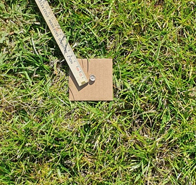

I had intended to carry out systematic measurement flights with both GPS (Quectel LC29HEA compared to u-blox F9P) To do this, I had marked a spot on the airfield where I would arm the system, so the homepoint is located just at this spot.
b1
After a few waypoints the copter should land at this spot by RTL. For each flight, I wanted to note wind, distance to landing point measured by a folding rule and measured by GPS.
After 5 to 10 flights with each gps i was hoping for reliable comparison data.
