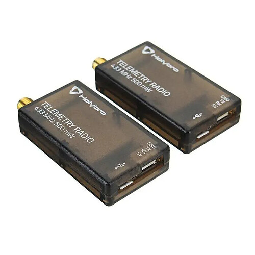

What radio? It isn’t pictured as far as I can see there.
Radiomaster 16 channel
And you are connecting to Mission Planner through it?
Yes holybro 433 mhz radio
Ok, that’s a new piece of hardware…
Again, please be specific or it becomes EXTREMELY difficult to help!
Do you mean this?
Yes same ones I also have the 900 mhz version

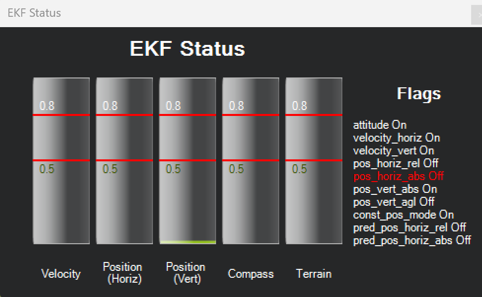

Once I put their parameters in I get the EKF VARIANCE so that’s why I am thinking Ardusimple, but I really don’t know enough about the subject to make a qualified decision
I think that’s the EK3_SRC1_YAW parameter referencing GPS yaw, which is unavailable. Set it to 1 so long as you’re using compasses.
It looks like they are trying to get you to configure the +Heading board, which we now know you don’t have.
Is EKF Variance related to the compasses or GPS or maybe both?
It’s because you forced the EKF to use a source that does not exist.
Does this image with red text mean anything?
