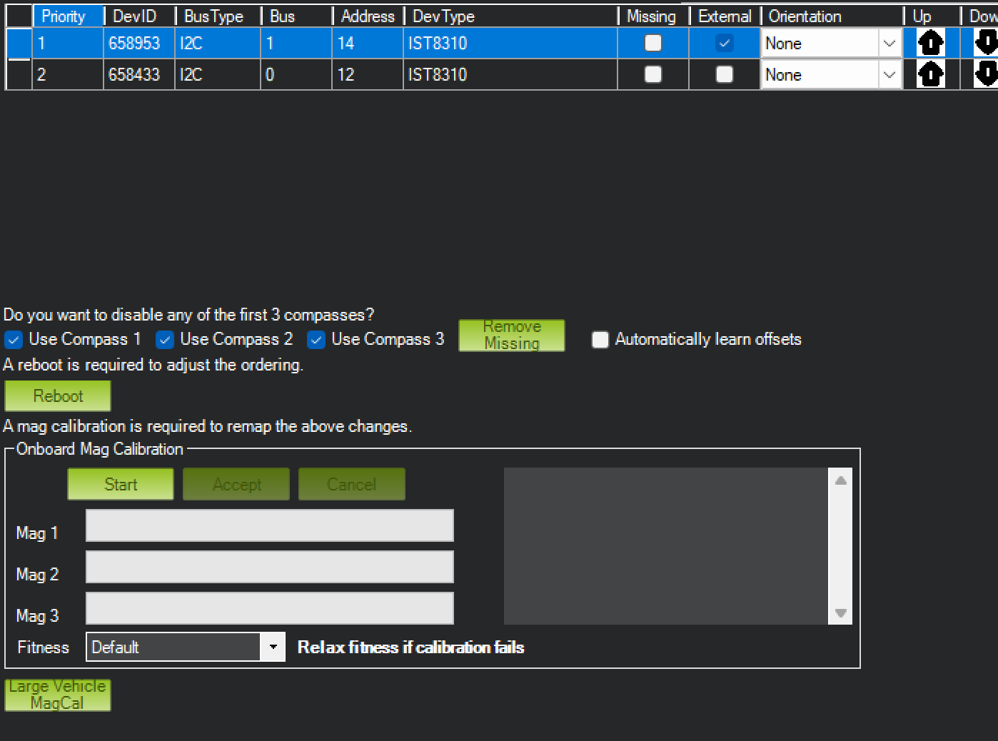

can you show what compass modules are detected on the compass page?
What hardware would you recommend?
you only want to be using compass 1.
Yes i only check 1 box i just reloaded thats why you see 3

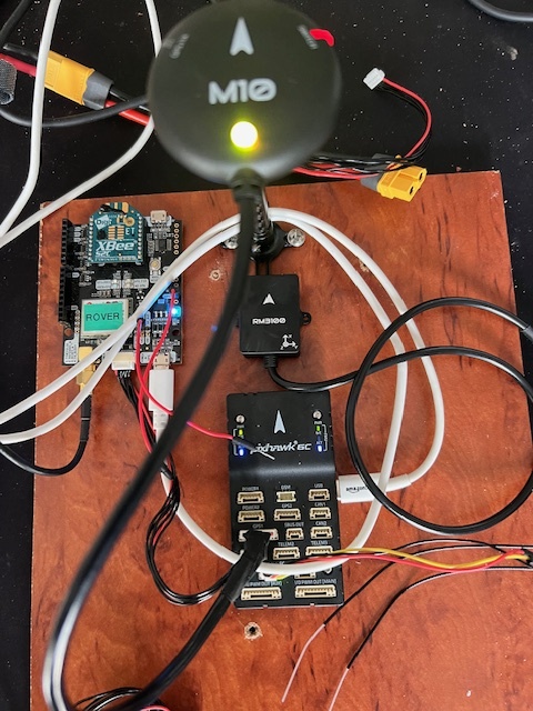

Take a picture of the hardware you’re using. I think that will help set us on a path to success.
We are still miscommunicating a bit - there was mention of the +Heading kit in your last post.
Got it. What you have:
Holybro Pixhawk 6C
Holybro DroneCAN RM3100
Holybro M10 GNSS module (that contains an external compass and u-Blox M10 GPS)
ArduSimple SimpleRTK2B
XBee radio for RTCM3 from a fixed base
What I recommend:
Disable the internal compass no matter what.
Discontinue use of the M10 module.
Source a second ArduSimple SimpleRTK2B for use in a moving baseline config.
Optionally discontinue use of the RM3100.
Alternately:
Discontinue use of the M10 - it’s only adding complexity and not likely adding value, especially the way you’ve been struggling.
Calibrate the RM3100 properly.
