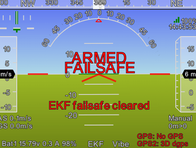

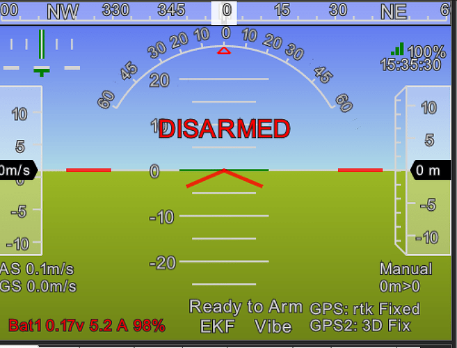

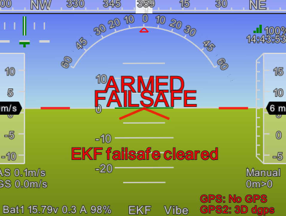

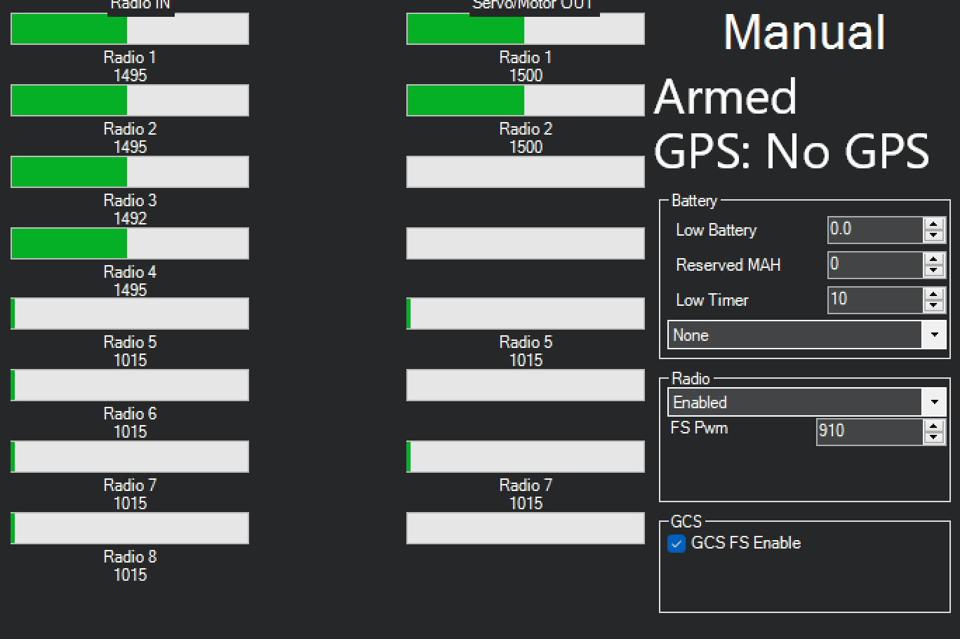

EKF VARIANCE this happens when I config the RTK as per rtk instruction and it does work I get a solid RTK FIX. but when Armi
ng see pic

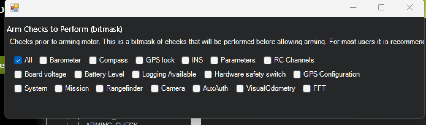

you still have prearm checks disabled.
I think they are enabled.
in the failsafe page it saying no GPS but on the HUD its RTK FIX I think its related to the GPS 1 is still being looked at by mission planner
go to all parameters and set ARMING_CHECK:=1.

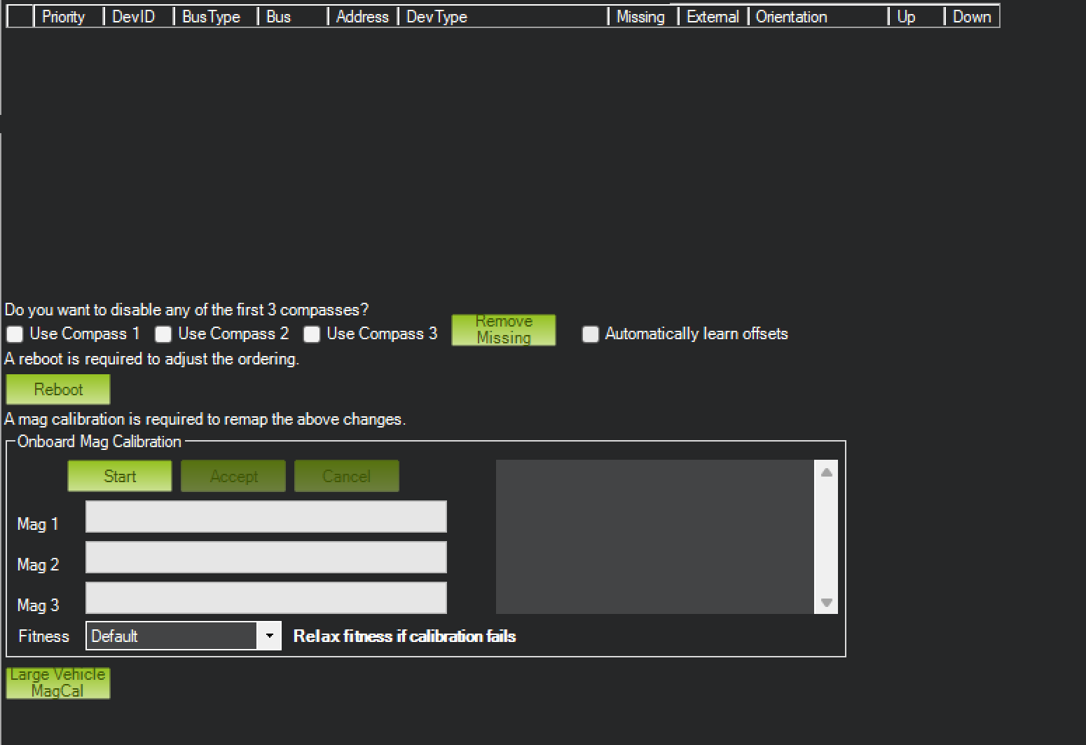

can you post a screenshot of the compass page of mission planner? It should list all the compass modules connected to the flight controller.
This is odd haven’t seen empty before
reconnect, its just not loaded parameters.
reboot and reconnect,still blank
No GPS in RED
do you have any external compass modules currently connected to it?
Yes the M10. never seen empty compasses before might set config to defaults
Reset defaults Two compasses showing
