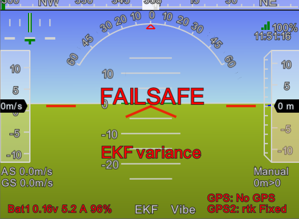

However I cant try it because I am getting
FLIGHT MODE CHANGE FAILED.
EKF VARIANCE.
I recalibrated the compass and accelerometers but same warnings.
Any thoughts?

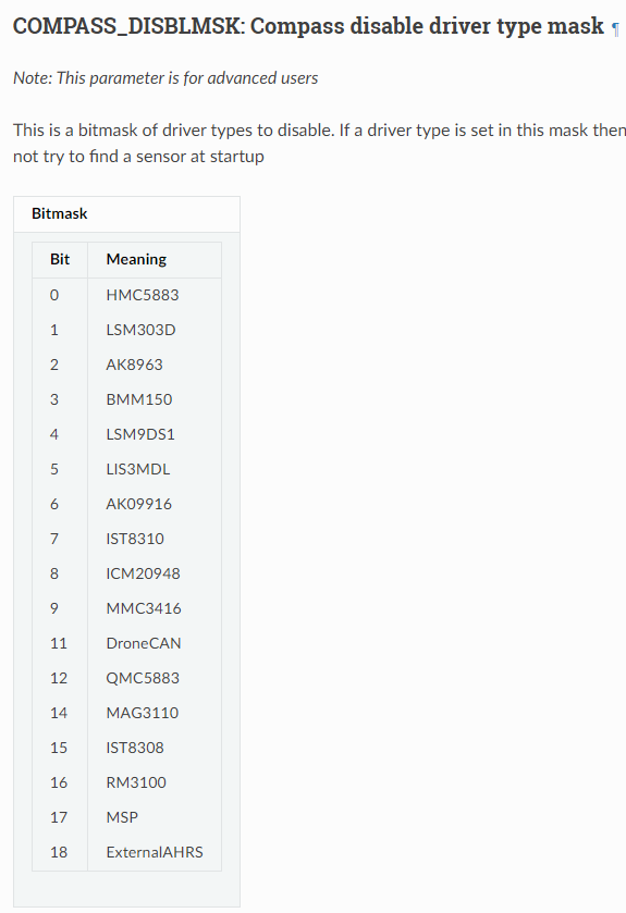

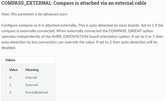

You should plug it in the I2C. If that is already taken, you can buy a I2C splitter module (https://www.flyingtech.co.uk/product/i2c-splitter-module-for-pixhawk-apm-flight-controller/). If you use MP, it should recognize it in the compass section. You have to tic it of in the compass section:
I am using a pixhawk 6C, but it also worked on my orange plus, black cube etc.
This is also an important parameter:
And this one:
Make sure it is not ticked off.

It is only for I2C port not CAN. Maybe you can try to enable compass 1 as external and compass 2 as external and compass 3 external. If only one compass is enabled it will only find the internal one.

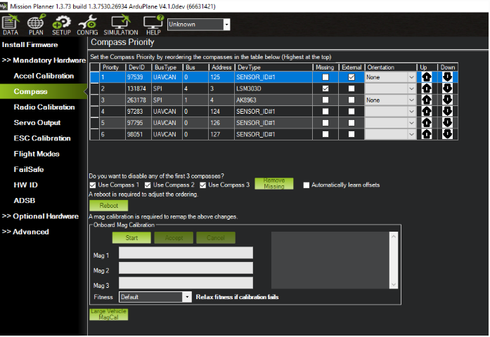

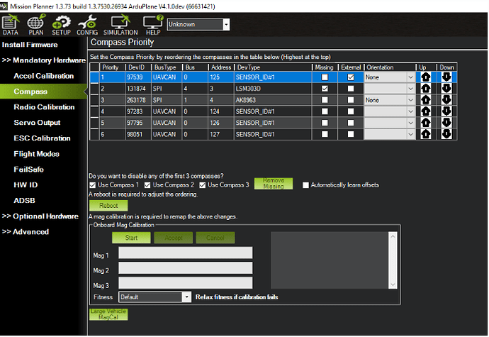

He says its a can based type 4 pin plug, but it doesn’t work, I feel sure it a configuration issue, but my best guess.
I have made progress but I am constantly getting flight mode change failed and EKF variance. Been reading a lot about it but no solution so far. If I can cure those two items I think I can get it to work with the exiting M10 compass for now and wait to see what the support guy says.
Many Thanks.
Screenshot 2024-08-31 152452

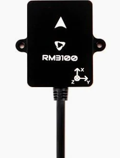

Again, incomplete information, but fortunately I recognize the logo in the picture. What you have is a Holybro DroneCAN RM3100 module.
The connector is a 4 pin JST-GH connector that fits any number of ports on modern autopilots including I2C, CAN, SPI, and various others that need a 4 pin connection. You can’t just plug it into any old port with 4 pins and expect results. In this case, CAN is correct.
Plug it into the port labeled CAN1.
Set:
CAN_D1_DRIVER: 1
CAN_P1_DRIVER: 1
Leave the rest of the CAN parameters at defaults. Reboot, and hopefully you see something new in the compass setup page.

If there are two COM ports associated with your autopilot, try the other one.
All ok now compass shows you made my day thank you so much!

I am still suffering with Flight Mode Change Failed I have a RTK GPS FIX
happens when switching to auto or rtl
I get an error EKF Variance. I have had this issue on Pixhawk 1 Pixhawk 4 and now on Pixhawk 6c. Tried with 3 different compass/gps
How do I determine what is the cause?
Can I disable EKF Variance?
